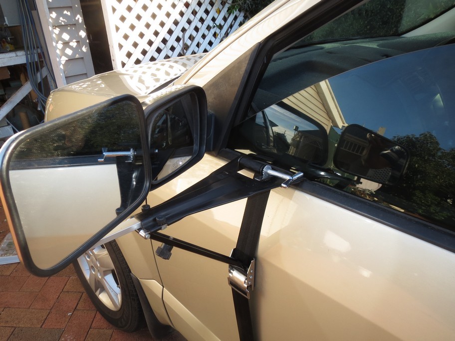

Can any GN please tell me if the ratchet type mirrors are any good - the cheapies I have now attach to the standard mirror and are a waste of time so I'm wondering if I should get some of the ratchet style.
Also is it best with a flat mirror or a convex one....I'm used to flat ones but open to comments. I'd love Clearview but cannot justify the expense.

We have been using a genuine set of "aussie truck mirror's" for more than 10 years now and they are still the best mirrors I have used. Flat mirror gives a truer image of what you see and to me anyway allows me to judge better the closeness of what I am seeing.
I do intend to get some magnetic sheet cut to protect the doors though. On our new tug we have noticed the straps are scuffing the paint a bit.
hope that helps
frank

Have to agree with what has been said, used them for years.
One big improvement is to make up a little 90deg bracket, a bit of 25mmx25mm angle & about 20mm long ,drill a couple of holes & attach it to the mirror fittment hole in the adjustable arm & then re-attach the mirror in a vertical position verses horizontal.
This gives a far better vision as in depth of vision & distance back down the road. I done this & then seen a few others done as well, all agree that this is better. Also dont have to set them as wide for a good vision; Very little effort for a far better outcome.

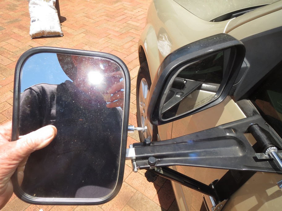

G'Day JC....had a look at modifying as per above but I don't think I can do it on my type - they would stick out too far. I could add some more angle pieces but it could end up looking like a Heath Robinson affair. However I am open to suggestions.....
FYI, I have the mirrors primarily positioned so the I can see the tyres on the van. Should anything untoward happen to one of the van's tyres (puncture) I would like to spot it before it gets me in trouble.

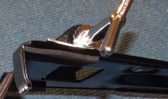

I have a pair of those ratchet style mirrors and have found that the ratchet gear is made from a very soft alloy that tends towear down so that the spring clips don't seem to hold very well. Also the spring clip or pawl works a bit better if the end is bent slightly to engage the ratched tooth better. To be honest I'm not so happy with mine and am looking for something a bit better made that doesn't cost the earth like the clearviews do. I mean $700 for a pair of rear view mirrors is outlandish......

I just had a look at their website and they supply the head only, so not much point on the original brackets.
This is the part that fails, the soft teeth on the ratchet cog wear down,
I noticed that there were bit of metal filings alongside the ratchet cog as well so now I hold the spring down while I tension the belt and release the spring just at the final moment. Inconvenient I know but no real option is there unless you want to spend $700.
You probably could also recut the teeth with a file but you certainly would expect better quality.
