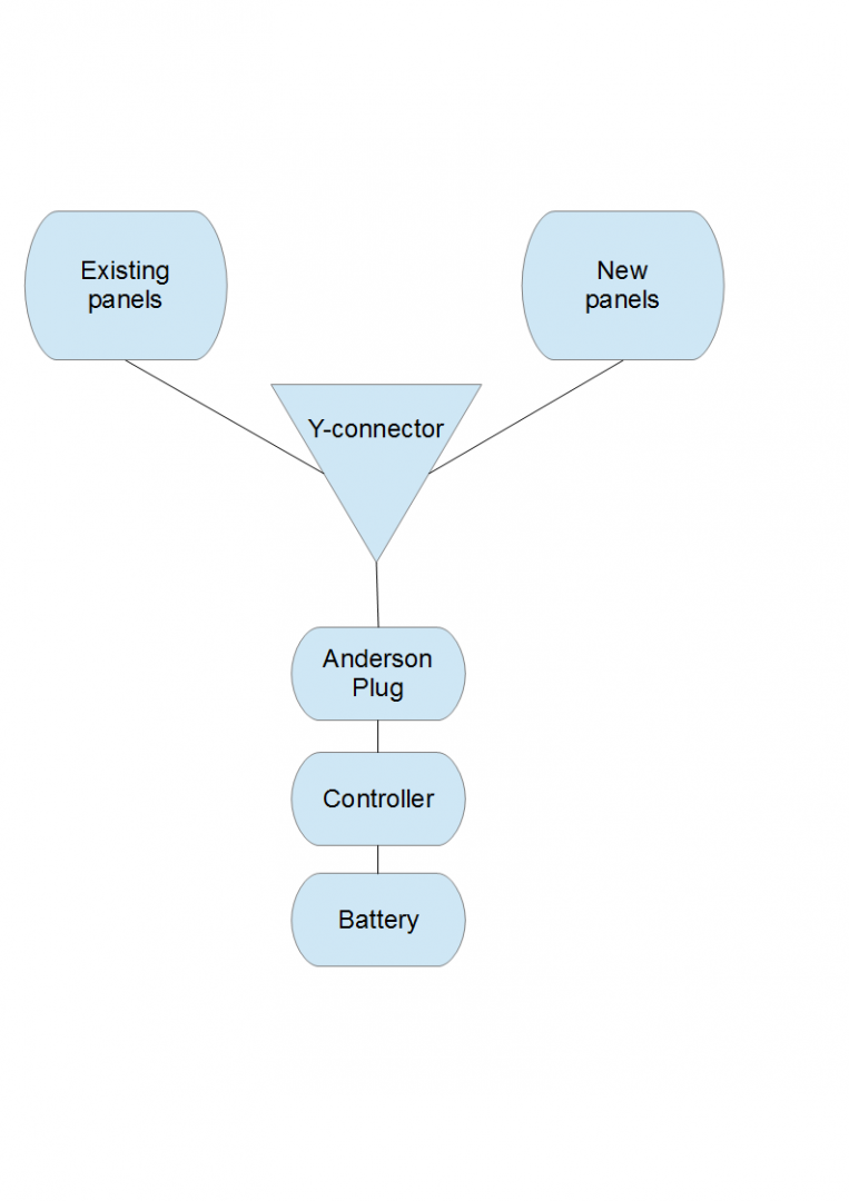

Here's a schematic of how I would do your setup. It's basically what mine already is:
--- Existing panels
Battery --- Controller --- Plug --- Y or T adapter plug
--- New panels
This would involve removing the controller from the back of your panels and mounting it as close as possible to the battery, and having appropriate plugs fitted to the panel leads. As Brian explained, you'll have to run all your panels through a single controller, and it's going to be a lot easier and more robust to manage that if you move the controller to the battery rather than try to connect two folding panels together. When I bought my folding panels the controller was mounted behind the panels, but I recently moved it to the battery for its own protection, to make the wiring more robust, and to have flexibility in what panels I connect. My battery voltages have been higher since I moved the controller.
With this arrangement you could put just a single panel set out on sunny days, or both sets when conditions aren't so good. I too have two independent portable panels and only get them both out when I have to. I have short leads on the panels terminating in MC4 connectors, and MC4-Anderson leads from there to the Anderson plug on my battery. I also have a 10m Anderson-Anderson extension cable that I use when the sunshine is otherwise out of reach.
I would tell the family not to bother with gifting a controller, or I'd keep it as a spare presuming it can handle the load of both sets of panels.

moblet said
09:30 AM Dec 20, 2013
Poppy sore eye wrote:
Ok guys, I thought it was sorted, does all this extra stuff mean that JC,s simple first solution won't work????
JC's solution won't work only because you can't connect two controllers to one battery. The idea of keeping the two panels independent and joining them at your Anderson plug will work, but a controller needs to be installed between your battery and your Anderson plug(s), and your panels set up to connect to your Anderson(s).
I forgot to check whether my schematic would be lost in translation. An image version is attached and should appear here:
JC would install a second Anderson plug off the controller, whereas I would retain a single plug and use a Y-connector (google "Anderson double adapter" to see what I mean), but it'll work either way.

moblet said
08:24 AM Dec 21, 2013
Sorry JC, wasn't having a shot at you. Poppy had asked directly whether your initial off-the-cuff solution was a goer and no one seemed to be answering.
justcruisin01 wrote:
The only difference with this system is you are asking him to spend $30+ on three anderson plugs with a length of cable.
My suggestion was one plug & 150mm of cable; exactly the same result.
Hard wiring the double adapter at the rig is definitely cheaper if you can do it yourself or aren't being overcharged for labour, but in my case, even if it cost nothing it would make the total system more expensive. At some places I need to use an extension cable to reach the sunshine (a 10m Anderson-Anderson which cost me $50+ off eBay). If I have two panel sets and can put my double adapter wherever I like, then I only need one extension cable. If my double adapter is hard wired at the rig, then I need two extension cables.

--- Existing panels
--- New panels
