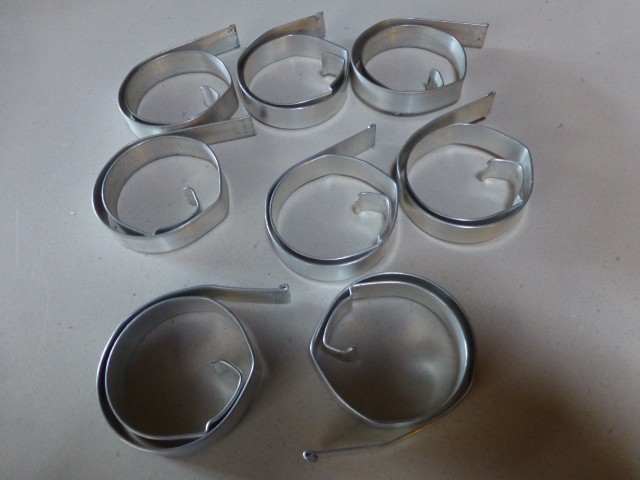

I made a set of spiral rings out of 25mm x 3mm Aluminum strip.
I simply wind them onto the awning flap along its length which forms it into a gutter to catch the rain water and funnel it to one end for collection.
At the end, I hang a collapsible bucket with a hose attached to the bottom, the hose goes to the water tank.

These are the rings. Can't show them in place at present as I would need the awning rolled out, but I have been using them successfully for around 10 years.
Simply, they basically roll onto the flap. The hemmed edge of the flap locks into the small kink that you can see near the inside end of the ring, the straight bit on the outside sits up behind the rolled flap and against the roller to hold the ring in an upright position.

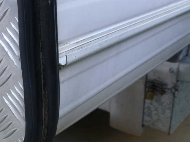

The second photo is of the channel on the back of the van.
