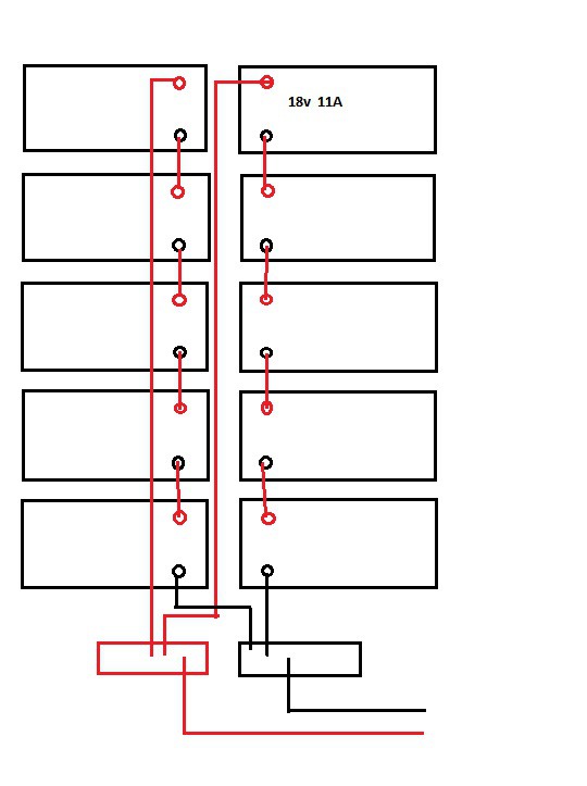

Not that technical, but it looks like it might melt down or explode as you seem to have both parallel and series in a weird configuration. But I'm probably wrong, I'd connect all the positives together and all the negatives, then you'd get 18v and 110 amps, a 20 amp reg may melt.
valiant81 said
04:15 PM Dec 16, 2013
Hi;
In this configuration, you would have 90 odd Volts ( 5x 18 Volts ) and the current would be 22 Amps ( 2 strings of 11 Amps each string ).
I sincerely hope that you are not contemplating something like this for your RV.
First concern is that the open circuit voltage of that array is no longer in the safe ELV range but getting very close to the more dangerous LV range of voltages. It will give you a nasty bite if you are not very wary.
Second concern is the sheer amount of real estate that you would require.
Third concern is the shading factor that can easily lose a large proportion of your input.
Voc will be about 110v
Vmp will be 90v
Imp will be 22 amps
A good 20a regulator would handle it as it will have a self limiting function, but you would need to ensure that it could handle that Voc.

Ok I'm going to post up a Picture and I want to see what result's everyone get's..
Ok Every Panel is the same.. 18v 11A..
The Panels are wired in 2 string's of 5 in Parallel-
The red and Black Block's are the connection point's..
From them out to the Solar regulator..
Ok the Question is What Final Output do you get.. and do you think it can be hooked up thru a 20A regulator.. if it can't explain..
[I know that at 11A per string the combined A's is higher than the Regulator]
What Voltage do you get..??
What Amp's Do you get..??
Juergen
Hi;
- I was wondering about the Voltage.. as I'm contemplating the dingo 20 as the regulator..
Juergen.
