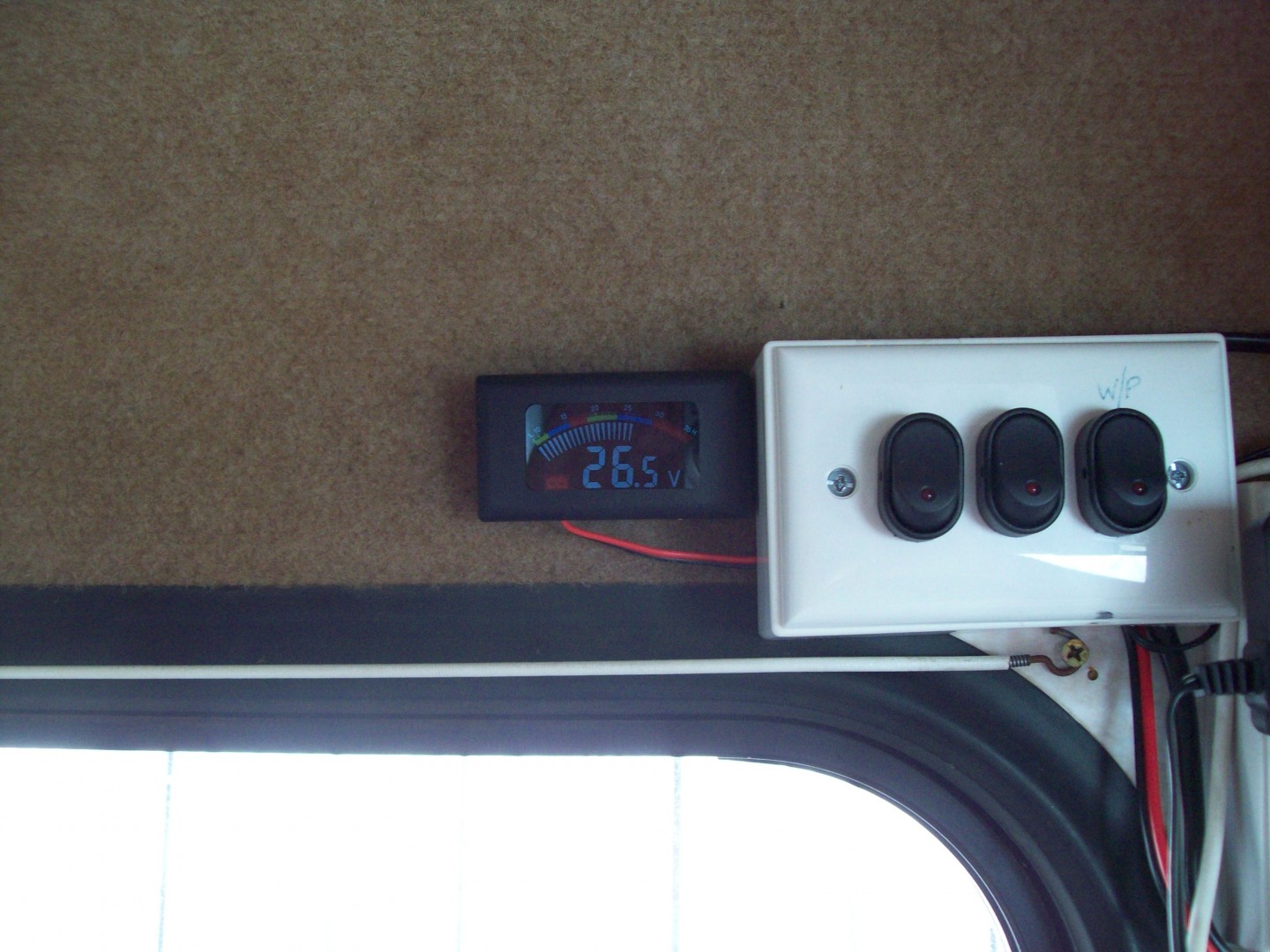

I'm like Brian measuring amps isn't as easy as just connecting a meter across the terminals... This is my volts meter inside the bus where I can check on it anytime without going outside to the boot where all the electrics are, particularly in bad weather.
With a lead acid battery a volt meter can give you a good guide to your state of charge, but an ammeter does not do much for you, yes if fitted correctly it can give you a guide as to what is happening now, so it may satisfy a curiosity about is my solar panel working, or how much current does a particular device draw. BUT it does nothing to help you understand how much power is in your battery.
Apologies if I am preaching to the choir, but people often appear to become confused around amps and amp hours.
