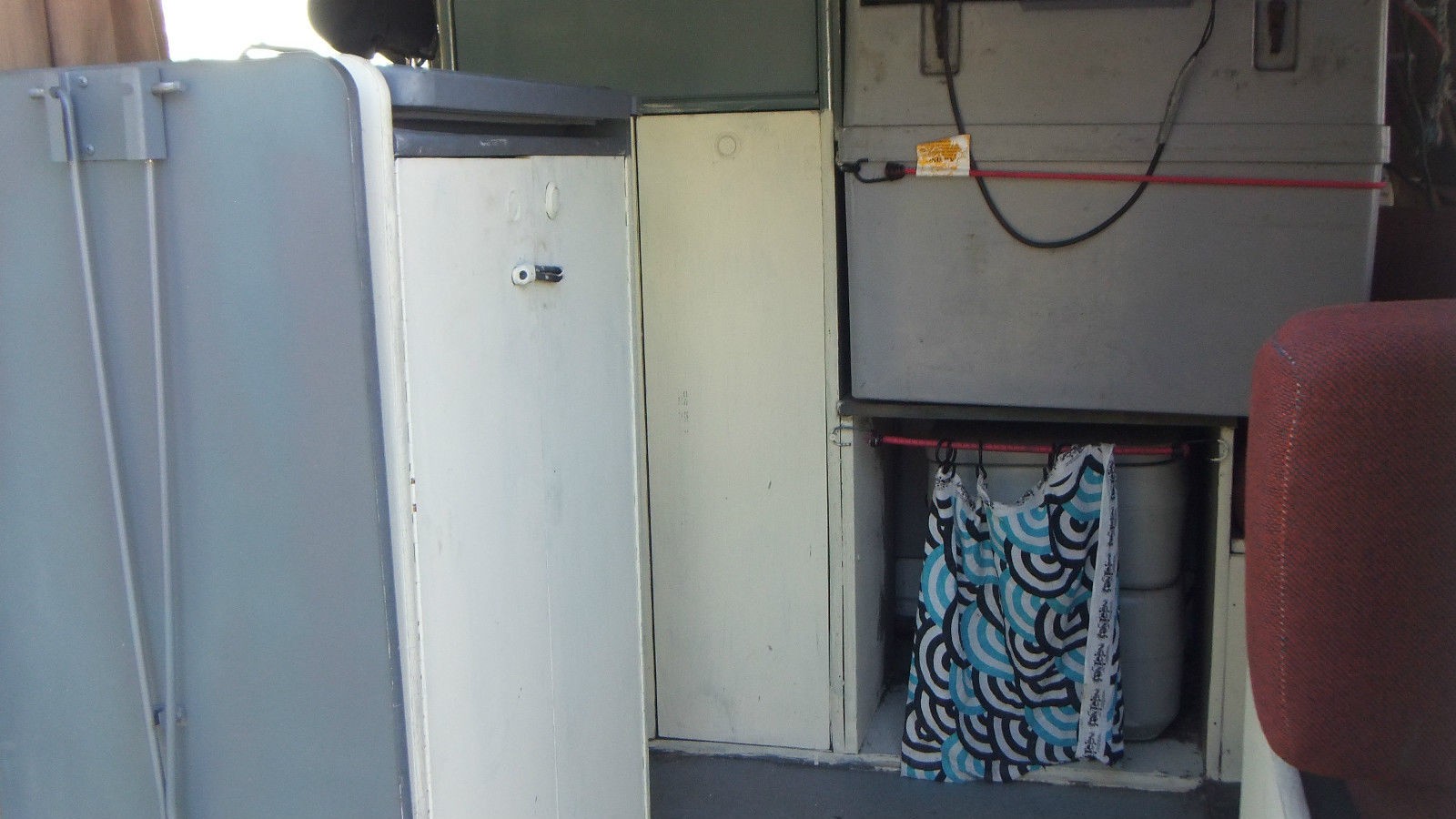

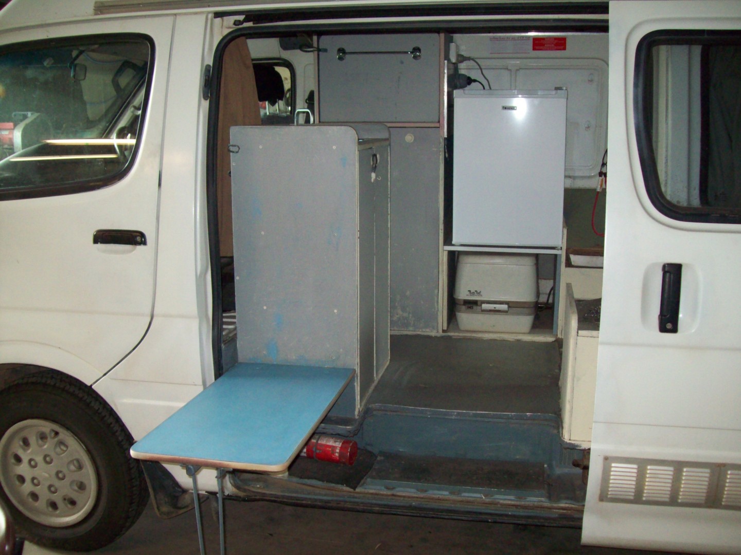

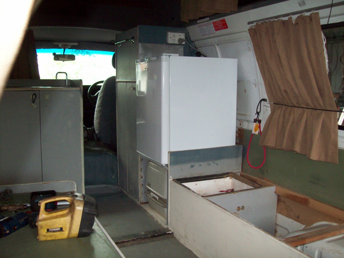

Here is a couple of progress pix showing before and after..
just out of curiosity did you change the way the transformer connected to the fridge
