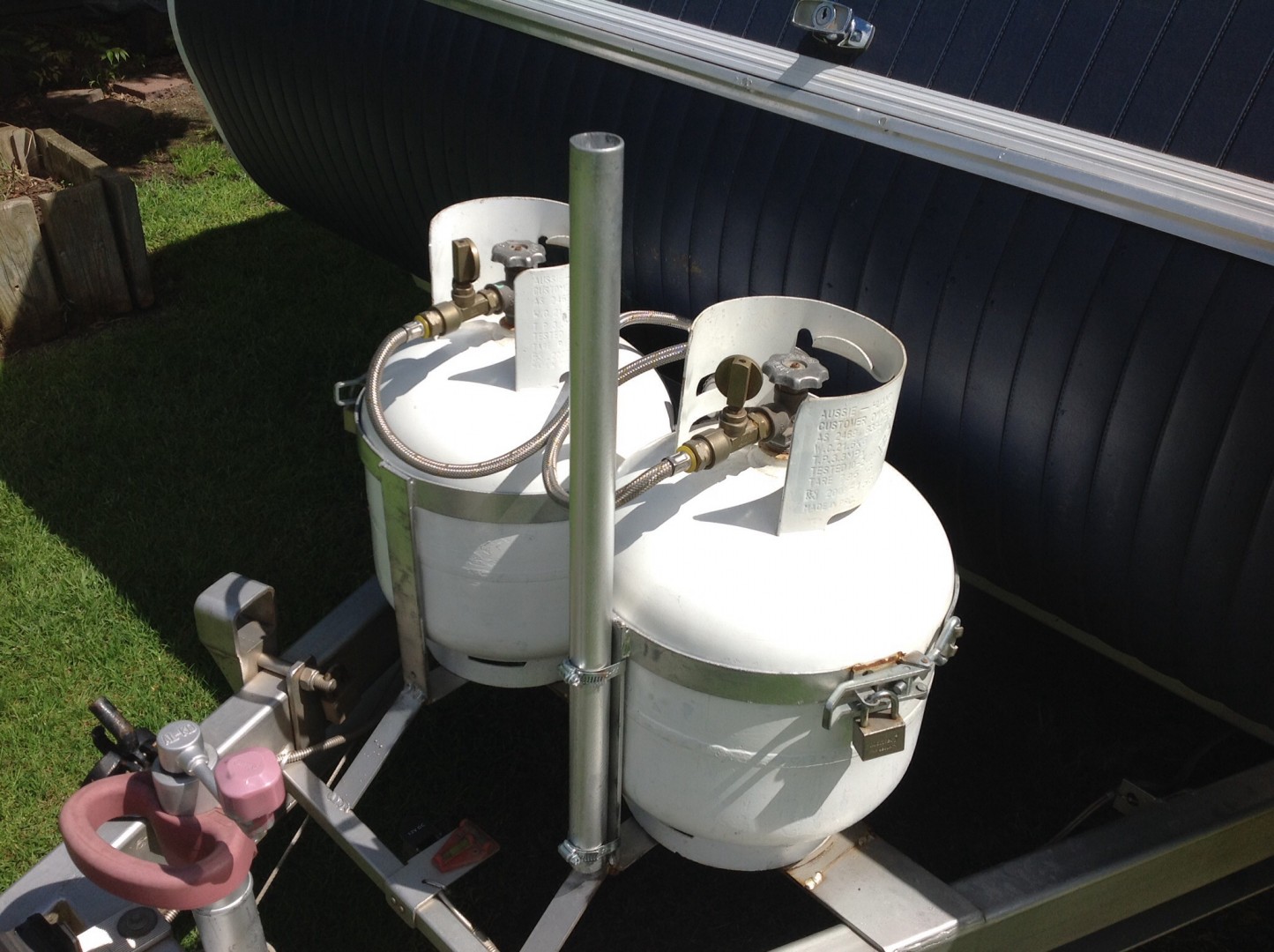

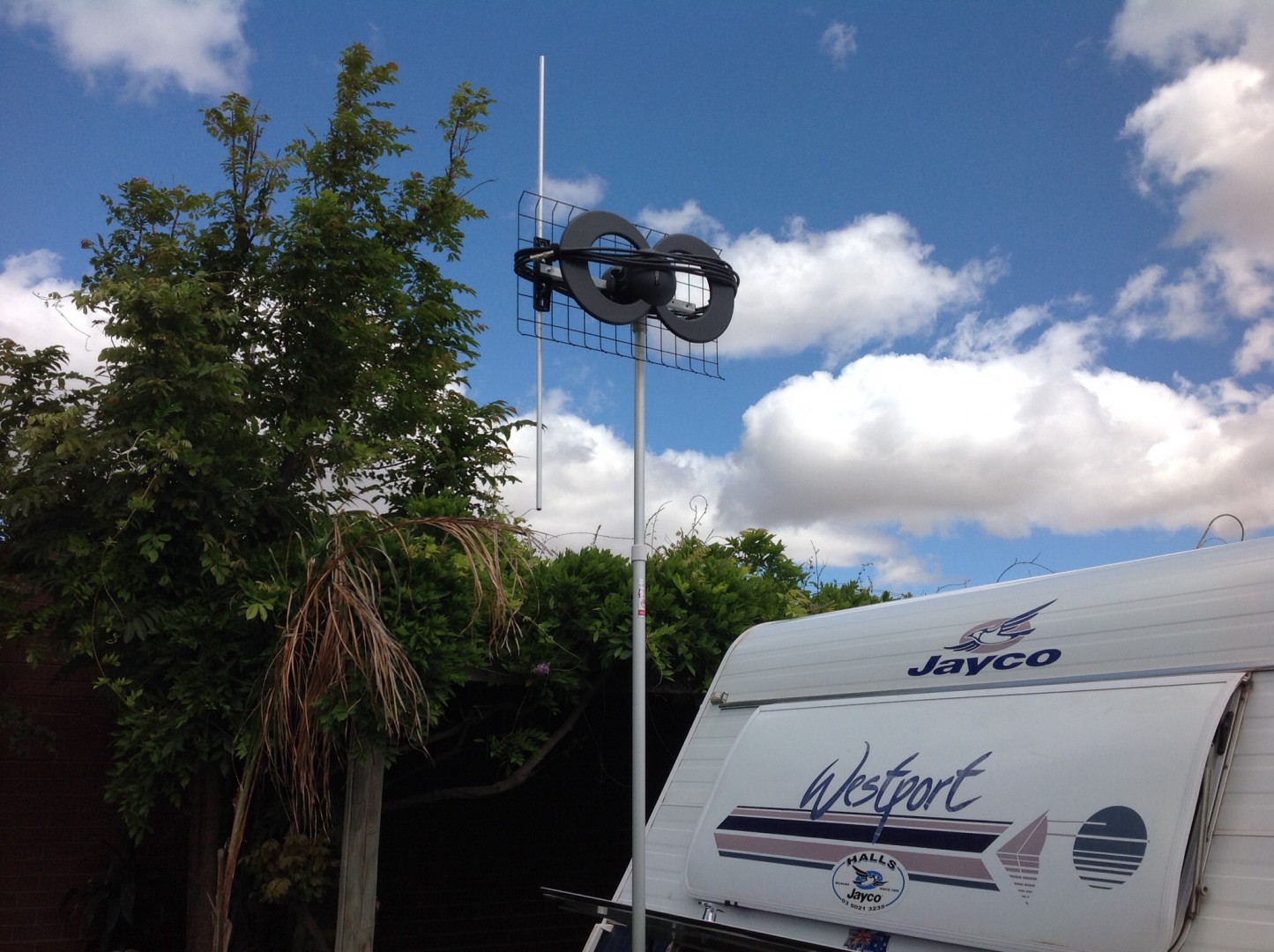

Hi Sarge you can bye an aluminium extension pole from some caravan dealers, or go to Bunnings and bye an extension paint roller handle, wich is aluminium also, I put two pics here to show you how I mounted my antenna pole,my pole is from a caravan dealer,hope this helps.

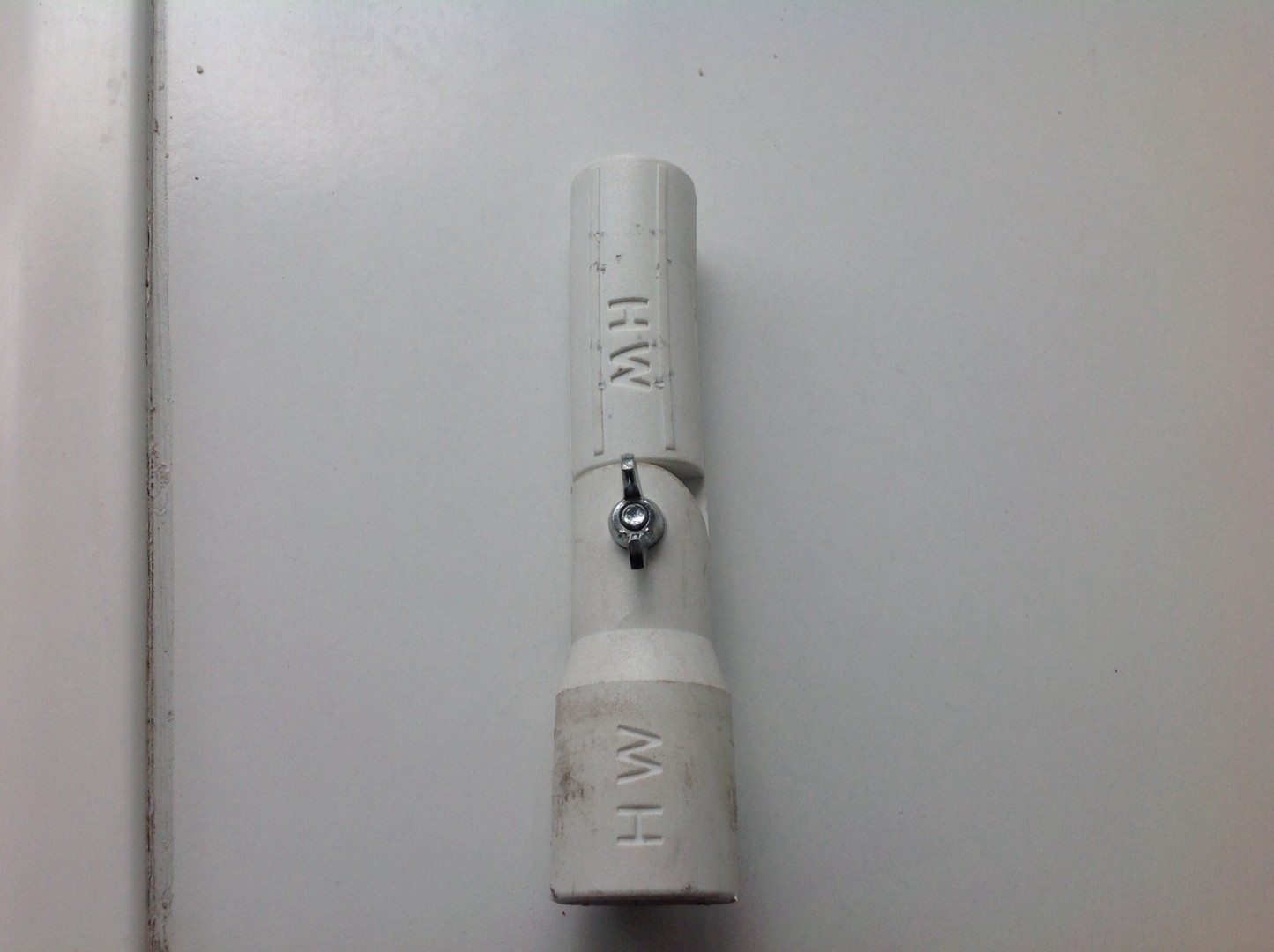

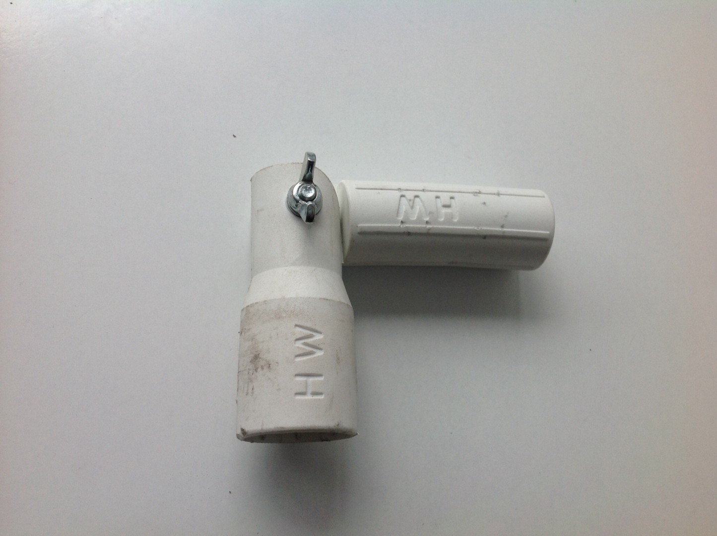

Another handy item available at the dealer that have the extension pole is this bracket that you mount your antenna onto the pole with,just loosen the wing nut and turn at wright angle and you have your antenna vertical or horozontle,it is worth the money.
lance C
-- Edited by Olley46 on Friday 6th of December 2013 11:52:06 AM
lance C
