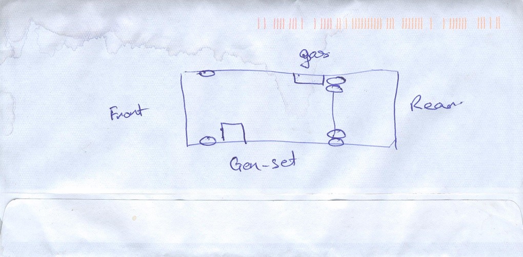

I like mud map's to look at an issue..
All the weight's removed came with in the foot print of the Bus..
the Question is HOW much weight is hanging behind the Rear wheel's..
in a lever/fulcrum situation the Gen-set balanced the weight at the rear of the Bus.. Is there any way that you can fix the in-balance of the weight sharing..

Juergen
I like mud maps and touching the bits as well, No mistakes in the translation then, hahahaha
The centre of the Gas tank is about the middle of the axles, Further forward than on your map,
The Gen set is in the right position, In your map,
Now, existing Batterys are in the Middle of the axles, Other side of Coach, Genny side,
They can go in the Genny Hole along with two more, They should fit, Just,
The Genny base and door came out with the Genny, So thats a bit of weight I dont have to find,
4 X Batterys, should just about be the same weight as the Genny, Approx, They are very big batterys, 400 Amp hours,
From the rear axle back, Approx, 6 ton, 11 ton gross O/A, about 9 ton Gross at the moment, with all stuff the removed, and empty tanks,
I personally don't know what you have to the rear of the bus.. if the front is bounce that is the issue..

Juergen
