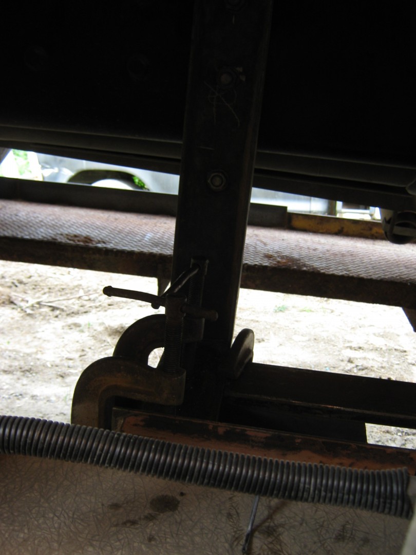

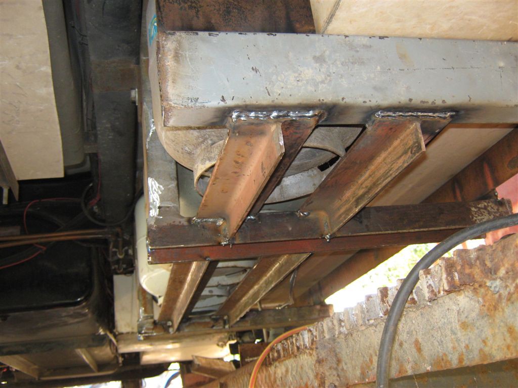

I can work under it with ease, So I will install a new gas tank holder under there,

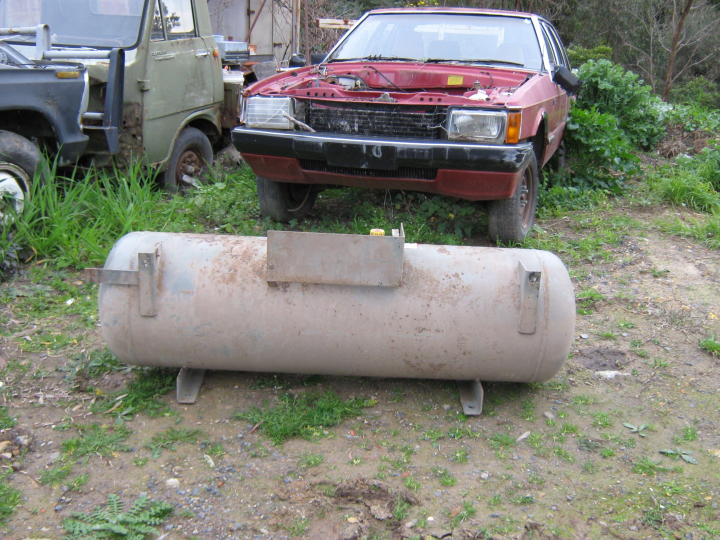

The Gas Tank that was in it is Illegal here, so out it came, and I will replace it with Swap and Go Bottles, 5 of them in a row,
The gas tank was 6 foot long and 18 inches in Diameter, 1800 X 450 mm Steel Tank, weighed over a ton and was 3/4 full of Propane,
With the Generator and the Gas tank out, The Coach looks like its ready to launch itself into the air, the front is up so high and its a bit bouncy when driving,
So I dont have a weight problem with the steel I am going to put in there and the Gas Tanks weight,
Once I get Solar on board, I wont need a Generator, But I may have to Carry it around, just to keep the front of the Coach down on a flat level, Its about 3/4 Ton, and stop it bouncing when being driven,

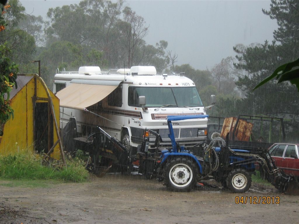

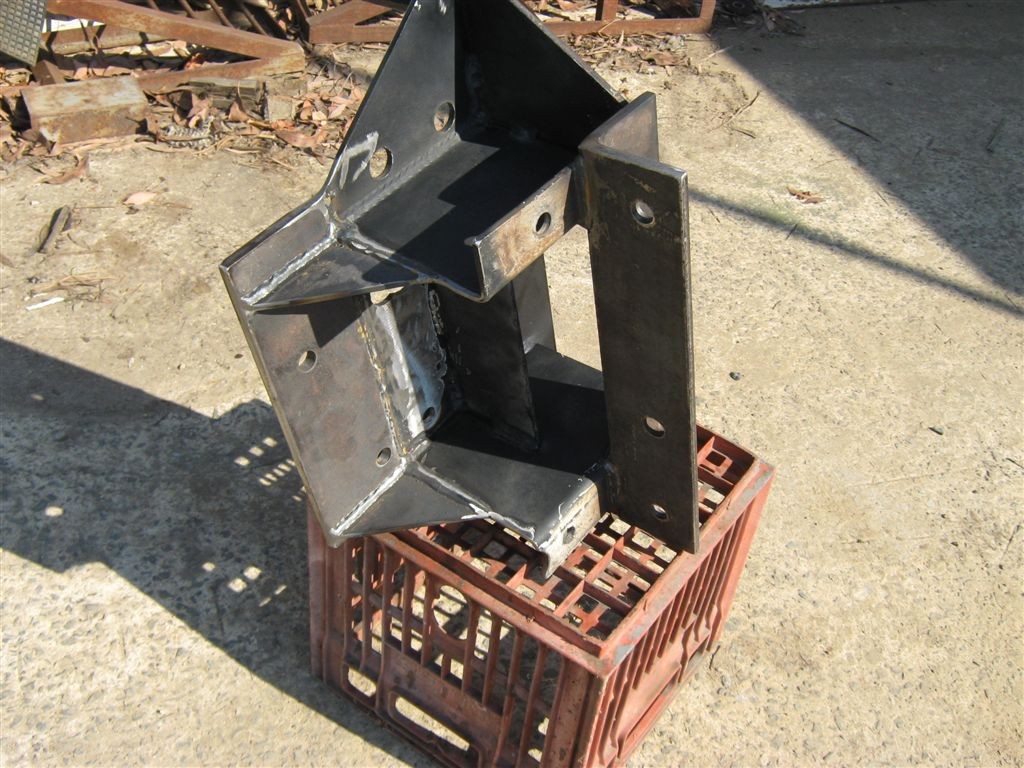

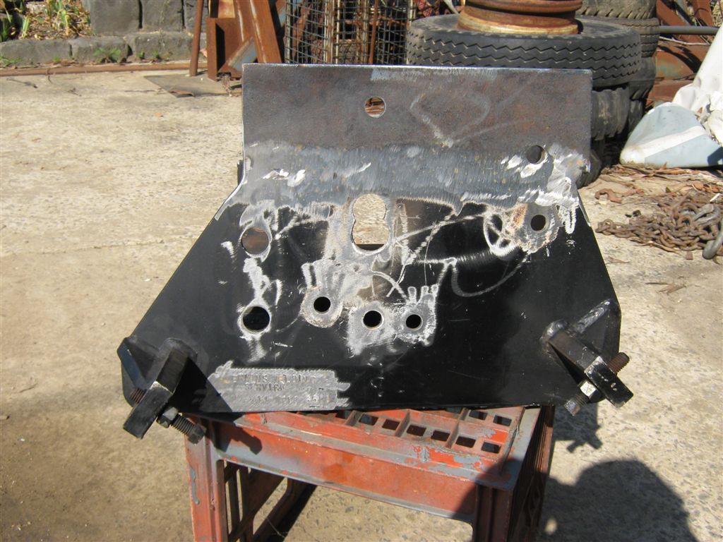

Its an ongoing thing, I will put Piccys up as I proceed, Its raining here today,
Thats the Gas Tank that came out of it,

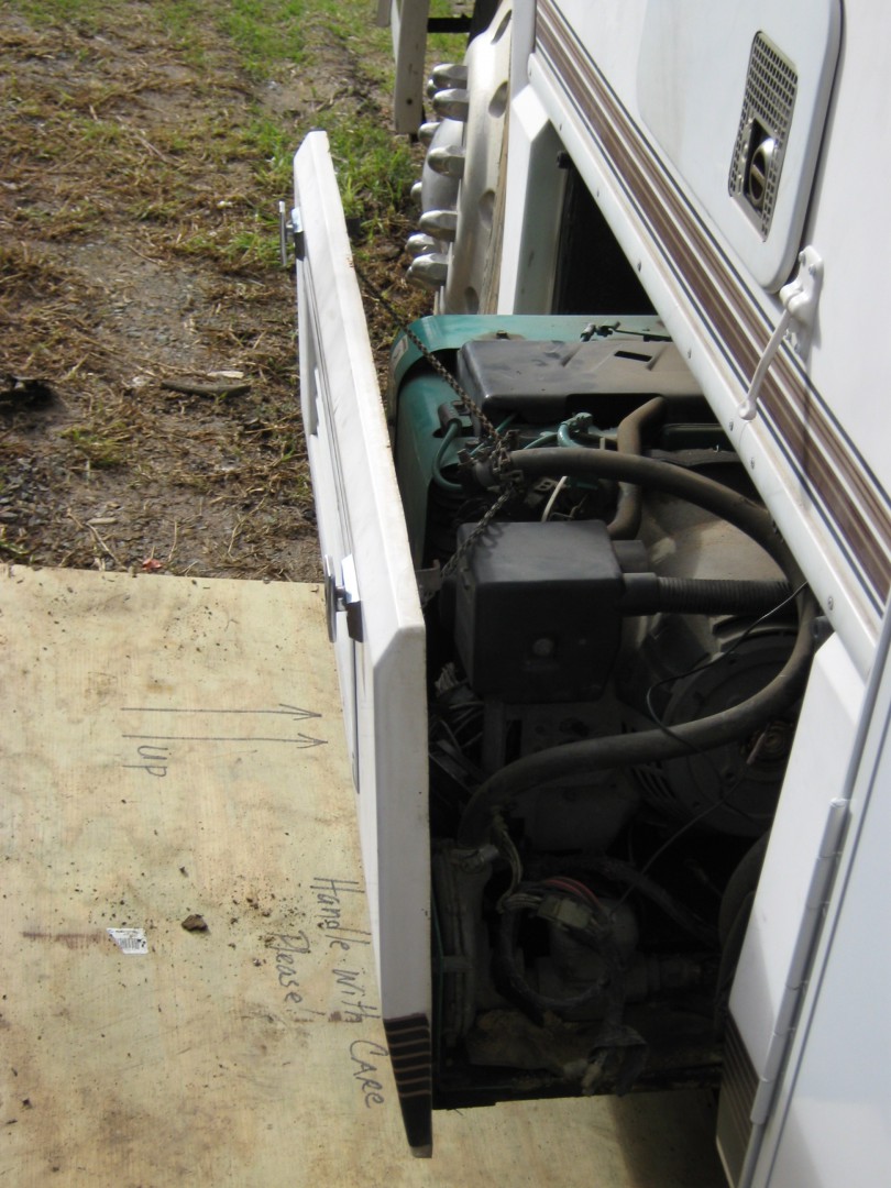

Thats the Generator that I have out of it at present, It slides half way out so it can be worked on,

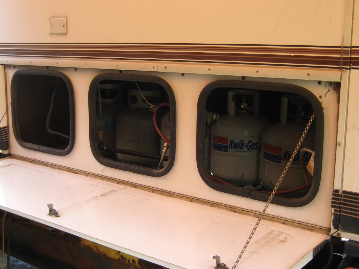

The Box I have under there will all be lined with 3 mm thick sheet steel, Fireproof,
Any explosion dumps straight onto the ground,
Escaping gas drops straight onto the road,
Its still no where near as heavy as the Tank I took out,
And six ton hanging out from the rear axle backwards, I need the weight in the front,

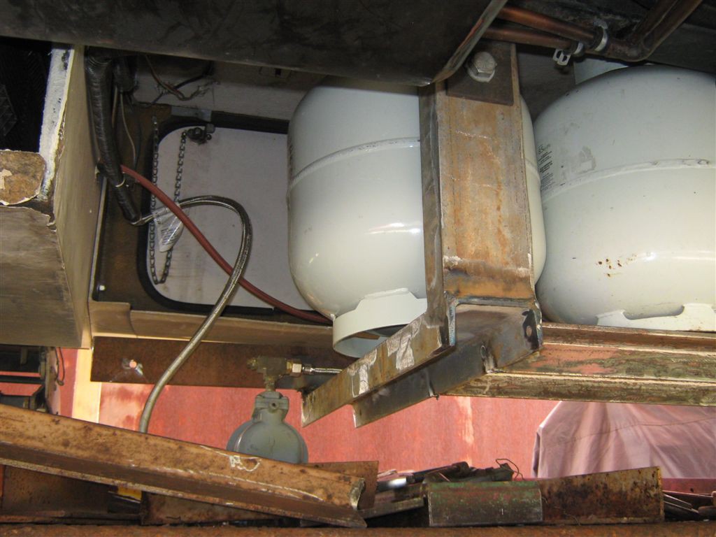

Are the gas bottles going to be 20lbs(9kg) or 75lb ones?I would recommend a gas fitter. In fact ,I think it would be illegal,and probably unsafe, not to have one.Do these go into the motor? How big is the genset? Sorry about all the questions, but I am an engineer. Thanks, Bill
5 X 9 Kgs bottles, I am only putting in the carrier, Gas fitter pipes it off, and certifies it,

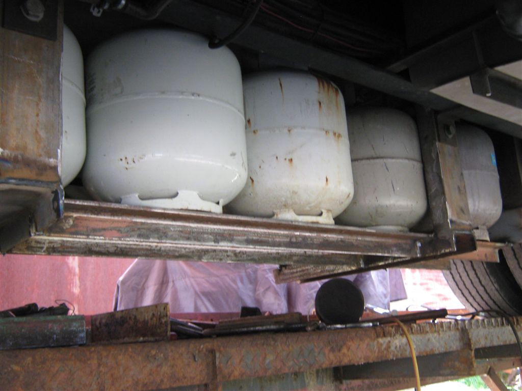

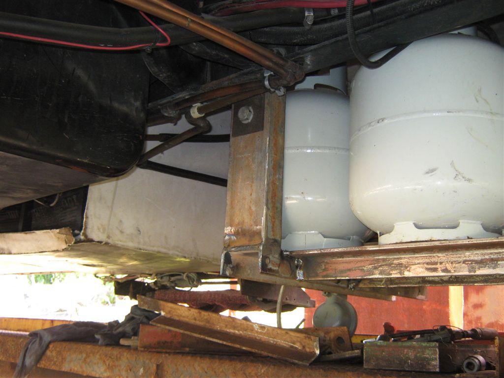

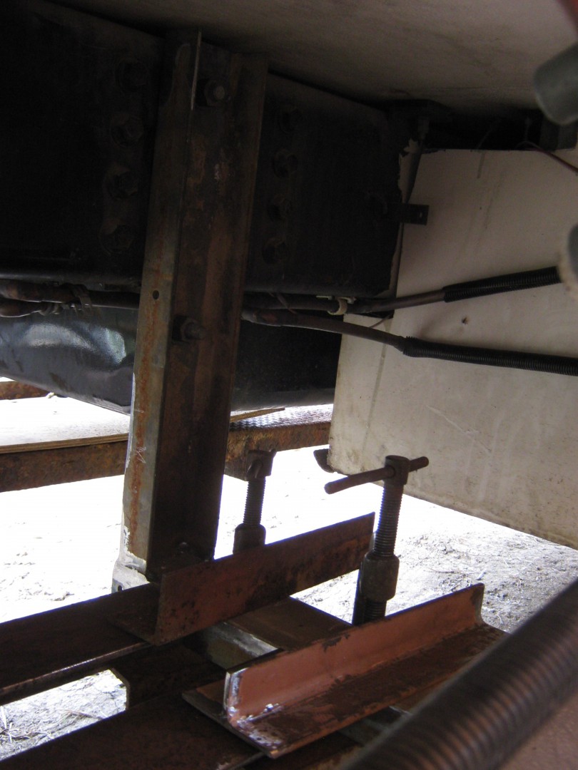

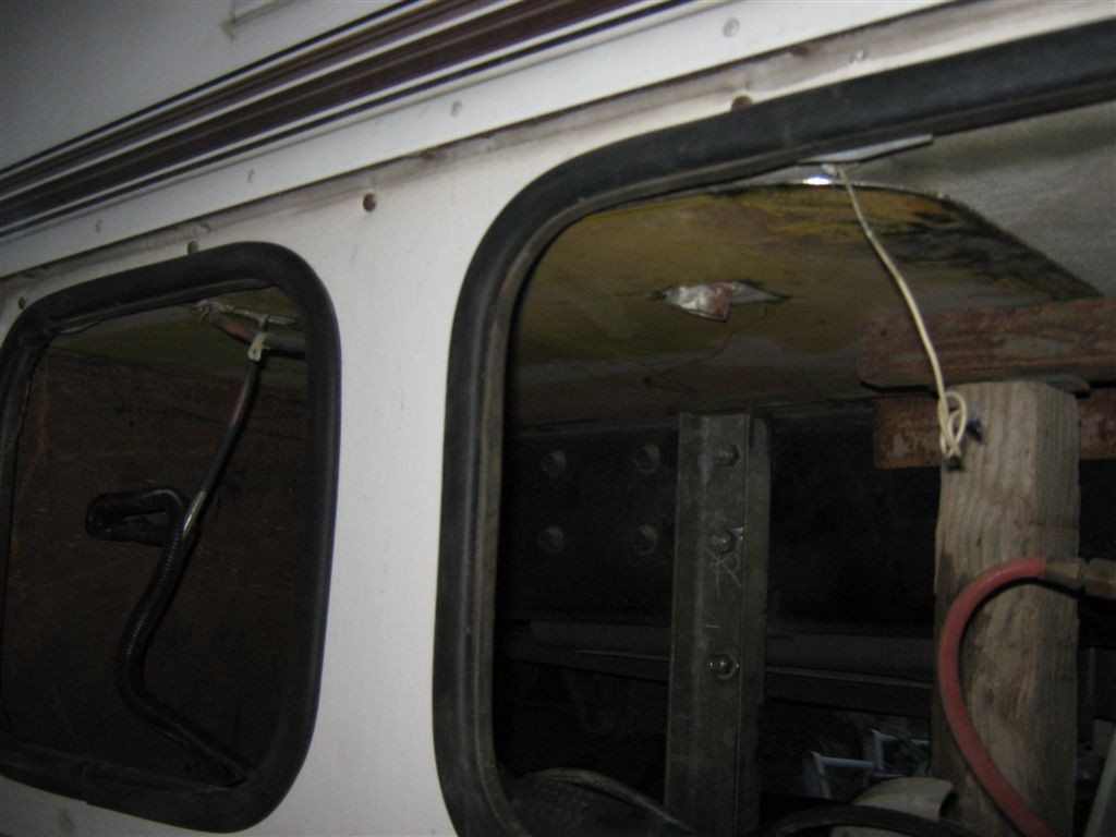

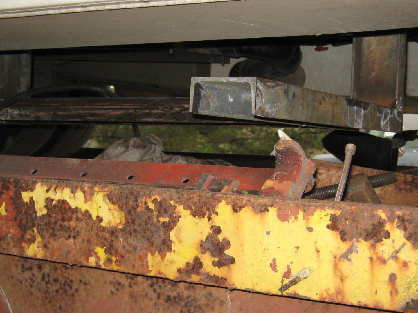

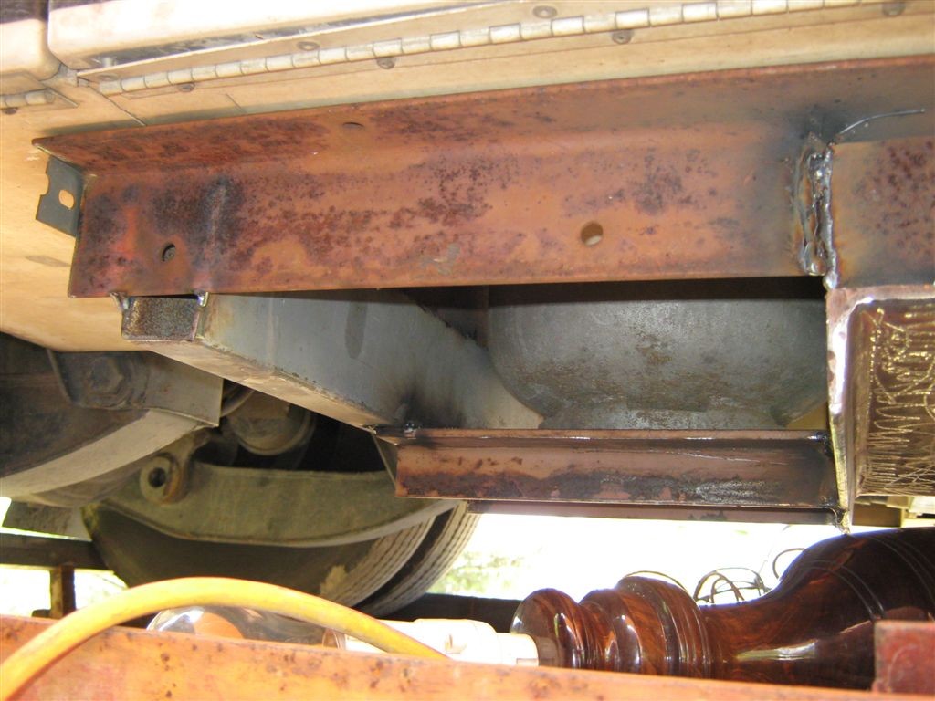

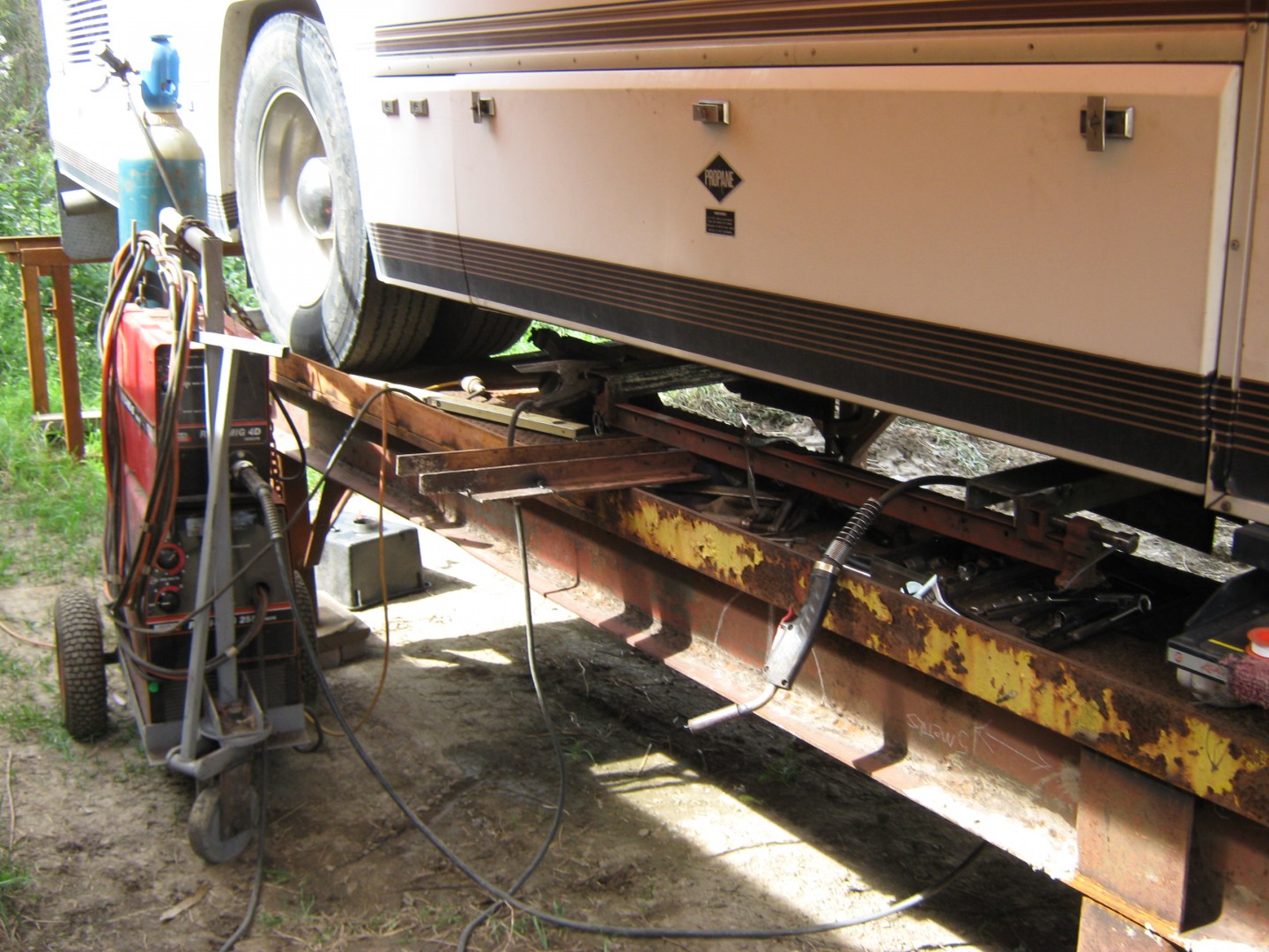

Here you go, A few more piccys of the gas tanks in position,
It will be all lined with 3 mm sheet steel,
I am trying to load it with as much weight as possible, with out being Rediculous, as with the big tank and gas out, I have a chronic weight shortage,
I had to cut the roof sheet in two to get it in, But it over laps, and a few zaps with the welder, Its permanent,
It was bit squeezy getting it past the gas pipes with out damage,

Upfront - I have no techie skills, little knowledge of gas stuff and even less about 'tricity but I am intrigued with this set-up.
Given my 'un-informed' situation, how do the five 9Kg bottles feed into the system? Are they all feeding into the one pipe which then feeds to the appliances? If so, does that mean they all empty at the same, or very similar, rate?
How do you fill the bottles? I assume from the photos they have some 'common' fill point? or do you have to remove each one and fill separately?
Using one bottle at a time at present, Flexible hose connected to the system,
I dont like a solid bank with a solid pipe connection, If I can get flexible hoses to connect up with, I will run two bottles at a time only,
Depends on the laws involved, It has to be done right and Certified,
Change all bottles or one at a time, They are all easily accessible, Just have to pull it through the holes in the bay doors,
They are only a foot off the ground, when in the Coach, So its not a big deal regarding the weight of the full bottles,
The Girlie at Bunnings put the last full one in, She thought it was too heavy for an Old Timer like me, Hahahahahaha
Swap and Go, Gas Bottles, Buy them anywhere, Servo's, Hardware stores, Caravan Parks, Middle of the Never Never's, Back of Beyond, Etc Etc Etc, I can never run out of gas,
No matter where I am, or have to travel miles to get resupplied,
Once its all set up, I will never have to touch it again, other than change bottles,

The gas bottle retainers, I havent got that far yet, Possibly chain and and a lock lever,
It depends on where I put the upstands for the solid gas lines and Guages, Etc, Existing, They all need to be supported and fixed,
I want it all neat and tidy, Every thing easy to get at, All piping and electricals out of the way, So nothing can get damaged,
Vibrations and rattling, annoy the crap out of me, So I make sure it doesnt happen when I make some thing, Then its easy to track down other rattles and things that go bump in the night, Hahahaha

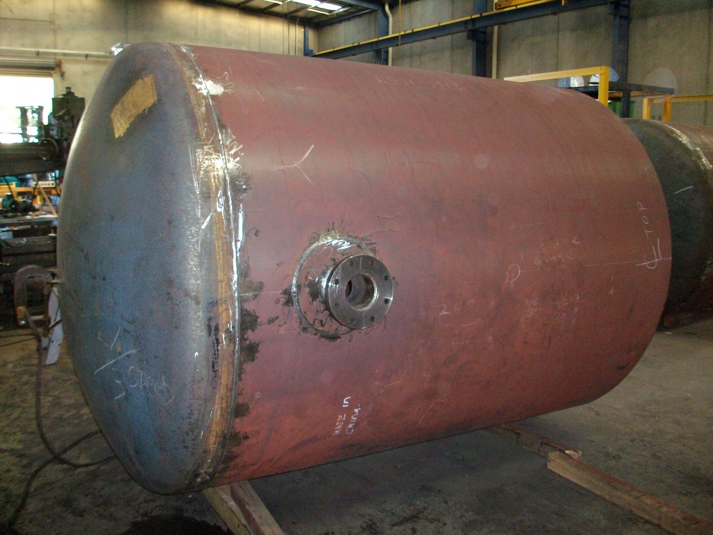

Did I mention that I did make Gas tanks, In all sizes,
This is one I was making, I rolled the Barrell and Welded it, Welded the end cap on, and a few Outlets,
Its all high pressure and 100% Welds, Thats what I did for a living, Gas, Steam, Fuels, Chemicals, Food,
I also set them up for testing under pressure for the Govt Inspector to approve them,
I am a Highly Skilled Individual with all my Govt Certifications, And Hazardous Certificates as well,
I also do cut and shuts on Truck and Mobile Crane Chassis's, Make them shorter or longer, All 100 % Guaranteed,
I also make the Cranes and the Booms too, And any repairs to them as well,
I am not your average Back Yarder, At least I have some idea on it, Hahahahahaha.

Well The Coach is up on the Ramps, Safely,
It is illegal to fit your own up, And I have made the Tanks, DLI Welder, I am also an Engineer, Practising,
I want to go all 12 volt and gas, Solar, Same as my Boats set up, I really dont need the Genset,
-- Edited by Mr B2 on Sunday 1st of December 2013 11:12:50 AM
Sort of With John here..
except..
1 - how many bottles at once shall you have connected at the one time....?
2 - How have you secured the Bottle's, so they don't move while your on the Road..
Other than that it Look's Like a Sweet Job..
Your smarter than you look, Hahahaha, Thats a Bloody Great Idea, Ta, I didnt think of that, A extra battery Bank in there, Just the ticket I need for the extra weight,
I already have the Air Bag Suspension, It Floats along, But it does get a bit bouncy on some of our better quality roads, With out the full weight in it, The Otways, Etc, Hahahahahahahaha

Here.s the piccys of the Power steering Support I made for my Coach,
The one that was made for the R/H conversion didnt pass inspection,
So I made one up here at home, Stamped my name and weld number on it,
Got approved with out question,
