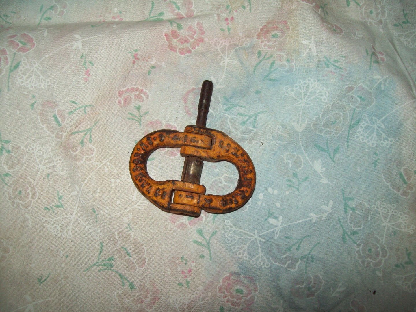

I think from memory it was illegal to join chains,,, they must be one continuous link,,, however it may have changed.
I will look further.
Baz421 said
06:05 AM Nov 26, 2013
Ah checked my references VSB1 and 3 states legislation - can't find anything that says you can't join the chain.
KFT said
06:08 AM Nov 26, 2013
I think Bobs pic is of a hammerlock which is designed to join chains and if rated the same as the chain should be no problem

The Hammer Lock is only way you can join chain's that take a Load.. They must be Rated higher/the same as the chain..

Ok I had a Look your figure's are correct.. For a Hammerlock I would go higher in rating.. so that the chain is the weakest link.. Make sure that the there is no wearing on the link's of the chain.. [No dragging on the ground] if it has lost 10% of it diameter it should be replaced..

IF I had to buy a joiner to suit a particular chain I would buy a hammerlock one with the same diameter as my chain from our local Skipper Aust store.. or any other good industrial bearing shop should have it in stock..

VSB1 states chain, not chain, joiner, shackle, or piece of fencing wire. Just chain. However correct size Hammerlocks are approved within the engineering, rigging, maritime and construction industries as a recognised method of of joining chains for lifting and towing purposes, but not however approved for use with chain blocks etc.
I don't know any engineer that would not pass a trailer being inspected where a hammerlock has been used to join the chain(s), but they wouldn't pass inspection where shackles had been used to join a chain.

I have a Hammerlock joined to a rated D shackle x2. Does the job.

We have 2 hammerlocks joining extensions for our two chains. These were done by a recognised caravan repairer/maker and gave us the extra length we needed on our Vista RV Crossover. We had to get the towbar lengthened for the Prado and so the chains were then too short. All absolutely legal.
