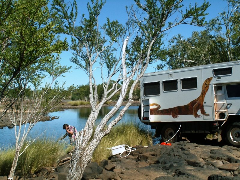

Peter_n_Margaret said
03:43 PM Nov 26, 2013
We do this on a regular basis. A foot valve is not required with a Shurflo pump because it effectively has one built in and self primes anyhow.
The pump is in the white box with one 'click-on' hose in and one out and a long heavy 12V cable.
Any marine chandlery will be able to sell you a strainer to fit.
Ken
