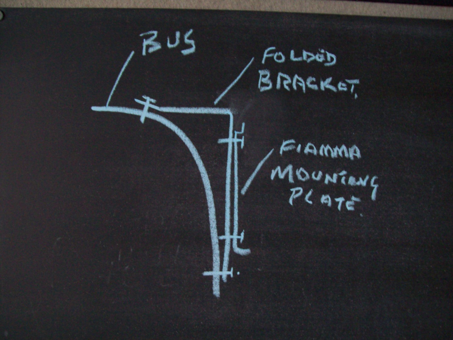

Hi All
I am about to fit a Fiamma awning to the side of our Volvo bus/motorhome. Is there a max height that the awning cassette can be fitted?
Also, does the cassette have to be fitted in a vertical position? the bus side walls have a slight slope cheers
Hi Robin,
Firstly welcome to the forum..
I have fitted about 6 Fiammas to the various busses I have built
It is best if you can make some brackets to attach it so it sits vertical becoz if you have it facing slightly to the sky the arms will also come out high which can be a problem..
I have always had my sheetmetal worker bend me up some long pieces of aluminum the full length of the awning that sets it out at the top and I screw them on with stainless self tapping screws
I then attach the brackets supplied with the awning to this again using large self tapping screws making sure using a string line so that all the brackets are perfectly in line and level.. This is important if you want the awning to come out freely and then park back in freely..
If it is too high getting a side curtain could be a problem so if you are getting brackets made you could slightly face the cassette down a bit so when the awning is out it is at a reasonable level. it is better to have to lift the outer edge a bit rather than have to put tension on it to pull it down..
It is important when screwing on the bracket to use a sealant on the screws..
