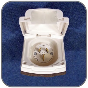

The inlet point to give you a pictorial description of what they Look like..
You Plug your power lead into here to provide power to the Van/motor-home..

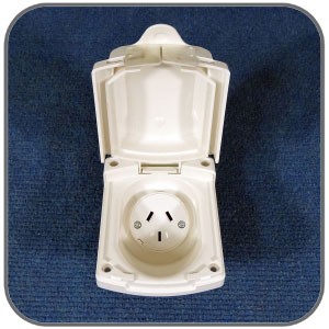

This is the outlet..
Plug into here to give you power to any outside appliance..
