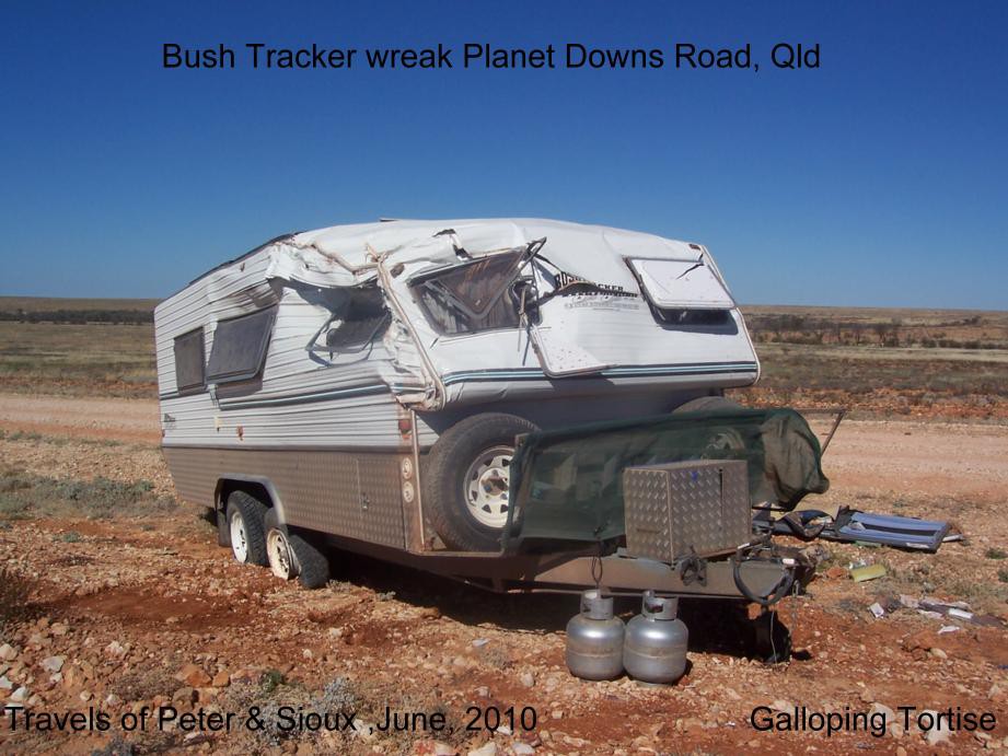

Ontos45 said
05:52 PM Nov 7, 2013
Even Bush Trackers break backs......taken near Innamincka in 2010.....bad loading can kill a holiday.

Ontos45 said
05:29 PM Nov 8, 2013
Baz421 wrote:
Why did it rollover,, do you know what happenned?
From what we heard from Innamincka was that the 4x4 tug was speeding over "jump-ups", the driver lost control, hit his brakes (we saw braking marks in gravel) and the whole shooting match went over. The only thing that saved the 4x4 was the full articulated trig hitch. The van when we stopped was as is seen in picture with all personal gear still in van and on ground, abandoned.

Ontos45 said
05:44 PM Nov 9, 2013
All ways wondered about the bush tracker mate, its ATM, from what I remember is 3.5T to 4T and needs a big tug. Built well and big which leads people to think they are bullet proof and over load them. Seen them with tinnies on roof rack of tug and fold-up boat trailer and out board on rear bumper of van. Sure yu've seen the same. I like at least 1/2T between my ATM and suspension components/chassis load limit.
Bad driving or bad loading impossible to say not seeing it in real time.....posted the picture more as a warning to what can happen either way to top of the range vans so be carefull folks.

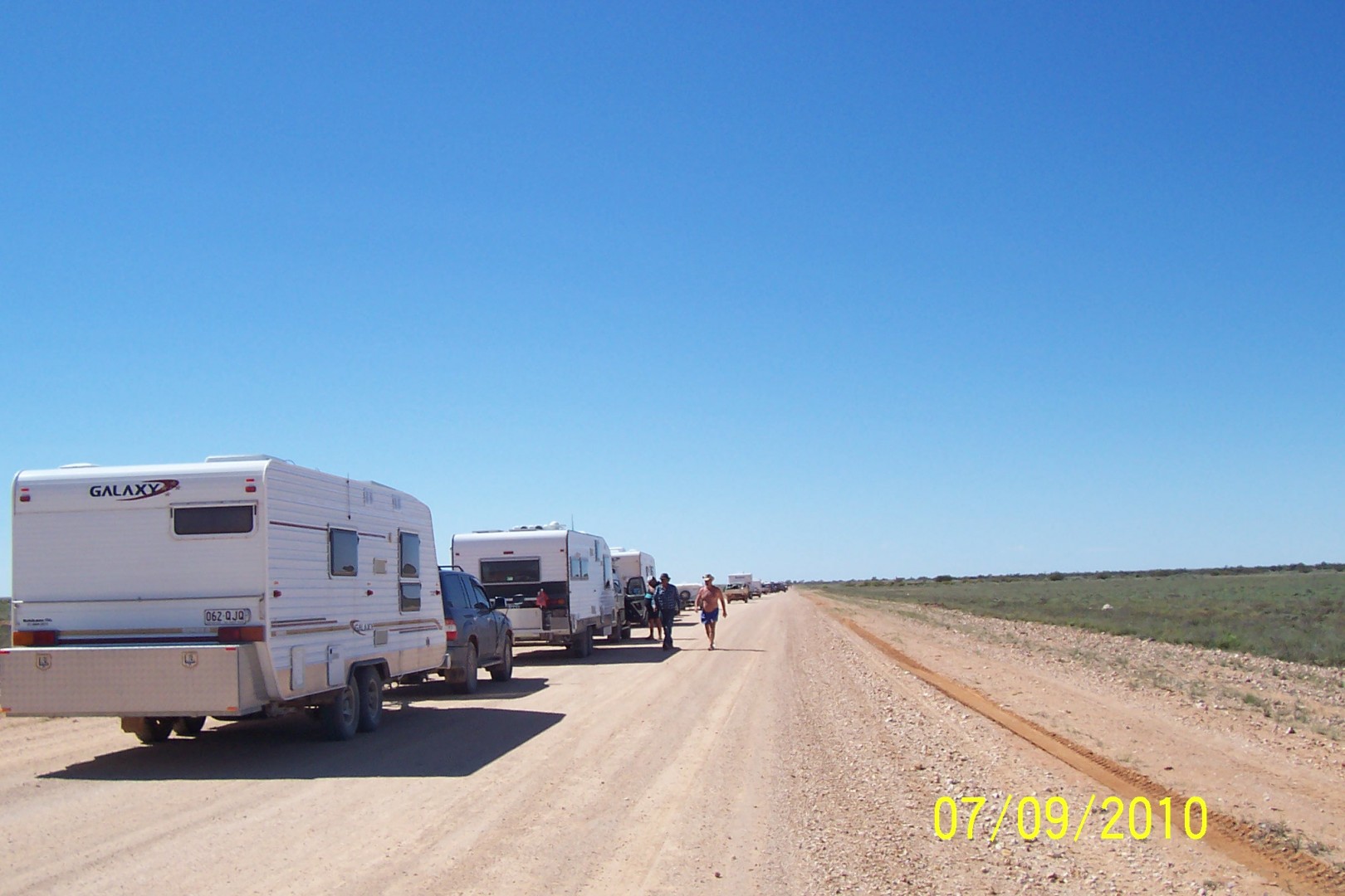

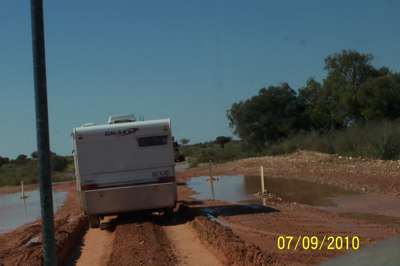

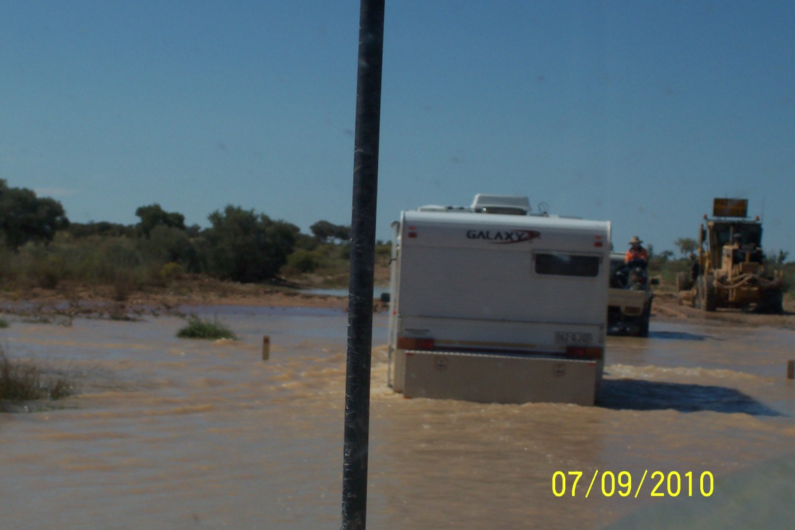

Ontos45 said
06:46 PM Nov 9, 2013
Couple more for you Baz.
This was when we had to get out of Birdsville during the 2010 floods. First time Cup was cancelled.
Hi Peter,,, so the cause is probably bad driving rather than bad loading in this case,, eh.
