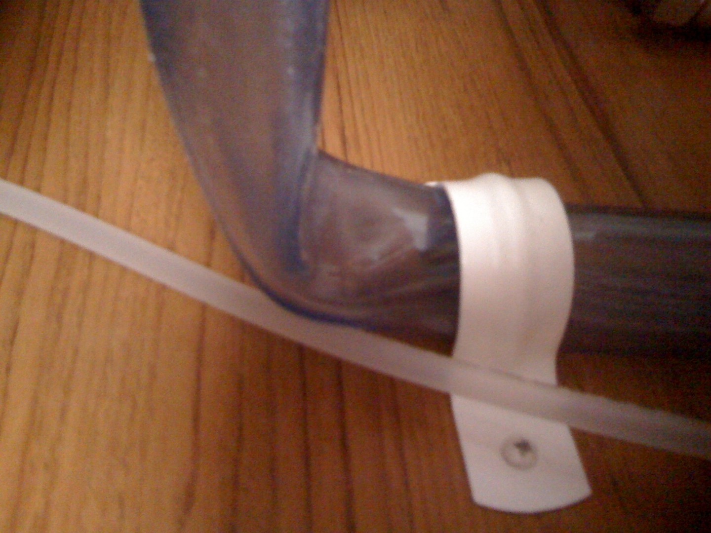

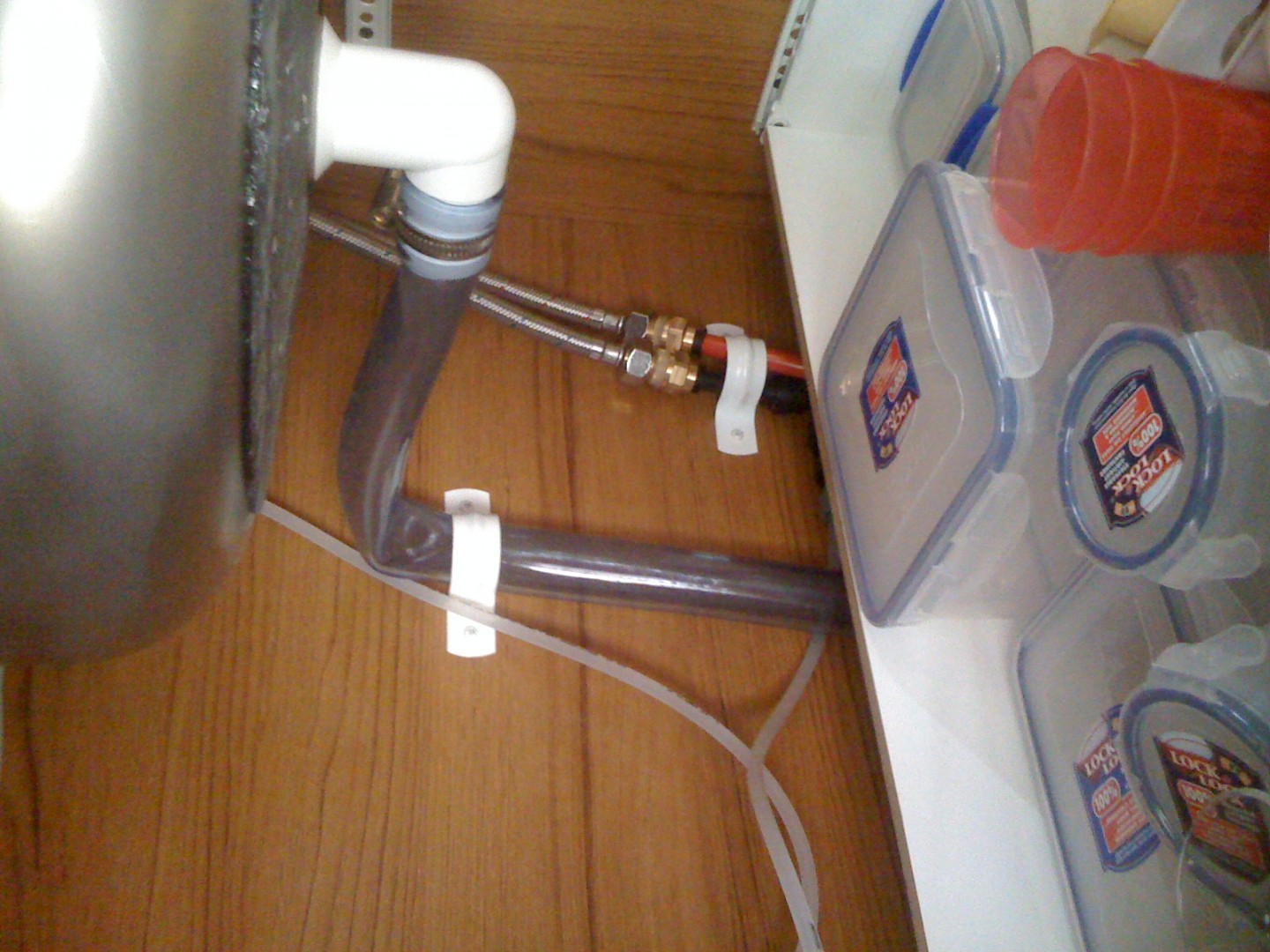

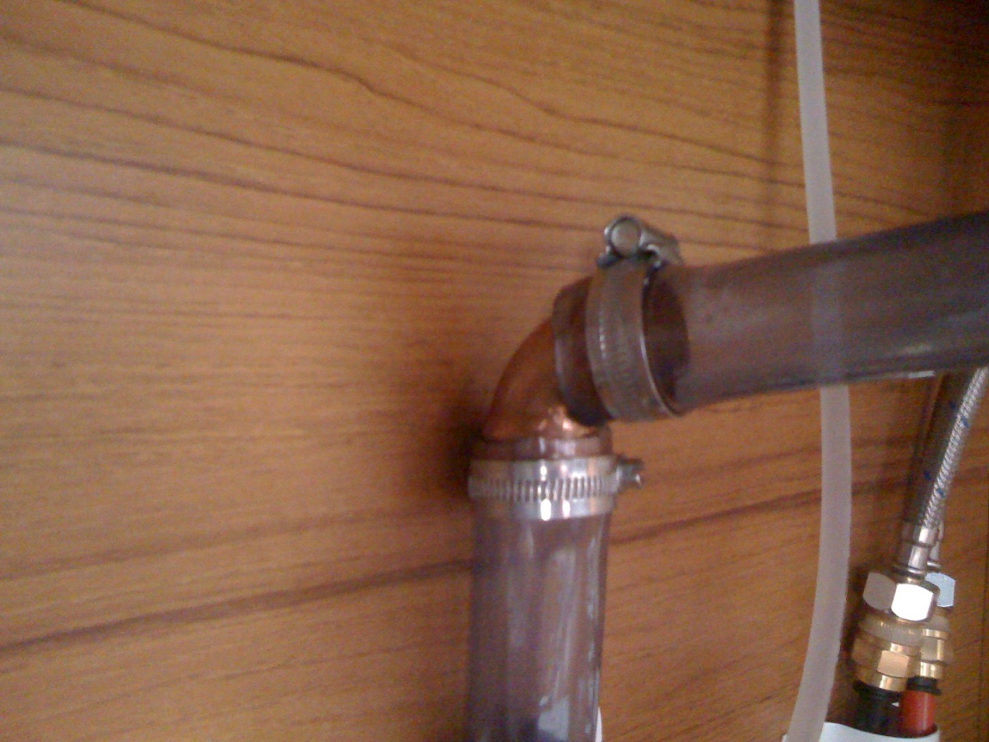

thanks for your comments, we happy with the rig so far, had a few Jayco manufacturing defects to sort out, like plastic drain pipe kinked so bad that even water did not pass on our first trip and one or two other things but now settling down a bit...I hope... we will soon know anyway.

Ha just remembered from day one have had issues filling the water tank takes forever to get 80 lts in found air vent pipe kinked over to, was the same soft clear plastic hose as the sink pipe, cheap as chips stuff!

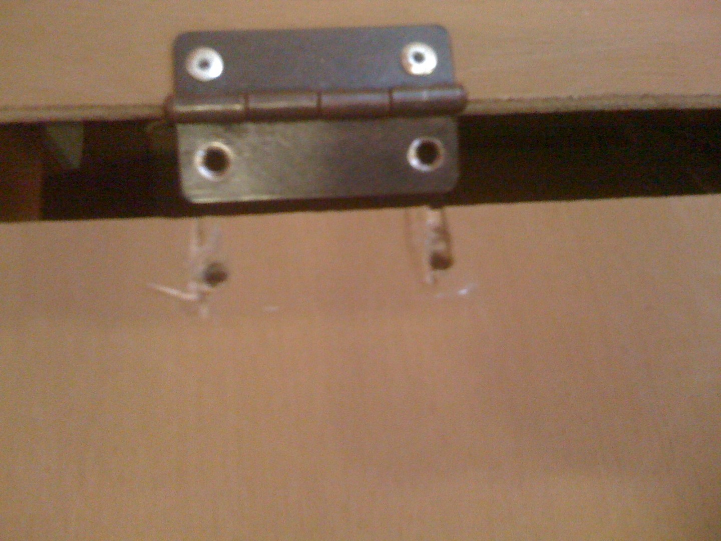

Re the bunk lid who puts in a standard pop rivit into 3mm plywood to hold a hinge on?? who uses a 3mm plyood lid to support the bunk seat, gives way under 10kg load let along my 90 = kg weight ??

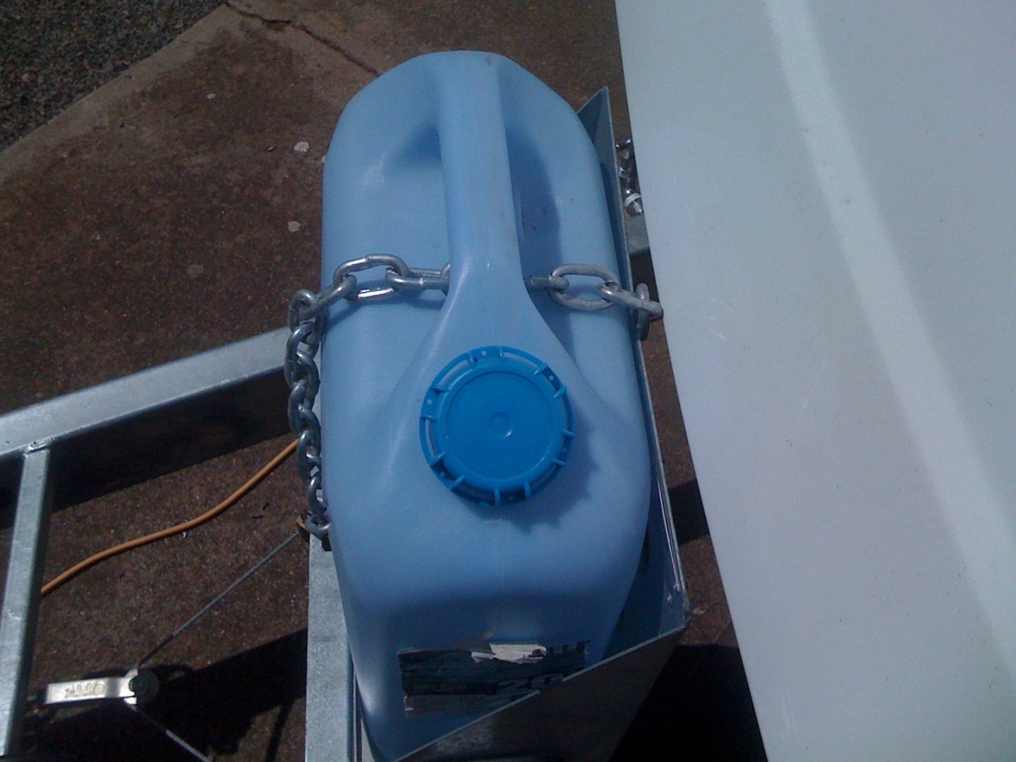

The water bottle holder was welded too close to the front door hatch so each time you opened the door if it had the 20 lt bottle in the holder it scraped on the chain,
