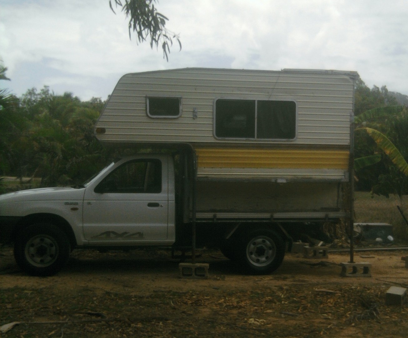

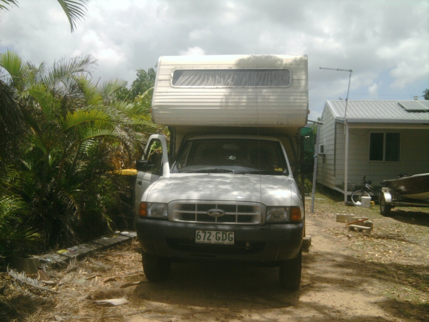

I have just swapped cars, and put the camper on the new one.I don,t think I will have to fit the overider springs as the new one has harder suspension.I took it for a run , and there doesn't seem to be a lot of body roll, so I will wait and see.The next job is to fit the dualbatterysystem, and the water tank. I have 2 water tanks with about 130 ltr capacity. I am going to move the flexible one in between the cab and the camper to give me more storage room.Here's a couple of pics as I go along. Bill
It's all looking good, Bill. That tray doesn't look any higher than mine.

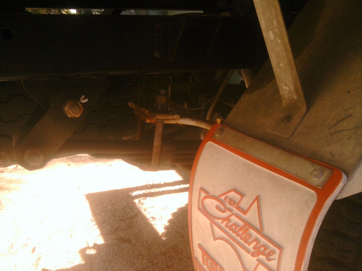

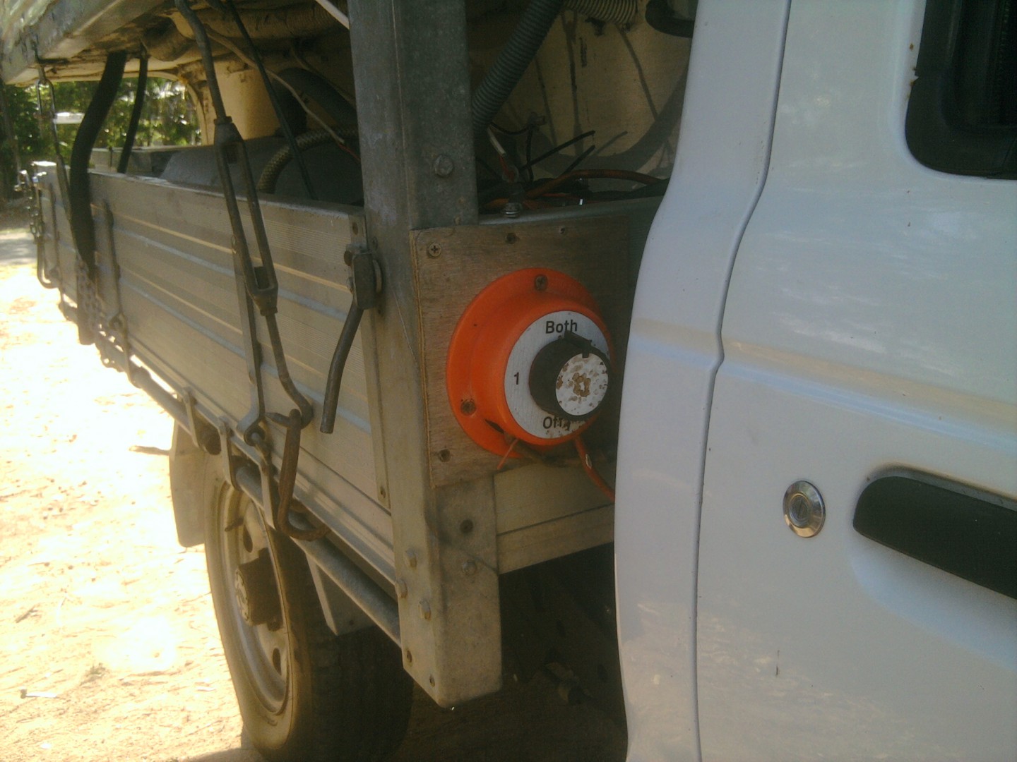

I fitted the load plus extra springs this morning, with no problems ,in about an hour . These are very simple to fit, and would recommend them to anybody with flattened springs or overload problems. Ask Gary Kelly, he has them, also.They also help with stability.I also fitted the dualbattery system, yesterday. I use a marine rotary marine switch which has a I,2 or both or off system. Cost about $20. Work well, with no power input.I usuall leave it on all the time. Having 3 batterys of about 120 amp/hr will runmy rig for 5 days or more. I also have 160watts of solar.everything seems to work, so I will probably go for a trip upthe Atherton tablelands, next week.
bill that's great only cost's you, your time, as you already have the parts from the old rig. You certainly are not mucking around you will be back on the road in no time.
