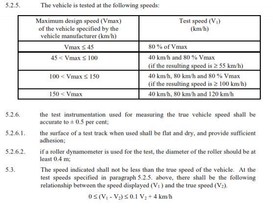

The attached file is an extract from ADR 18-03. You will note that the calibrations are made at only a few speeds. There is also no specification of the linearity of the instrument.
There was mention in a message above that the accuracy could be out by a s much as 10% + 6 km/h. The 6 should only be 4.
-- Edited by PeterD on Monday 28th of October 2013 04:23:22 PM
The speedometer in your vehicle is produced and calibrated according to Australian Design Rule (ADR) 18/03, which states: - Vehicle speedometers to indicate a speed equal to or higher than actual vehicle speed and no more than 10% + 6 km/h higher than actual speed. For example: If the actual vehicle speed was 100km/h, the vehicle speedometer must indicate no less than 100km/h and no greater than 116km/h.
The speedo cannot read less than the actual speed, so this argument won't wash with a speed camera!!!!!
