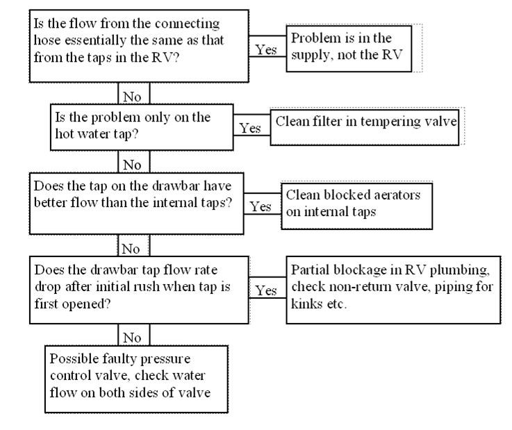

Here's a flow chart (pun intended) attached that may help in diagnosing the problem.

Yes i will crall under the caravan and check the pressure valve.Stay tuned.
