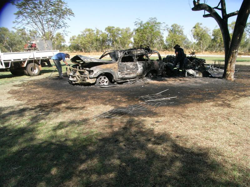

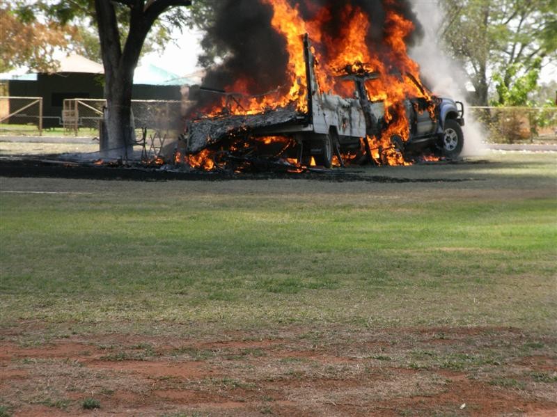

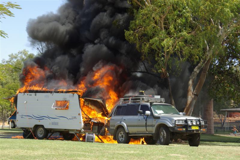

Also be aware of the way your load (including your generator) is distributed, see these link;
As mentioned already, it would be better to carry a generator inside the towing vehicle rather than on the front tow bar or rear of your caravan. Always refuel away from your van and vehicle, the pic's shown are of a fire from the petrol fumes and fuel from a jerry can (when the cap was opened) which was being used to refuel a generator being ignited by the gas pilot light of a fridge. Two people were severely burnt and were lucky to survive, luckily their two children were outside the van. One of the adults were burnt trying to save the person who had been refuelling the generator.
I would post the full story here but it is copyright. Not the way you would want your holiday to end.
Duh said
12:53 PM Oct 19, 2013
Dougwe wrote:
Did you see on the right hand side of the first pic, the little kid, how close he is. Maybe not as close as it looks but way too close for my liking.
Sorry to side step a little Joanna.
Yes I notice that too Doug, with this type of fire you get things exploding (eg; gas bottles) and projectiles flying through the air. They did have a couple of small kids who luckily did not get injured so maybe it was one of them.
I have seen one caravan fire and one bus fire, and the whizz bangs going off and flying around in both was scary stuff.
And yes, you still get people refuelling and travelling with their gas fridge on and think it is ok, I just hope they aren't there when I'm alongside them at the pumps.
Here is a snip of the story;
Snip....it all happened within minutes as he prepared to refuel a generator at the Banka Banka Station caravan park, 110km north of Tennant Creek on the Stuart Highway.
He was attempting to remove a metal army-style jerry can from his caravan's drawbar but had difficulty because the warm fuel had expanded.
"I was trying to depressurise the container to get it out of the holder and take it round to fill up the generator at the side of the car," he explained. "Within a quarter of a second of opening the jerry can there was a flash and we were engulfed in flames. The fuel container turned into something like a flame thrower, with flames shooting out of the nozzle."
It is believed the pilot light on a small portable fridge between the caravan and 4WD ignited the fumes.
"There was no way I could stop the flames," 35-year-old Mr xxxxxxx said. "I grabbed a fire extinguisher, but the fire just laughed at it. Other people used their extinguishers but they had zero affect so I told my wife to grab the kids and run."
Mr xxxxx and wife (30) received hospital treatment for burns, but their two children xxxx (3) and xxxxx (1) were unharmed.
The 2005 Windsor Rapid expanda caravan and early series Toyota Landcruiser 80 series factory turbo 4WD were reduced to a mass of charred wood and twisted metal within minutes. "There was nothing anyone could do to save them," Mr xxxxxx said." ....Snip...
(Google Banka Banka Caravan Fire for the whole story)
