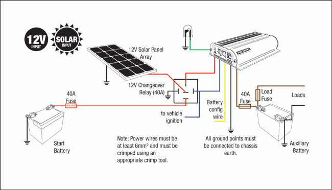

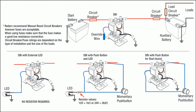

This is how I set mine up for the camper trailer.
Firstly a Redarc Smart Battery Isolator to add an Auxilliary battery to the Troopy, using the start assist configuration (gives you the ability to jump start from the AUX battery.
Then a BCDC1225 DC to DC charger with solar input in the camper trailer like this.
Originally I set up the DC-DC charger to feed from the alternator via the isolated supply. That is basically from the Troopies AUX battery positive terminal. But due to some other electrical problems I was having during a trip, I reconnected the BCDC1225 straight off the pos of the Troopies main battery. Either way will work OK, but possibly better to fed the BCDC1225 from the AUX pos terminal. Something to note is in either case it's not the vehicle batteries that are feeding the house battery, but the alternator, due to the fact that you won't have any current back to the camper trailer (in your case van) unless the ignition is (connected via ignition controlled relay) or or the starting battery positive terminal voltage rises above above 13.2V (again when the ignition is on and starting batery charged).
