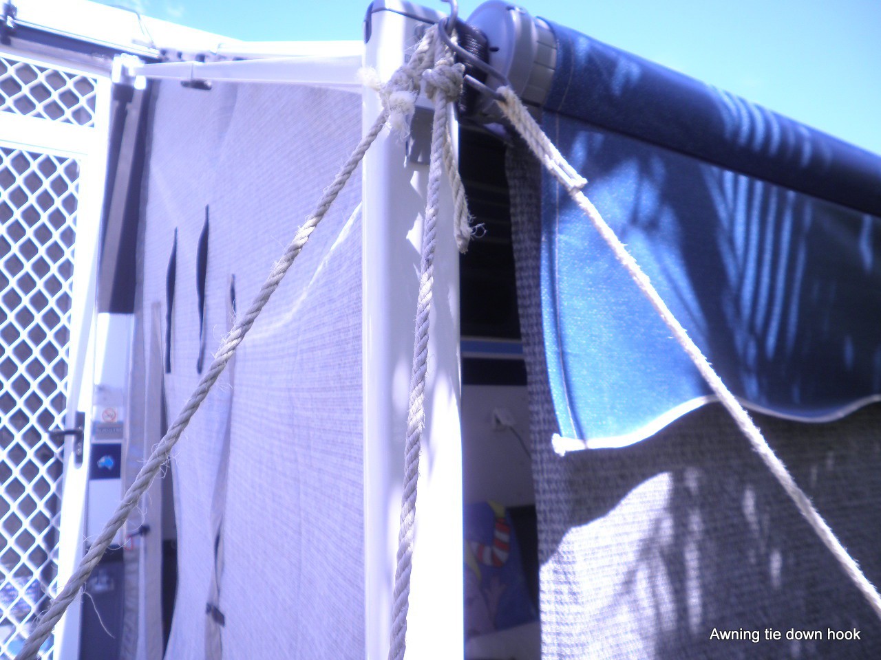

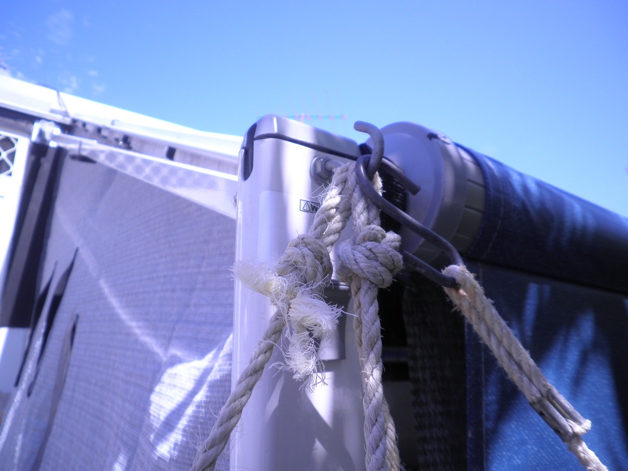

Looks pretty solid.Tie downs are only as good as your ground pegs.

Reading this Post I will today go out and add the hooks to my awning, it will be neater and my wife can place the rope onto the hooks and peg out the awning if I am not about. Thank you.

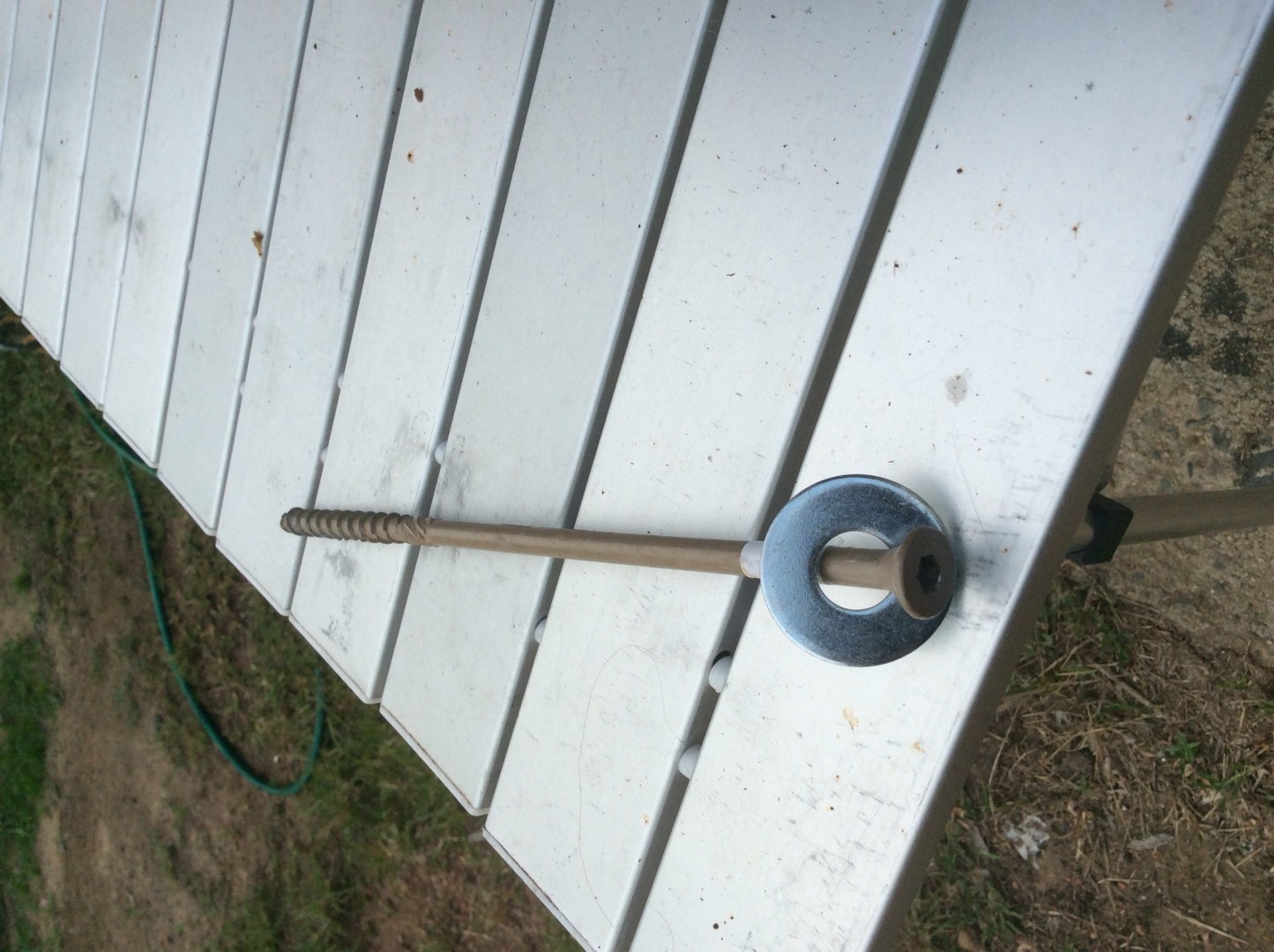

I'm lazy & sick of bending pegs. Simply use 10" framing screws fitted with washers with an 18V hammer drill to screw them in. If the ground is solid rock, I drill an 8mm hole with a long masonry bit then drop in a standard 8mm peg. Have found the framing screws work as well as pegs in most ground & far better in broken rock, etc. when it's time for removal simply reverse the rotation on the drill & screw them out. From experience an 18V two speed reversible battery drill is best.

Oldboar, what do you mean by framing screws? Do you mean the hex head type timber screws, or something more specialised? A pic would be great if you wouldn't mind.

bloomoon wrote:
Pics
I used something similar, but used the eye bolts instead of hooks, same snap on hooks as you though.
I bought mine from Bunnings....

There you go, Bob. Hardest bit was finding the 6mm driving bit to suit.
OK, now i got ya oldboar. Looks like they'd work well too

I finally know now what people have been talking about before when it came to tent pegs . Just another item to add to the ever growing list of things needed too make it more easy . I can.t count how many pegs I have destroyed while camping. The pic oldboar, explains a lot to me .Makes more sense to make a small guide hole.

Don't need a guide hole Alan, just screw them in with the hammer drill. They hold better than pegs the same size & far easier to put in, pull out.
