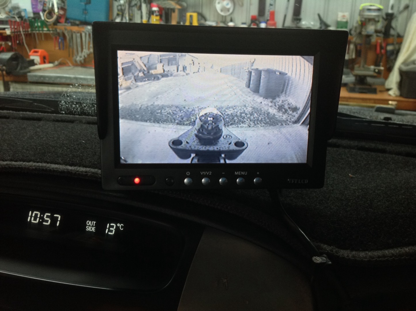

That's a good setup Olley46.
That's the view I get now.
Very useful.

That looks to be a good view Ollie but that monitor appears to block a lot of windscreen area, be careful.

I was given a cheap reversing camera for Dad's Day.
Set it up with the camera beside the rego.plate.
Could see well but the fish eye lens made it hard to judge distance.
I have just relocated the camera to the top of the tow hitch.
Used some scrap square & L aluminium, a few cable ties & a touch of glue.
Now the camera looks down on the tow ball for coupling up, much easier.
Also, now I can judge close distances when parking.
Only a little fix but has made the camera so much more useful.
Very useful.
