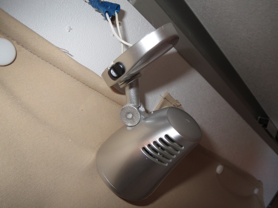

Has anyone had any experience in stopping one of the LED reading lights losing it's ability to stay pointing where it's supposed to? Ours is pretty useless as it just won't stay in the one position.

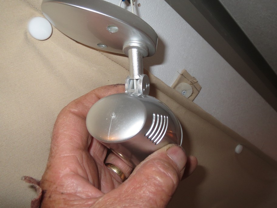

I figure I'll have to drill completely thru the joint located where my digit finger is in the 1st pix - then fit a stainless bolt and wingnut...maybe a friction washer or two.
However there are lots of smarter people on this forum that may just have had this problem before and know a very easy fix and be happy to pass it on.
Thanks
Denis

wrap some fine cotton thread around where it pivots so it gets down into joint. It will stiffen it and not be seen.
Neil

I think a bolt and wingnut is not the answer as the friction area is between the outer and inner flanges only, and thay will probably fail (look brittle to me) if any pressure is put on them.
One alternative may be to drill out pivot joint and "pack" between the inner and outer flanges with something like a manila folder/neoprene type washer jammed in place and then a bolt and nut inserted, but NOT overtightened.
Others may have done a repair,, so lets hope other suggestions.

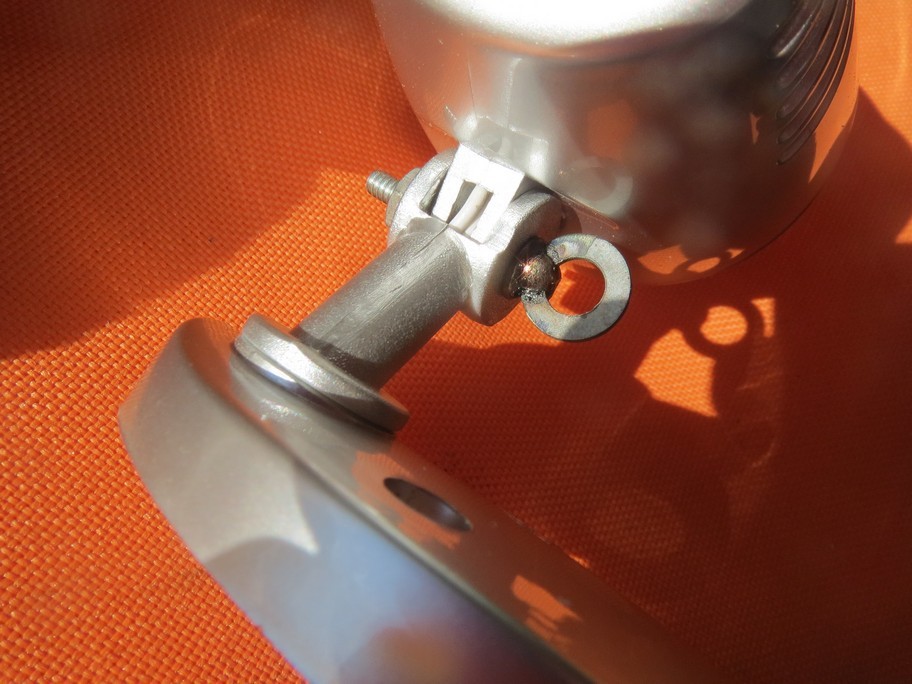

Final update - cotton worked for a few weeks then the plastic hinge started to splay so decided to drill straight through the hinge and put a nut and bolt on it. Soldered a washer to the bolt head so it can be gripped better and at the nut end I've used a star washer. Seems OK so far.....bad original design I reckon.
