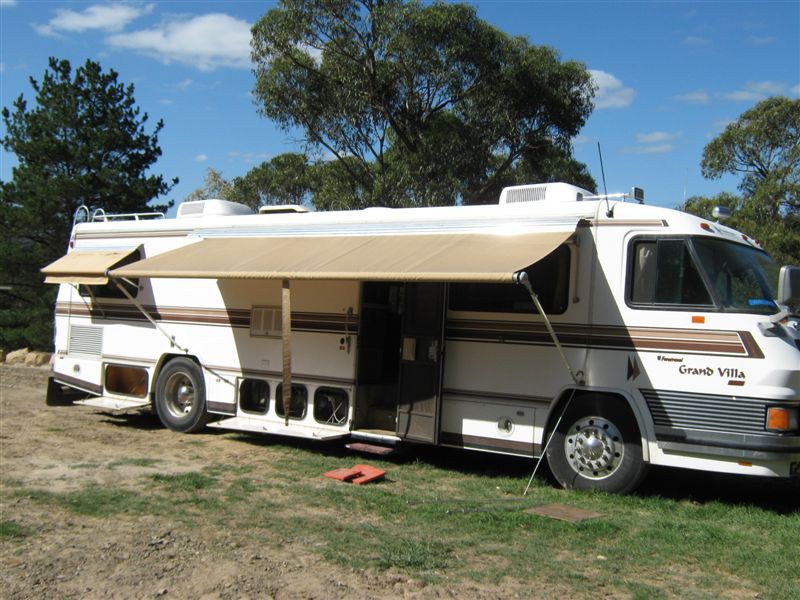

Here it is, Roadworthy, Registered and on the road,
12 months and two weeks it took from buying it in Texas, USA, To driving on the road in Victoria, Australia,
Its floats along on Full Air Bag Suspension, Sitting in an arm chair high above the surrounding traffic, Perfect all round vision, It does a a blind spot in the Big front mirror, Snaky neck wobble fixes that,
300 Cat Horsies, certainly pushes it along, Hills, What hills, It doesn't notice them, Did a shake down cruise of 2000 Kays, Lilydale, Semour, Bendigo, Laverton, Werribee, Geelong, Colac, Terang, Cobden, Port Campbell, Ottways, Great Ocean Road, Warburton, Pakenham,
Accelerating 9 ton up big hills, Niiice, 2nd gear coming down big hills, Holds it about 50 Kays without any thing getting hot under the collar,
Pleasure to drive, But very squeezy on some of our twisty tite roads, I have plenty of time, So I just pull over and let the pass, My Coach wont go past a bus or truck on corners, Its just too big,
I am very glad now I didnt buy the forty footer I was looking at, It was too big,

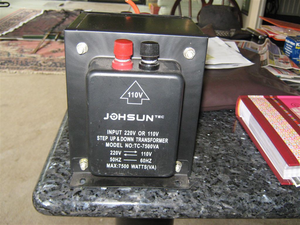

The Electrics are now the problem, That Transformer cooked itself, I should have left them alone, They dont need conversion to 240 Volts,
Live and learn,

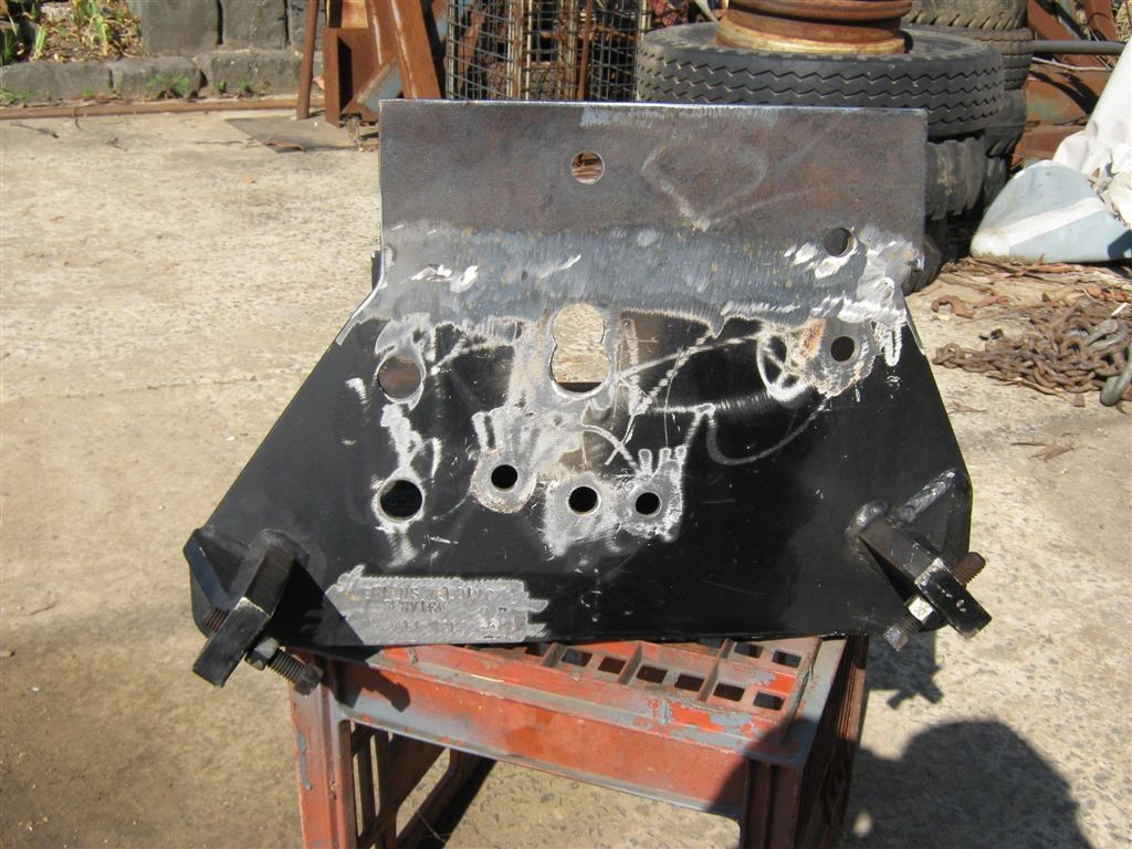

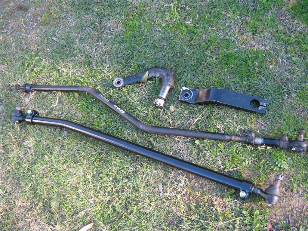

The drag link had to be replaced, it had been heated and bent, Dangerous,
The ball joints are now on each end and and been beefed up to take standard Ford ball joints, Off the shelf here in OZ,
I had to beef up the Steering box as well, It was way under any specs here,

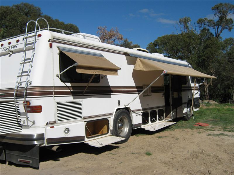

Seats 5 Licensed to ride, Seats 7 in the lounge room, 3 seater lounge and four arm chairs including the drivers and passengers arm chairs, They all swivel round, and are full recliners,
Its certainly a head turner here, as it stands out from the crowd, Hahahaha,
Its a 1989 Foretravel, Grand Villa, 36 foot, Class A, Diesel Pusher, ORED, 300 Cat, with an Allison 4 speed Auto gear box, On an Oshkosh Chassis,

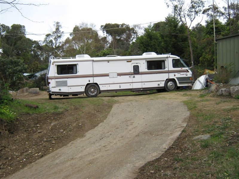

This is what the ramp was supposed to do with the Coach on it,
But all the weight of the Coach, is from the rear wheels back,
Pushing 6 ton, including Dual wheeled Diff,
The whole rear section, Diff, motor, gearbox, can all be unbolted from the Chassis just in front of the rear wheels,
It is not a full chassis, Which quite surprised me, Thats a lot of weight and tension. just hanging on bolts,
So I will just have to back the coach on to make it work,
With the car on, It was just a slow gentle roll forwards, till it sat on the front legs,
I can take a chair under and work comfortably under the Coach, Now quite safely,
