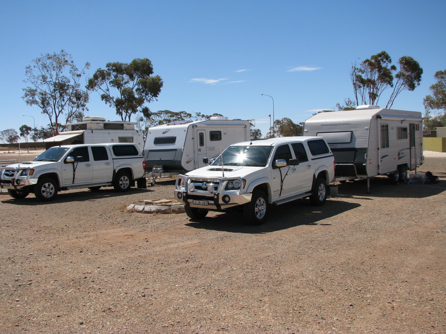

Hey Wendy, we had a 2010 LTR Colorado great vehicle towing a 19' Coromal of about 24/2600kg done it easy at 16lrs to the 100. I also had her DP chipped and that made a difference the reason I know that id we had two LTR;s on our last trip in March one chipped ,one not. We then set off towing my 19" van and the other towing a 15" Avan .At the bowsr and we both travelled at between 90/100km/h on the road in the same conditions with a bigger van vs smaller van I would use at times 1/2 to 1 litre more in fuel, at fuel up so a worth while investment so much so we have chipped the second vehicle.
