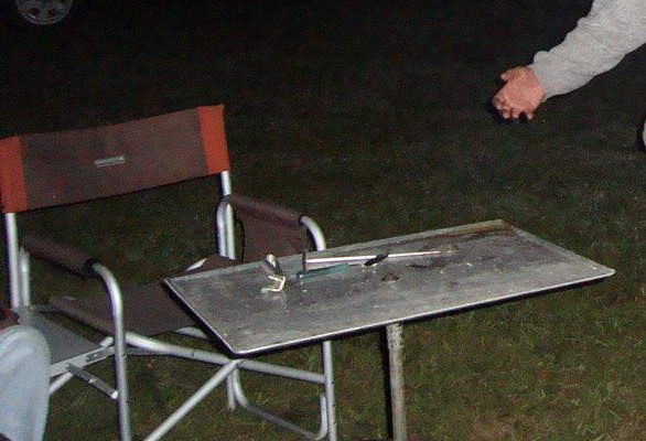

I have one of those, It has one leg, stands level on any terrain, cant fall or be knocked over, rotates, weather proof.
& its not for sale/give away or anything else. Too handy.

Very easy mate, the tube type leg has a fixed/welded nut in the top.
remove the centre stud & you have a flat alloy top, a ground peg & the tube leg to store.

Can you please explain about the bottom end - what is the base and what stops it from falling over?

This will blow my secret; A ground peg of 3/4" rod x about 300L with a colar about 75mm from the top. ( just a bit of pipe1/2" Long tube tack weled to peg as a locator for the leg to rest on. The leg is a tube that is a neat fit over the peg, its a three peice componet. The pic provided shows it on top of my fireside pole that holds billies, BBQ, camp ovens, which is the reason for the height which is standing height. Good for tools, coffee mugs, toasting equip & goodies. As a coffee/ beer & nibblies table when on the ground peg it's about 450 high.
JC.
Copy rights;
Patent #7963502MINE.

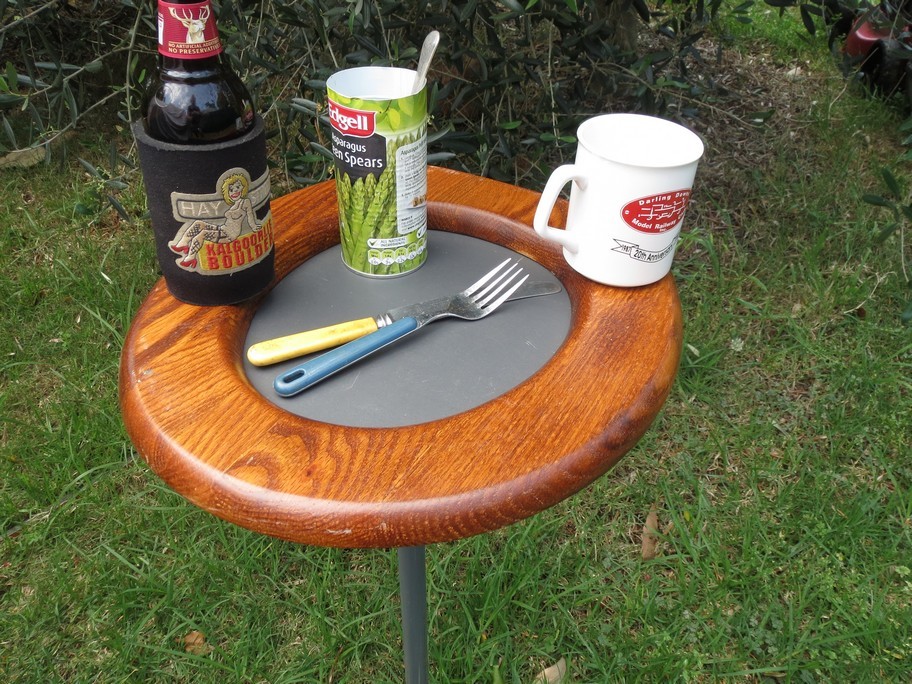

Just finished my new one leg table - made from well seasoned timber with a drop centre to stop the nibblies falling off the edge. The leg and drop centre unscrew easily so the top can be used with a drum. Hopefully this design does not contravene JC's patent rights.
Good Luck.
HA HA, maate fit the rest of the lid to it, it will worry the hell out of some unsuspecting bugger when he see's the size of the plumbing below.
Patent rights, table???? NUH. Leg; now thats another story!

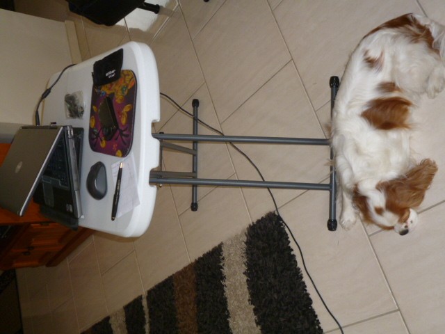

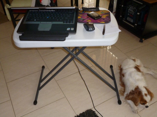

I have just bought a Lifetime little table from BFC which I love $39.95. I use it at home for my laptop as well. Adjusts to 3 levels and is weatherproof.
Great buy.
Joy
Sheba said
06:49 AM Nov 6, 2013
Great buy.
Joy
A Pic. would be good.
Thanks,
maanpa said
11:41 PM Nov 8, 2013
You may get the "picture" with my beloved King Charles Sharni. Sorry couldn't get any smaller

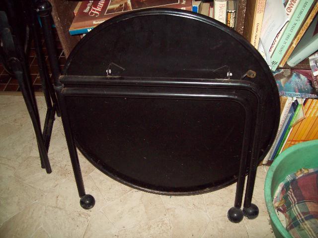

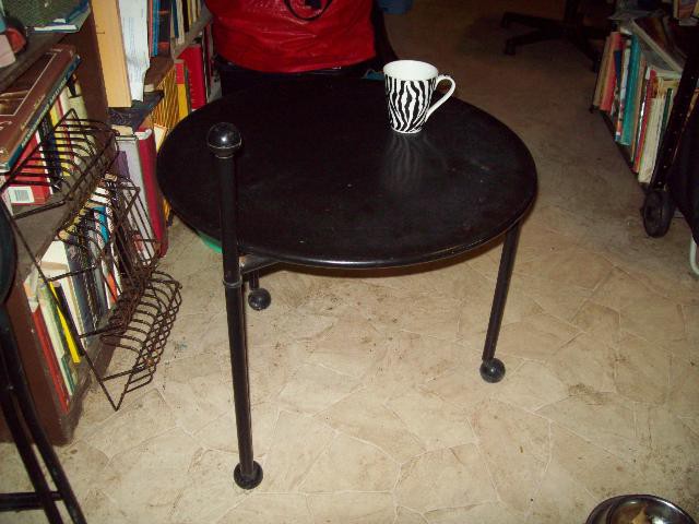

I found this one in an Op-shop. Big enough for what you want I think, 3 legged, and folds almost flat.
-- Edited by Sheba on Thursday 26th of September 2013 07:38:57 PM
Great buy.
Joy
Thank you.
