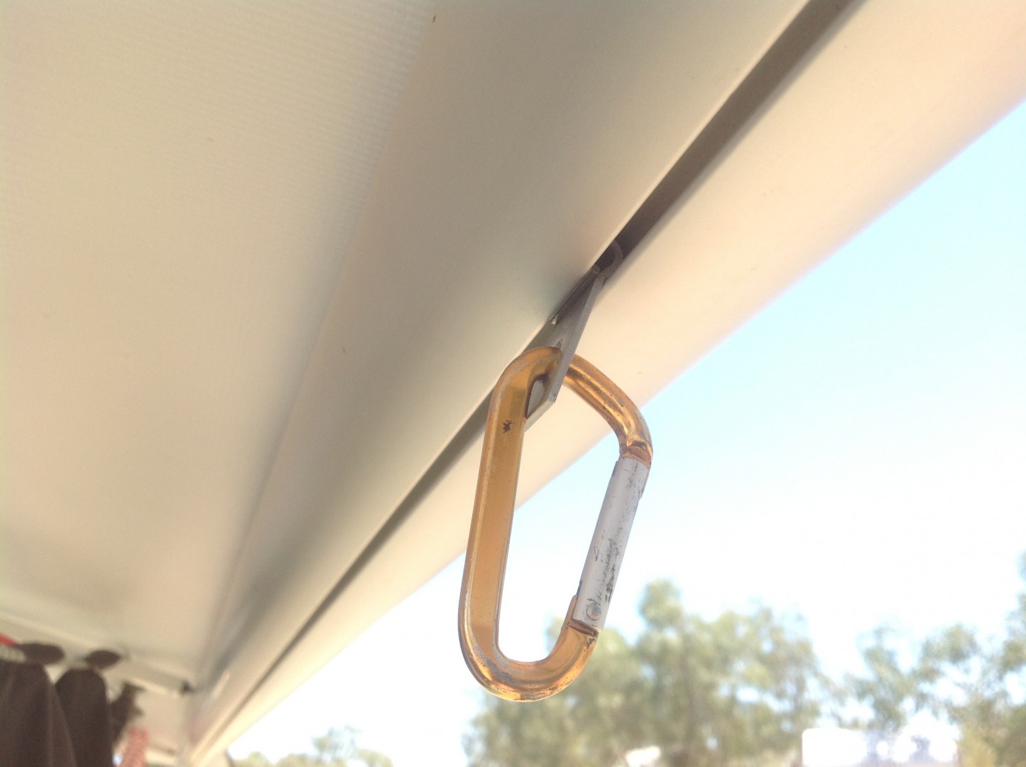

It is a great Idea without doubt, but, Leverage would be my concern.
If the bracket is pulled towards the outside of the awning the straight edge of the hinge will push the right side of the awning channel upwards, and the scroll side of the hinge will push the left side of the awning channel downwards thus rendering the channel bent.
OR, do you just anchor the awning down in a vertical direction, or have I completely missed the purpose of the bracket??
Is this something new or has it been in use for a while?
Really not wishing to be smart, just looking at it from a leverage point of view.

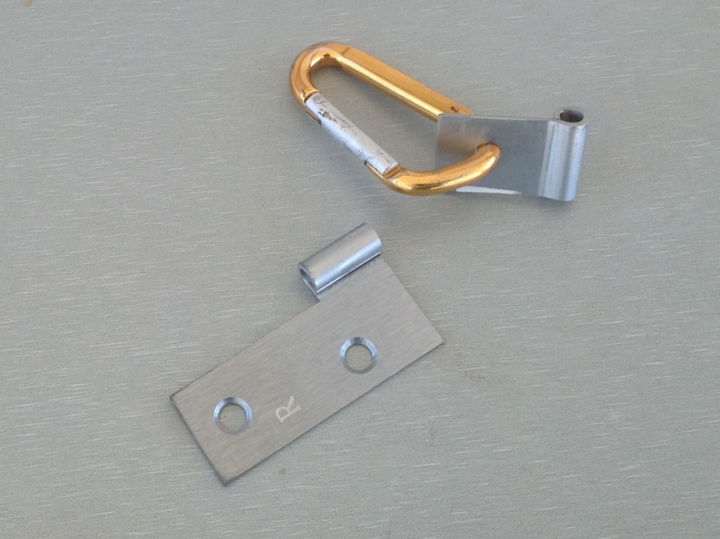

Get a 3inch (75mm ) door hinge and cut as shown in photo make sure hinge fits into awning slot

Mark&Linda I bought one a while ago I just mad it simple ,I have been using them a few months and have had no problem with them.
Even in heavy wind .
Alan

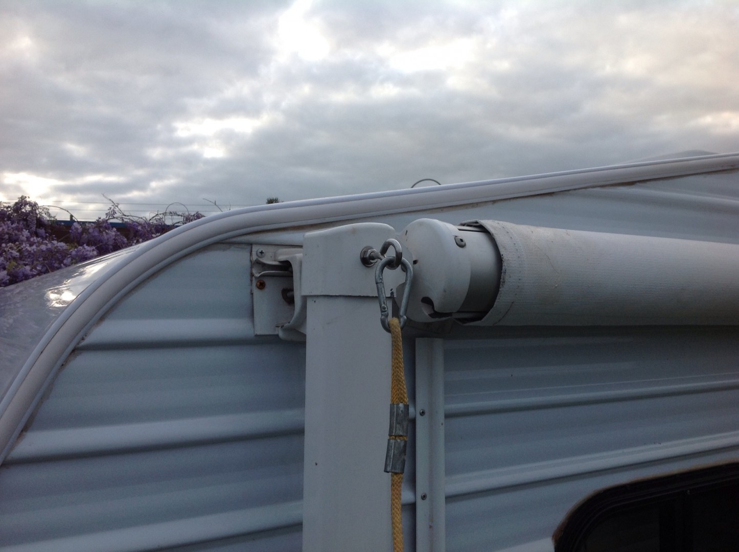

I use a butchers hook at each end and drop my tie downs off of that out at 45 dergrees, was interested in your invention for another purpose, I'll knock one up and give it a go. Cheers

We have a privacy shade which blocks out 90% of everything, light/breeze, so my plans was, make a very simple "more open" shade cloth for when we have a bit more space around us and affix it to maybe 5 of those brackets with snap clips. If I make one and it is successful I let you have a piccie.

Sorry I forgot to put pics in for the other use the wife uses clip for. Still learning about GN forum how to use.likeyour idea Mark Cruising Granny 500 litres of water is 500 kilo half.a tonne
Whatever means of anchorage system you use it needs to be a quick release system so when that unexpected wind pops up the system can be droped asap & awning rolled up, the only place for it in windy conditions.
I use the same spring clips as Alan, only they are on the end of the guy ropes which go around the end of the drum & clip back to the guy rope.
Its just loosen guy rope & unclip, drop to ground & roll up awning.
Those brackets would have to be removed before roll up.

Hi mark just one more thing I was told by many people ,in vans & shows never put ropes around Center axel of awning
might bend.

I under stand what your saying Jim but it doesn't take long to unclip ropes slide it out and roll up awning .
