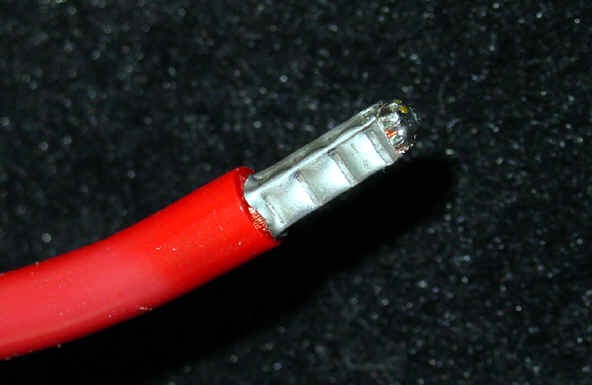

Soldering or crimping connections are both good if they are done correctly. Crimped terminals and splices are better mechanically where vibration is an issue, and are just as electrically sound as soldered connections (again, if they are done correctly). Because Scotch Locks are generally used to splice one wire into another wire, it is probably easier to solder, as small guage splice connectors aren't easy to find and it would mean cutting the main wire to be able to fit the ferrule. This would allow you to use a piece of glue lined (dual wall) heatshrink over the joint instead of wrapping it in electrical tape however.
Screw conectors used to connect light guage wires are also prone to poor connections, due to the screw cutting through the fine wire, unless it has had a bootlace ferrule fitted to it.
Thanks 03troopy - never heard of glue lined (dual wall) heatshrink - GOOGLED it and it sounds good. I'll go with soldering and some dual wall heatshrink. Never hear of bootlace ferrules either.
Screw Connector
Bootlace Ferrule
Many thanks
