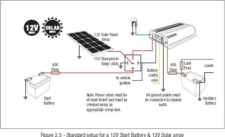

Is it safe to run my solar through a dc-dc charger. I run a dc-dc charger in my van through a Anderson setup from car and can I just plug my portable solar panels in to the Anderson plug on the van when not attached to car or do I have to have a separate setup
justcruisin01 said
04:11 AM Aug 26, 2013
Some DC-DC units are also for solar as well, however you will need to verify this before doing so.
If not I dont think you will get away with doing as you suggested, A cars voltage is around 13.8 volts;( give or take a bit each way) & solar open voltage can be as high as 21volts.
I think this may cook the DC.
JC.

What brand and model DC to DC charger are you using Sumo?
snapper49 said
07:28 PM Aug 27, 2013
Depends on what you have
I have a Ctek D250S Dual with dedicated Solar input as well as a dc current from the alternator
Some of the Redarc DC-DC chargers have been designed to use the input for use as an MPPT solar regulator input. As far as I know the alterator can not be used for a solar input on any of the others.

Yes, I fitted a Redarc BCDC1225 to the camper trailer in this configuration. Used a 7amp CTek to charge when 240V was available at caravan parks. It worked well too.

I have spoken to C-tek specifically about the connection requirements of the DC250s as I wanted to run alternate inputs through the same Anderson plug with just one positive connection to the c-tek. ie either the car battery or a solar panel from the Anderson plug. The DC 250s has two specific inputs for input from car battery and solar. I was advised directly by the c-trek rep that the solar must be connected to the solar terminal and battery 1 ( my car battery) must be connected to the other. So there must be two separate positive connections.
