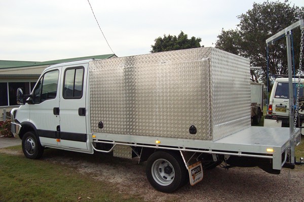

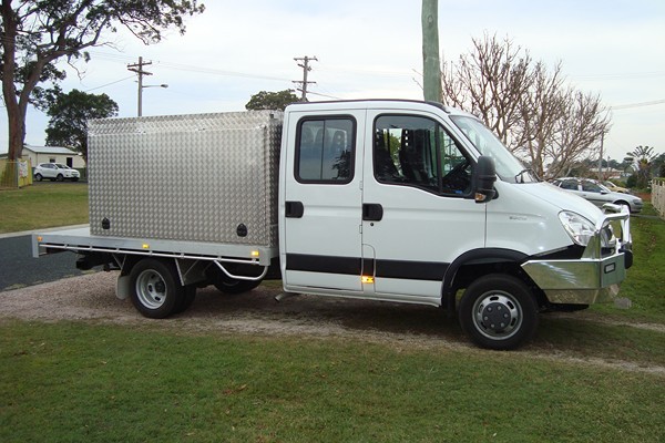

Very cool. Is your boat fitting on the canopy or does it go over the roof a bit, asking as your canopy is lower than the roof and not sure if you know, but there are no such thing as roof racks for these things yet. We had to get ours specially engineered by a private engineer for our boat on the roof which extends to the tray.
Just think of the ammount of gear you can cart now. Bet your happy with that. They have done a nice job.

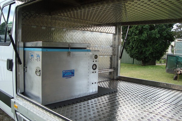

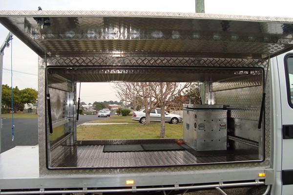

Wow what an nice canopy that is
plenty of space to store your stuff Jim
Not long before you both are back on the road again
congratulations my friend

That is impressive Jim, it looks huge, and the workmanship is impressive. VERY NICE.

You are so right, the canopy is a little lower than the top of the cab.
The reasons why;
My carports have a sloping roof line accross the driveway, there was not a lot of clearence between the top of the cab & the large exposed timber beams that form the carport structure.
With the canopy being wider than the cab at the top, & the rear of the truck being a bit higher than the front I had to make allowances for this so as to clear the carport roof.My boat has a 1820 beam, the full width of the canopy is 2mtr so no tapper in with the sides.
This difference between the canopy top & cab height will allow me to make & fit my boat rack mounting points to the top of canopy & they will remain in place& still have acces to the carport. The rack it self will be a fit on when travelling & removed when home & again to fit into the carport.
I am building my own side loader to fit ontop of the canopy. The tray length is 3.3mtr, canopy is 2.4mtr leaving 900mm at the rear for my boat trailer & outboard motor which will be covered by the boat when loaded. As my boat is a 3.99 mtr ; the transome will be flush with the end of the tray, & there will be 600mm over the rear of the cab.
The boat has front & rear grab/side rails therefore the rack has to be 250m above the canopy to clear the truck cab.thus the removal of when home, this will be simple just by removing two pins.
Sounds complicated but not realy, bit hard puting it into words. Hopefully the next lot of pics will show all.I bought all the steel this arvo for the loader & rack .cost me much less than one Rhino roof bar

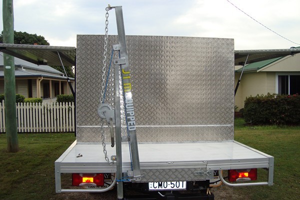

Must be time for some photo's. I built my rack today today, will fit winch mount tomorrow & maybe even get rack mounted over the weekend.
No hope of lifting this boat on, bare hull was 110kg, + low level floor, storage pockets along both sides & a casting deck up front.
Then add three folding seats, electrics, 2 bilge pumps,plus we leave life jackets, spray coats etc in the lockers.

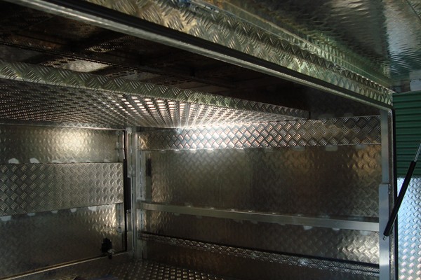

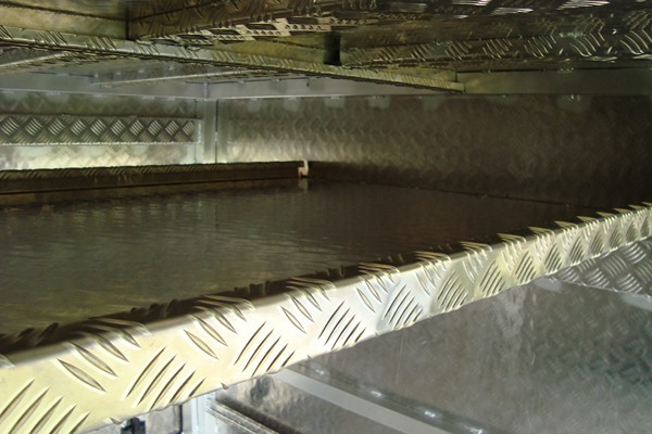

Jim it looks like quality sheet fabrication. Can't wait to see the finished product.

just 1 ? whats the winch for and if its for the outboard is there a brake on it dont wana see ya knock out all ya teeth .
just a thought

has that got a diff lock or a slipery diff
i was just wonderin how it would go on grass areas but then again rod does ok dont he not knocking it m8 just havin a rethink
dibs
freehazzas said
04:48 PM Aug 18, 2013
Ivecos go very well on grass and gravel. Has a very low first gear.

Hey Graeme, yes the winch has a ratchet lock each way & the systen is for lifting the outboard & boat trailer onto the tray.
This unit has the electronic stability control fitted, including hill start assist.
Time will tell how the stability control works, but the hill start means when you take your foot off the brakes to start off the brakes are held on for a further three seconds , stops rollback.
Can also turn the stability off if you wish.
