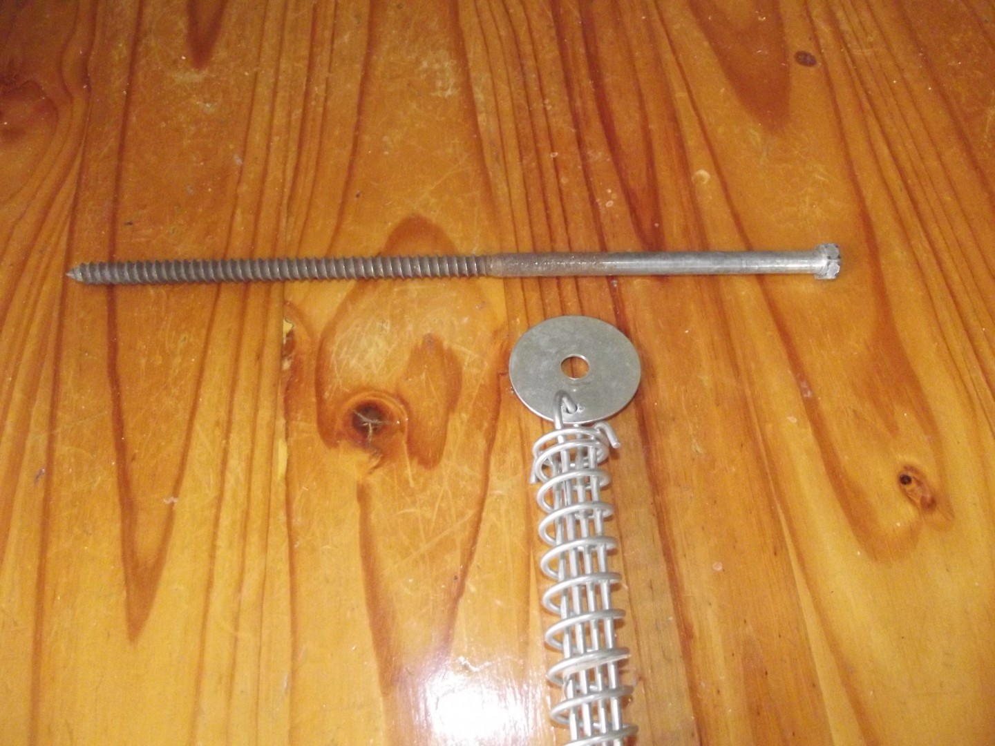

The pegs that Wombat 280 bought from BCF are what are called 'Blue Pegs.' They are made from plastic and are, as the name suggests, blue coloured. They actually look something like paint stirrers with a loop on top. The loop is used to both screw them into the ground and to attach guy ropes. As Wombat says the instructions are to screw them into the ground on the same line as the guy ropes. Actually, they are only suitable for soft ground, sand or mud. Their advertising also shows them being used to tie boats up to the shore.
As well as from BCF Blue Pegs are also available on eBay, I think that they are may be available on line direct from the manufacturer. By the way, they are an Australian design.
I have been using long coach screws for some three years now, having got the idea from British sites such as peggypegs and screwpegs. I bought mine from America on eBay and have two sizes: 30cm (or American 12-inches) and 225mm (9-inches). BTW, the Americans call coach screws 'lag screws.' Anyway, after paying the astronomical postage the screws worked out at something like $2.50 each - not too bad. Strangely, delivery was very fast, even faster than from England.
I bought large washers 50mm diameter with a 10mm hole. A 4mm hole is drilled along one edge and one of the hooked prongs removed from a trace spring, threaded through the hole then slid back through the spring. The guy rope goes on the other end of the trace spring. In use the coach screws are 'drilled' into the ground through the 10mm hole in the washer.
As others have found the coach screws have tremendous holding power - more than common pegs. But the real icing on the cake is that they come straight out of the ground, even after three weeks.
Murray

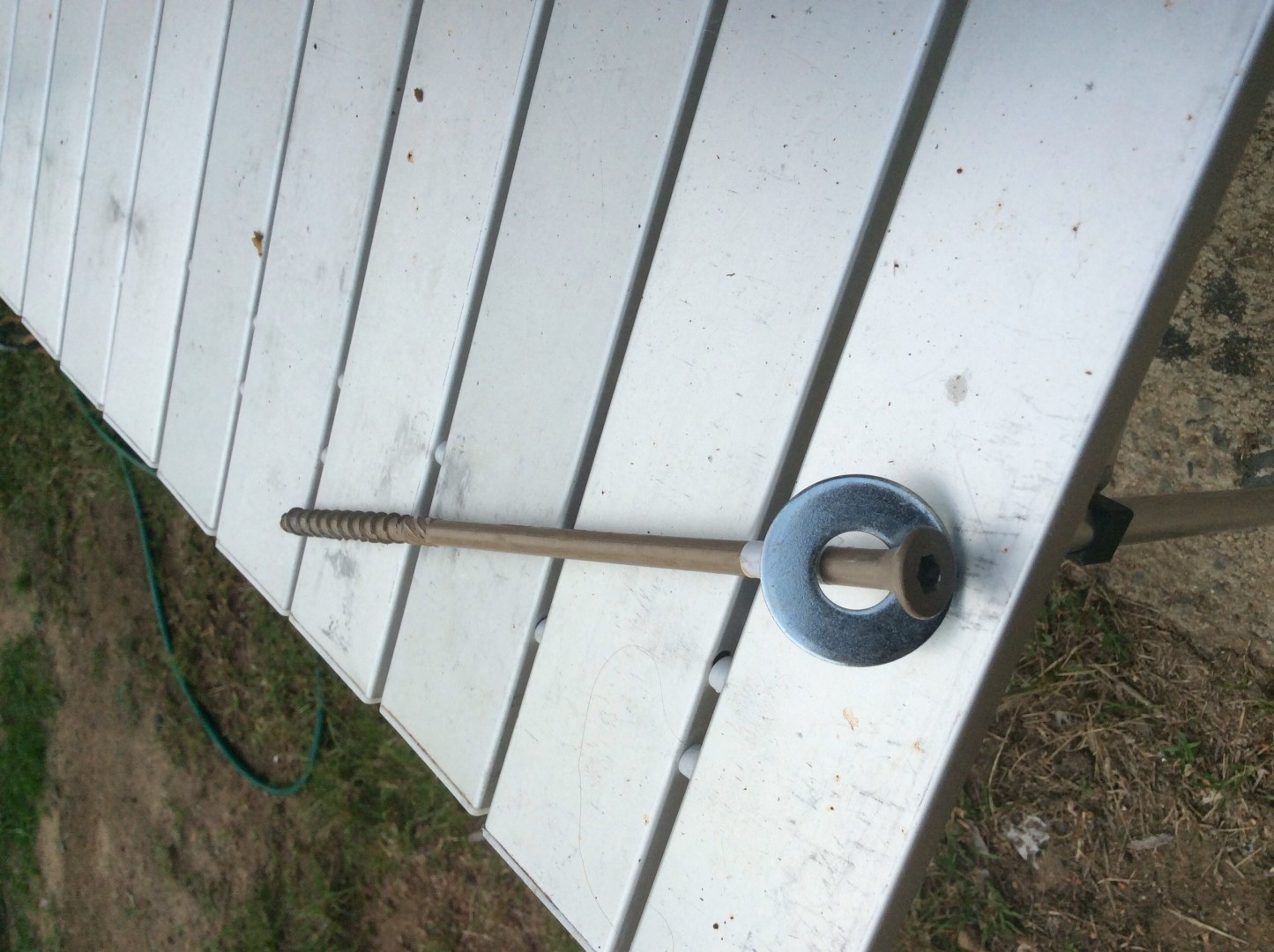

Jules, how long are the screws you use? Would a pic be asking too much??
10:31 PM Dec 1, 2014
Hi Paul - the screws are 250mm - the washers are about 10mm - there is a photo of one of the screws above, in Rocky Lizard's post. I can't find my photo of them.
We had pretty strong winds last night, and the awning hardly moved at all.

Here is what I use for my tent pegs. Apart from guy ropes I also use them to anchor the awning legs down - two pegs per leg are screwed through the holes in the base of the legs.
The screw is a 30cm (12-inch) long one bought from America on Flea Bay about two years ago. The washer is 50mm outside diameter with a 10mm hole. A 4mm hole is drilled in the edge and the middle loop in the spring is slid out, the washer threaded onto it then the loop is slid back through the spring.
In the over two years I have been using these screws none have pulled out, even in winds so strong over four days that our flag was shredded.
Thanks Jules..
YAY - found the photo Paul - here ya go ---
