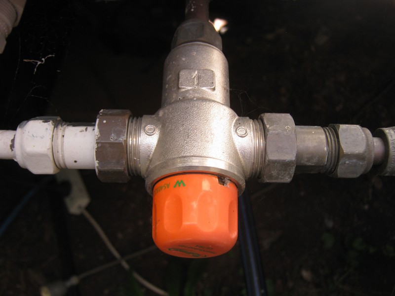

We have 2 tempering valves fitted to our house - one for solar and one for off-peak. You can prise the cover off on each of these and turn an adjuster with a pair of vice grips. This saves having to remove the unit and blank it off plus keeps it 'legal' (yes inspector, you can see the tempering valve is fitted).

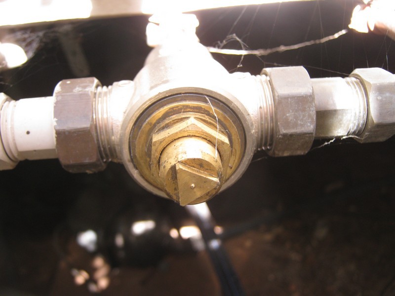

A five cent coin fits perfectly inside Tempering Valve
MMmm !! Thanks people .
