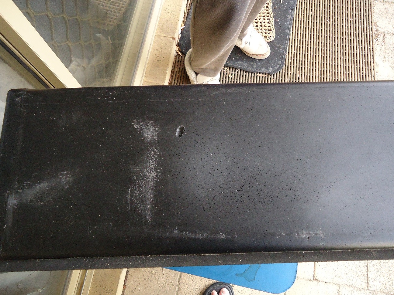

Dare I say it, I was fixing a cupboard to a lower inside wall of a bed in my campervan and misjudged the length of the screws.
To cut a long story short, the screws went right through the wooden panel and it looks like two of them have pierced my black plastic water tank which was fixed flush up to the wooden panel on the other side under the bed.  Looks like it will be a job and a half to get the tank out for repair, so haven't had a good look yet, luckily the tank was empty, otherwise the van floor would have been flooded. Â
I did think of the tank earlier, but thought it was further down under the bed and didn't check (yeh, I know...Duh).
So back to my original question, does anyone know whether these black plastic water tanks can be welded please???

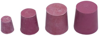

I Drilled the hole out to the size of a rubber cork, (Clark Rubber sell then in tiny sizes particularly for plugging holes) put a little bit of silicone around the cork, tap it in the hole and, hey-presto, job done.
There is also a two pack putty that you can use but unsure if suitable for potable water. I used to do a bit of plastic welding, bumpers, headlights etc, so yes you can weld them but they can be fiddly to do so if you go that route Vic get a guarantee beforehand that it will fix it. Personally I would go the two pack putty if suitable paying particular attention to cleaning where the hole area is. Another way would be to cut a plastic patch out and liberally silicone it in place seeing as it is on the top of the tank.

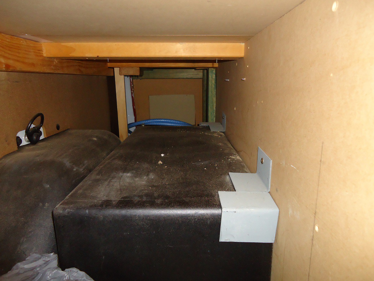

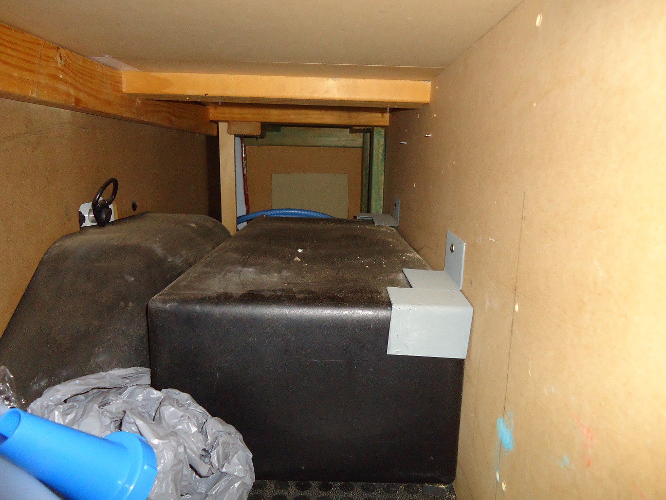

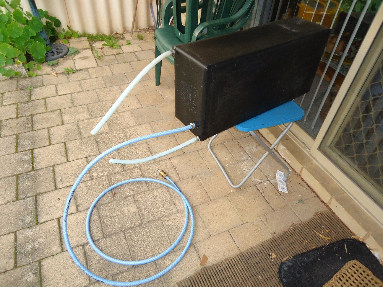

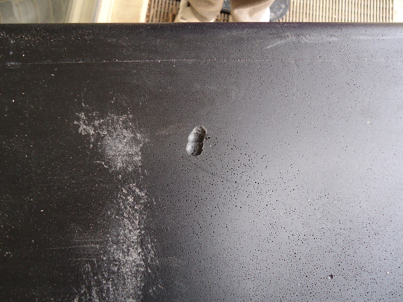

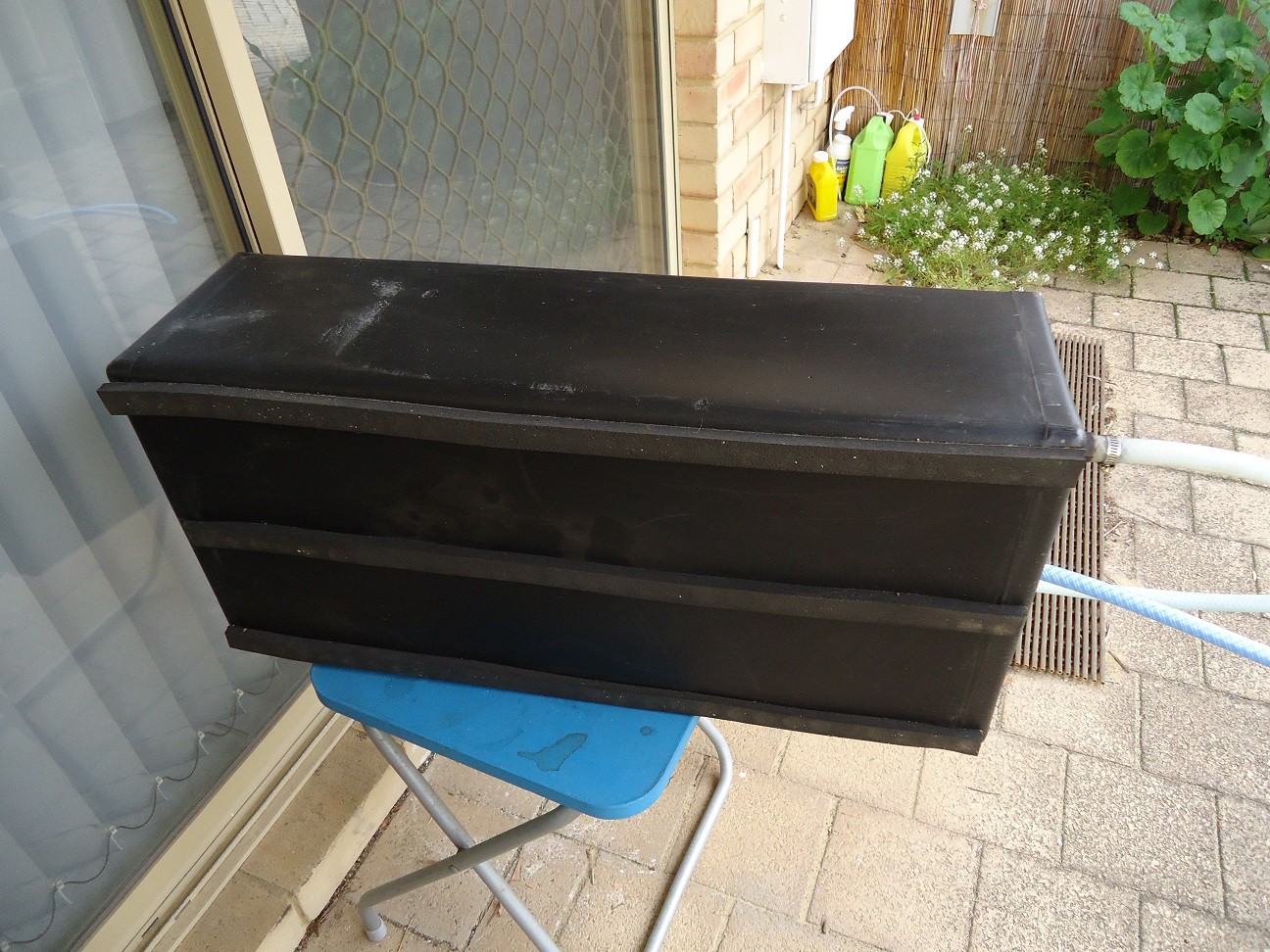

Here is a couple of pic's of the tank, one from the back of the vehicle and the other from the inside hatch, it looks like it is roomy in there but it is not, just an illusion. As said earlier, the back bracket is ok to get at, but the front (hatch bracket) access is in a long way and restricted by the hatch size. If you look in the photo's you can see two screws protruding through the timber on the side that butts up to the tank and just above it.
They are the screws at the top of the cupboard I fitted outside, what cannot see are the two screws at the bottom of the fitted cupboard which I believe would have punctured the tank when they came through. I have since replaced them with shorter screws, but a bit late after the event, but will avoid the problem again if and when I repair the tank (depends on time and whether I use it in the near future).
Having seen the pictures and now understanding the proximity of the lower screws that we can't see, here's what I would do if tank removal is not an option.
Assuming of course that you have punctured the tank, which, looking at the screw size is higly likely, there's not a lot to lose. So, get yourself a spade bit

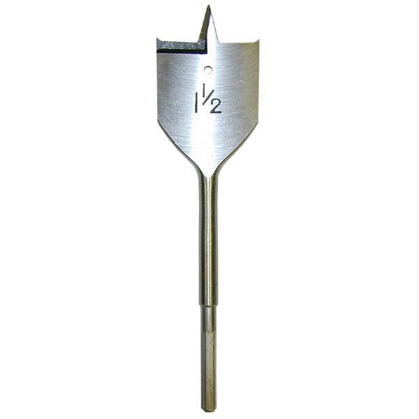

Put the pointed of the spade into the lower screw hole and drill.......... VERY GENTLY............ until the wood is removed and the plastic of the tank is exposed, yes the screw hole in the tank will be bigger now, but you now have access and space to do something with the hole. For me it'll still be a rubber plug or looking at the tank, I'm thinking that a puncture repair plug may just do the job. The hole is already there, all you have to do is put a plug into it. A puncture repair kit will cost around $25, a rubber cork about $1 Once repaired put a patch over the hole in the cupboard.

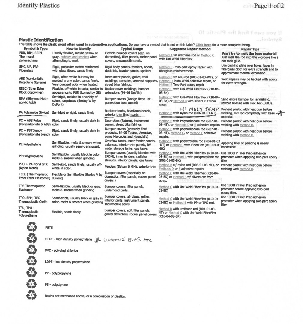

This is what i use to repair plastic tanks kayaks & any thing else plastic. Itsa a modified old soldering iron, reshaped the copper tip & pressed a piece of flared copper tube into the tip. This is used to feed plastic strips into the repair. I cut up different types of plastic in to strips to use as feed stock for each different type of plastic. Plastic welding if done properly is usualy a good repair. Also a list of diferent types of plastic i found some where on the net.
Thanks very much for that DeBe, according to your chart PE Polyethylene is used for RV water storage tanks, are far as symbols go there is a number 2 (but not in a triangle) on my tank which seems to indicate High Density PE Polyethylene as also used for wheelie bins.
It says to use Polyethylenes Rod or Fibreblex, and the note "Applying Filler or Painting is nearly impossible".....
I manage to remove my tank (had to cut the hoses to get it out, couldn't get to the hose clamps or other bracket, too far in).
The good news is, the screws I put in didn't puncture the tank, but the drill I used for one of the screw holes nearly did, no puncture to the tank). There is a shallow hollow in the tank where the drill bit bored out a small cavity, I am hoping I can just use something in the cavity to give it a bit more strength to the plastic where that is. Any ideas of what to use? Could I use superglue or something similar? Look for the small cavity indentation in the photo (only one).
After I have resolved that I will either have to buy some more drinking water (food quality) hose to replace the other hose entirely or get some joiners for where I cut the hose. Some sort of silicone or something (white) has been used around the hoses where they go through the floor. One hose is used to fill the tank, another for the sink hand pump, and the other an overflow pipe for when the tank if full.
What about silicone Jeff, I have some on hand, do you think that would be ok ???

According to the earlier chart it appears the type of plastic used for my water tank is Polyethylene ???????

Just to finish off the thread, filled indentation with putty, when dried put a "cross" of cloth tape over it for extra support, tested with full tank of water (and used Milton liquid to clean tank at the same time) no leaks, tank emptied and refitted tanks and hoses to Transit....

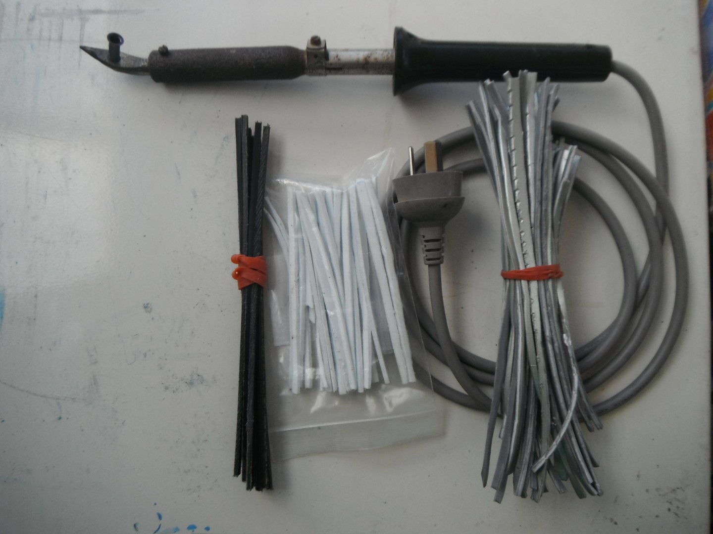

Buy a cartridge of Sikaflex 221 or 227 from Bunnings - under $20. Sandpaper around the area, make sure it is dry and then apply a good bed of Sikaflex over the area and then stick a thin piece of tin/aluminium or even thick plastic over the Sikaflex. Leave for a few days and it will be stronger than the original. The tin/alum/plastic over the top makes the patch stronger.
Use the leftover Sikaflex for 'whatever'.....it sticks/seals anything. It has been used to form suspension bushes in emergencies.
If you try to seal it with a soldering iron you are never guaranteed that it will not fail in the future.

Hmmmm......went to Bunnings, they sold me Black Sickaflex Pro which is drinking water safe which they said would do the job.
On reading the fine print (with my glasses AND a magnifying glass) it said "Will Not adhere to Polyethylene, Polypropylene or PTFE ".
So looks like it's back to Bunnings.
Thanks Mark, Silicone it is. Lucky I hadn't opened the Sikaflex tube I bought so will take it back to Bunnings for a refund!
All I have to do is find my Silicone now, it's somewhere, just have to remember where I put it!
When at Bunnings today, the just happened to be a Selley's Rep there doing there display. I explained to her what I need the stuff for and she recommended Selleys Knead-it Epoxy Putty to repair the tank indentation http://www.selleys.com.au/putty/epoxy/knead-it-aqua/ it can be used safely for fish tanks, underwater repairs and suitable for fresh and salt water among other things and it says it is safe for contact with drinking water. So bought a 50g container of that.
Reading the fine print on the back of the packet the Knead-it comes in and it said "Not for Teflon. Use Selleys Plastics Glue for Polyethylene or Polyproplene" and my tank appears to be Polyethylene. Might give the Knead-it Putty a go and see what happens. The link for the Selley's Plastics Glue is http://www.selleys.com.au/adhesives/household-adhesive/quick-fix-adhesive/plastics-glue/
Decided to go with the putty http://www.selleys.com.au/putty/epoxy/knead-it-aqua/ seemed to adhere ok, just waiting for it to dry out now to see if it falls out (I hope not).
If it stays put ok, I was thinking of sticking a bit of cloth tape over the putty repair as an extra precaution. Might sound like overkill, but easy enough to get off again if I have to, but will leave it in place if ok.....
Thanks Jeff, will do that and leave in place over the small patch....
