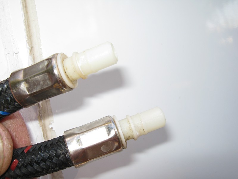

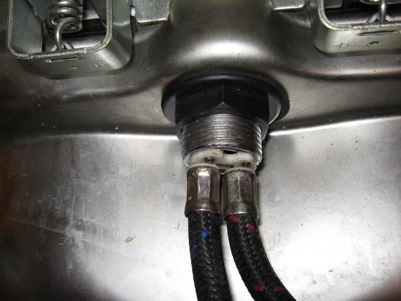

G'Day, on our recent trip to Townsville (where we met Dougwe!), we had some problems in the van with water leaking from the connection at the sink tap - a mixer type. I removed the connectors but found no "O" rings which may well be stuck inside the tap. So what I did was coat the fittings with tap grease to allow them to slip in easier and hopefully seal - which they did but not 100%.
Now, my question is whether the fittings should have "O" rings on the male bit and if so, I'd presume the seals are still "up the spout". If so I could use a bit of wire to fish them out and get some new ones?. Van is 7 years old so I guess seal would be hard with age. See attached pics for what words don't cover.

Don't think they are worn as the tip of the connector is the same diameter as the stub end and the shoulders are still square. To replace the connectors requires 2 new hoses. I'll see if I can use a mirror to look up the hole but my guess is that the connector should have an "O" ring on the tip when inserted much like the seal on the neck of the filter on an automatic transmission.

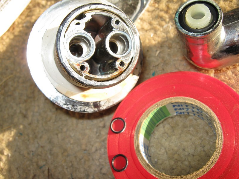

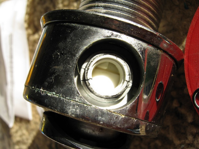

Update....decided to screw the unit from the sink - damn thing is made of plastic!.....anyway, found a "O" ring up each hole (pic 1 )so I can renew that to stop the leak hopefully. In pic 2 you can see cracks discovered when I unscrewed the spout from the tap body. I can see some Sikaflex 221 coming in handy. I am a bit disappointed at the quality of this unit - even the $29 mixer taps in Bunnings are made of brass...this thing is lightweight for sure but flimsy as. It has to handle town pressure so I might even change it to another type if available. Any suggestions/hints appreciated.

Final update - fitted 2 new larger and thicker "O" rings and screwed it up snug.....leak is down to 1 drop every hour but that still is no good so a replacement is definately needed.....the split plastic really makes it cactus even if I sealed the leak completely.
