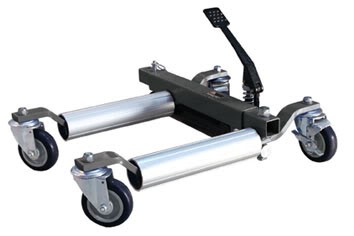

I think the cost of movers on 4 wheels would be very expensive.
May I suggest that you put the movers on 2 wheels only and see how you go and if required add another two.
However there are many caravan movers that can be coupled up to either the tow hitch or the A frame and a good quality one of these type would be my choice as you can then use it on another van if you need or want to sell your current one.
Similar to this
Remember also with a twin axle van that has four wheels close together you cannot turn the van sharply.
To do this you would need a car mover type implement under 2 of your wheels.
