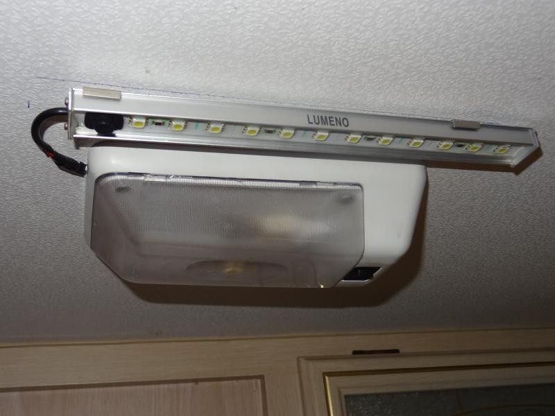

In my Jayco Westport with 12V lighting, I just paralleled up strips of switched LEDs. I have the option of either or both lights but only use the LEDs. Did this mod for every light inside & out.
(I was fortunate to have a number of LED light fittings mounted on aluminum strips; waterproof and with on/off switches included plus mounting clips. I can easily remove them if I was silly enough to sell the van, leaving behind only one or two tiny screw holes at each fitting.)
I even made up replacement LED strips for my tail , stop & turn lights. Much brighter.
A mind boggling array of LED options are available on the net. You'll be able to choose an option that matches your electrical knowledge/ability .... and at a good price. Much much cheaper than retail.

I have an older motorhome that had a series of fluoro 240V lights. I basically disconnected the lights from the 240v and replaced them with LED strip lights. For these I purchased 5 metres of strip from China on ebay and made up my own lights. The roll cost less the $20 and made up 7 lights with plenty left over. It is very easy to make up and I would never buy LED's from any retailers as there is no justification for the prices they charge given how cheap these strips are.
