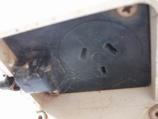

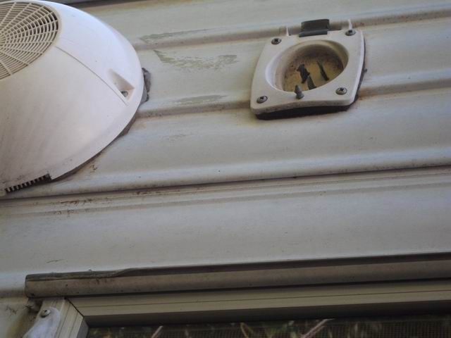

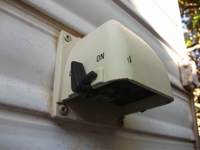

GaryKelly said
10:52 PM May 1, 2013
Your blood's worth bottling, Peter. Thanks for the tip about where to get another flap for the inlet. Here are some pics I just took of the inlet and outlet. I need a ladder to reach the outlet but the pic is okay.

ShortNorth said
04:29 AM May 2, 2013
Garry,
I'm a bit disturbed about that second and third photo - the outside powerpoint is NOT a RV type, it is just an ordinary household external weatherproof type, and it will NOT have double-pole switching. I'd get that replaced with a proper approved RV one ASAP !

oldtrack123 said
05:52 AM May 2, 2013
HI Gary As Shortnorth has posted The 2ndn & 3rd pics looks like a standard single pole outdoor unit {NBG} That CERTAINLY NEEDS CHECKING Pic 1 is a standard 15A RV approved inlet socket but the flap is missing It should be checked for contact pin condition as due to exposure they are probably highly oxidised That can lead to excessive heating at the connections [damaged wiring & possible fire] If so it should be replaced
PeterQ
