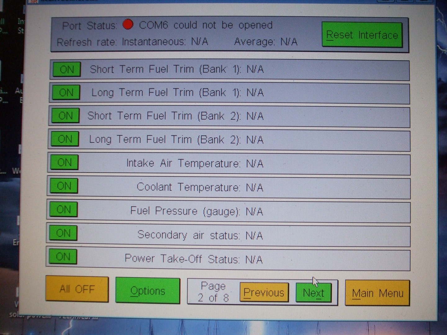

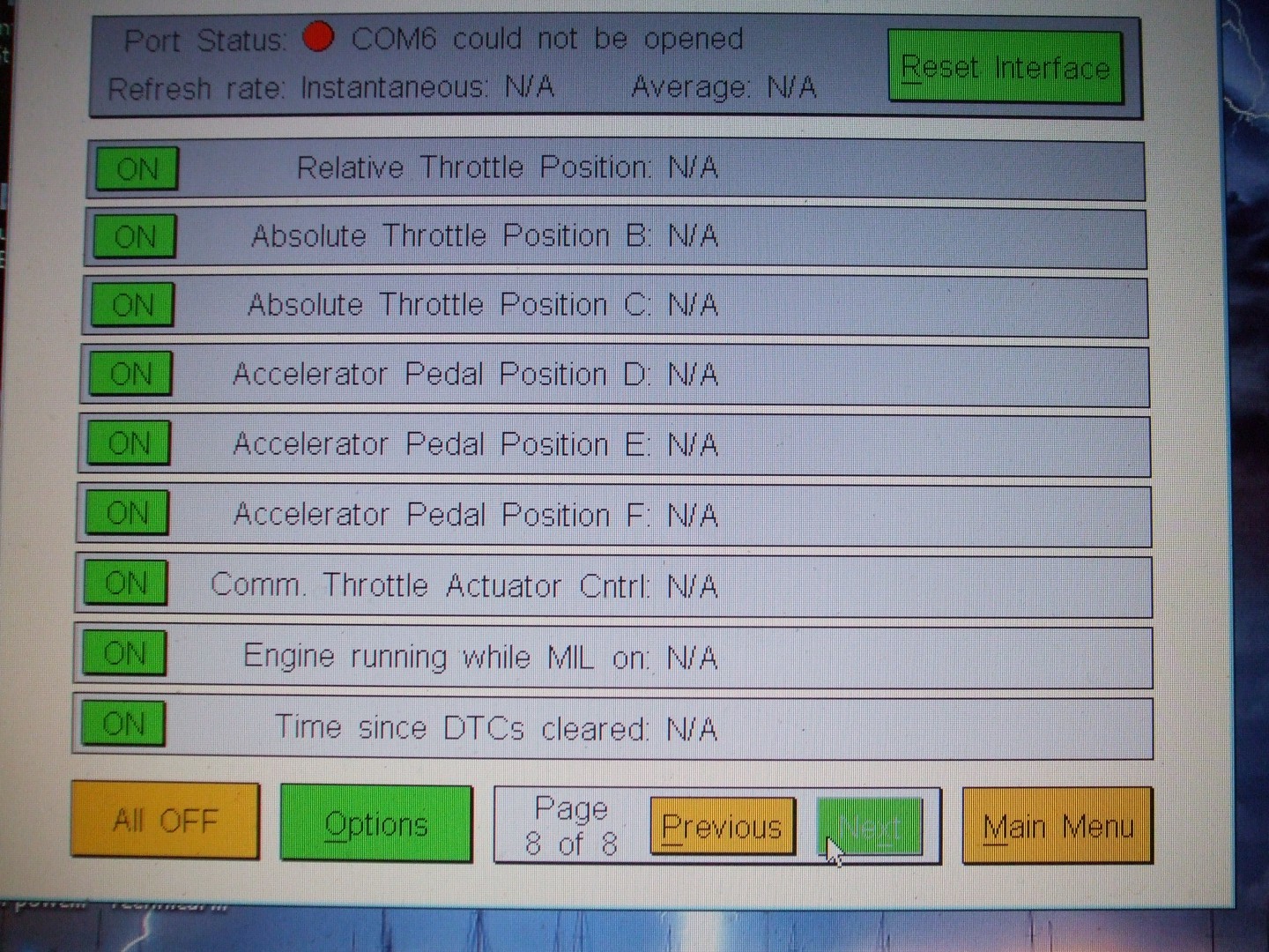

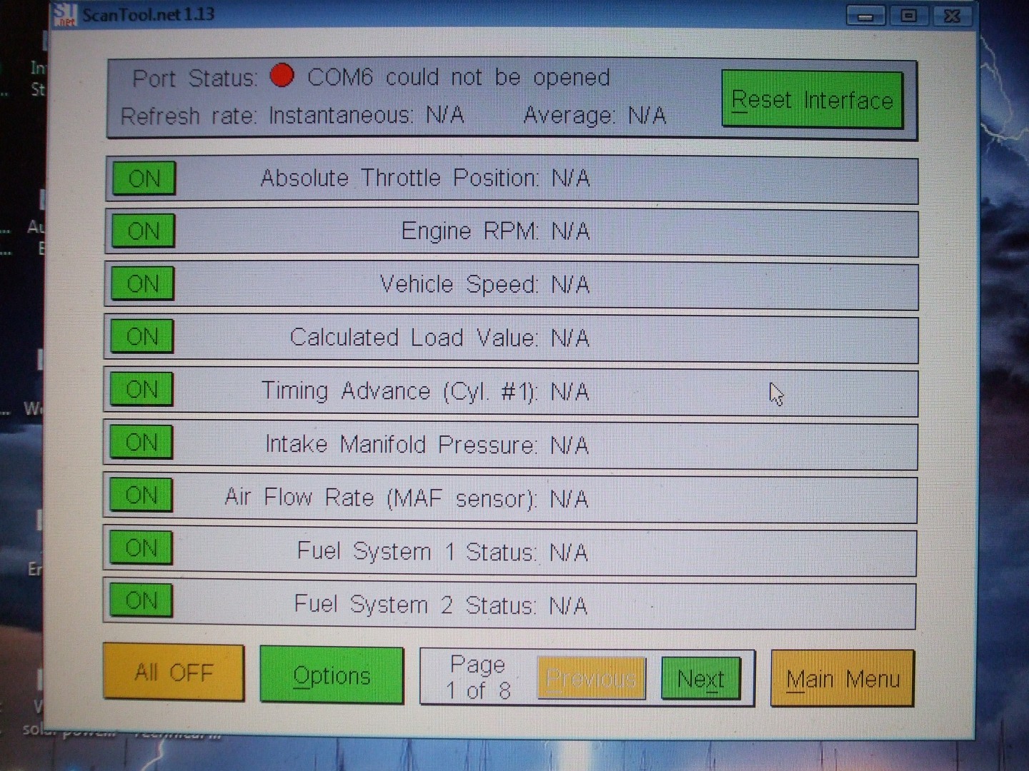

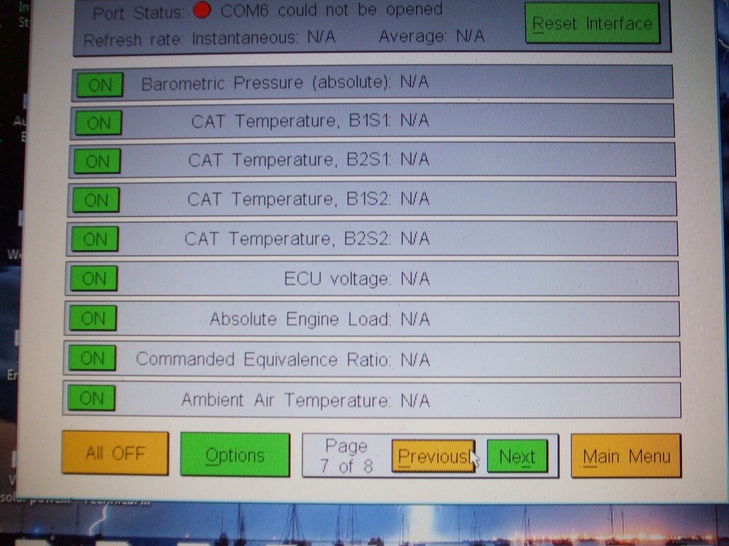

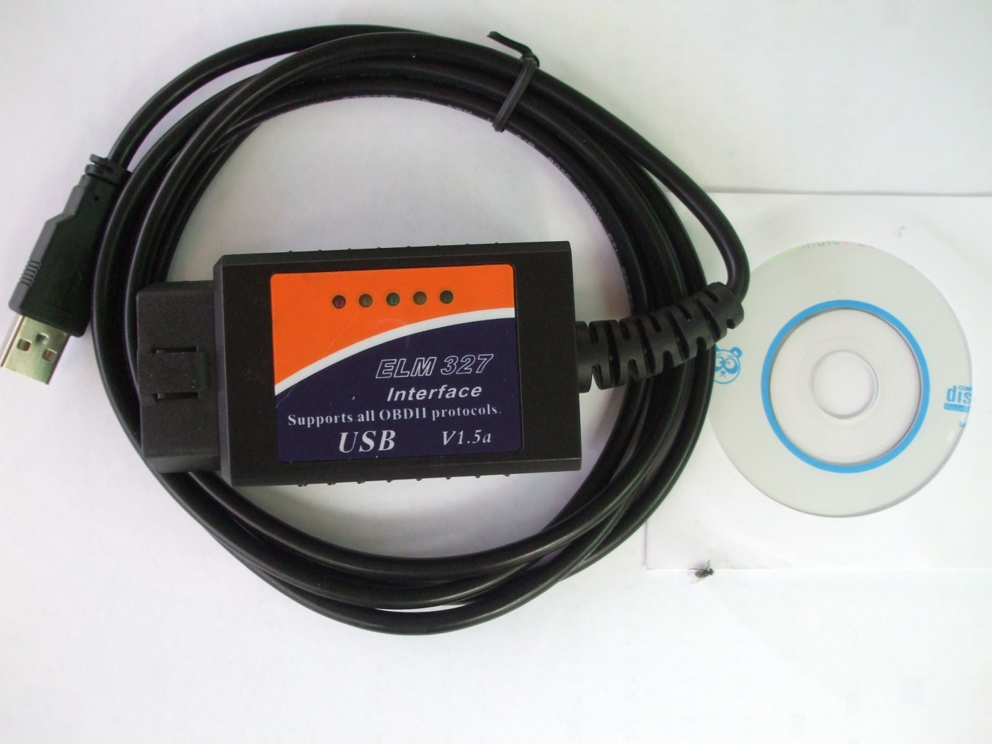

Something i got of Ebay for reading & erasing fault codes & check engine lamp. Its an interface from the OBD11 conector on all vehicles produced after 2005 to a laptop. It also shows instantaneous engine parameters. All this for $10 to$15 free postage, so it shouldnt break the bank. Ive used it sofar on BA falcons & the latest 2013 Ford Ranger CRD. There is avalable a bluetooth model for around the same price.

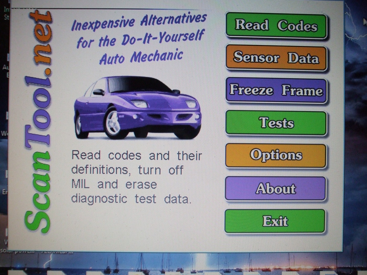

Hey DeBe, it looks like it's not communicating with you I/O port (Port Status Com 6 could not be opened) did you get any meaningful readings from it?
DeBe said
04:52 AM Apr 23, 2013
Those are only pictures i took of the program not operating. It does work as ive used it on Ba falcons & a current model Ranger. Will try taking pictures when i next use it on a vehicle. I dont own any late model vehicles. I just ocasionaly get asked to work on them as pensioners usualy cant aford to pay the high price that dealers ask to diagnose faults.

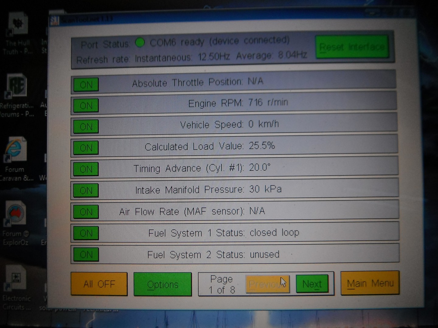

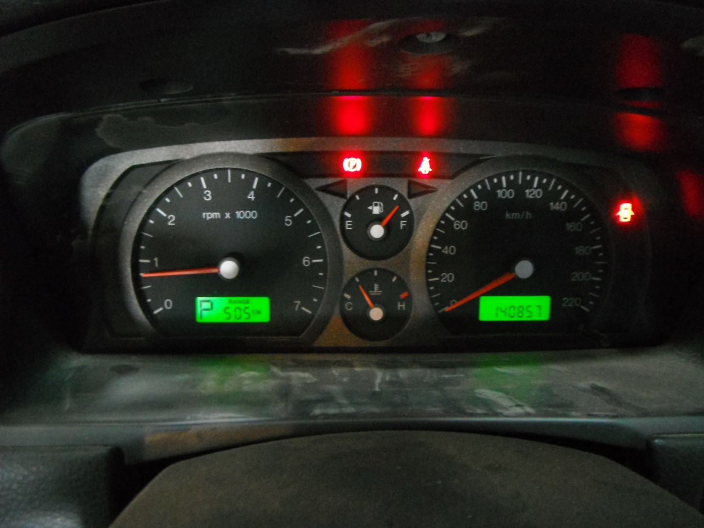

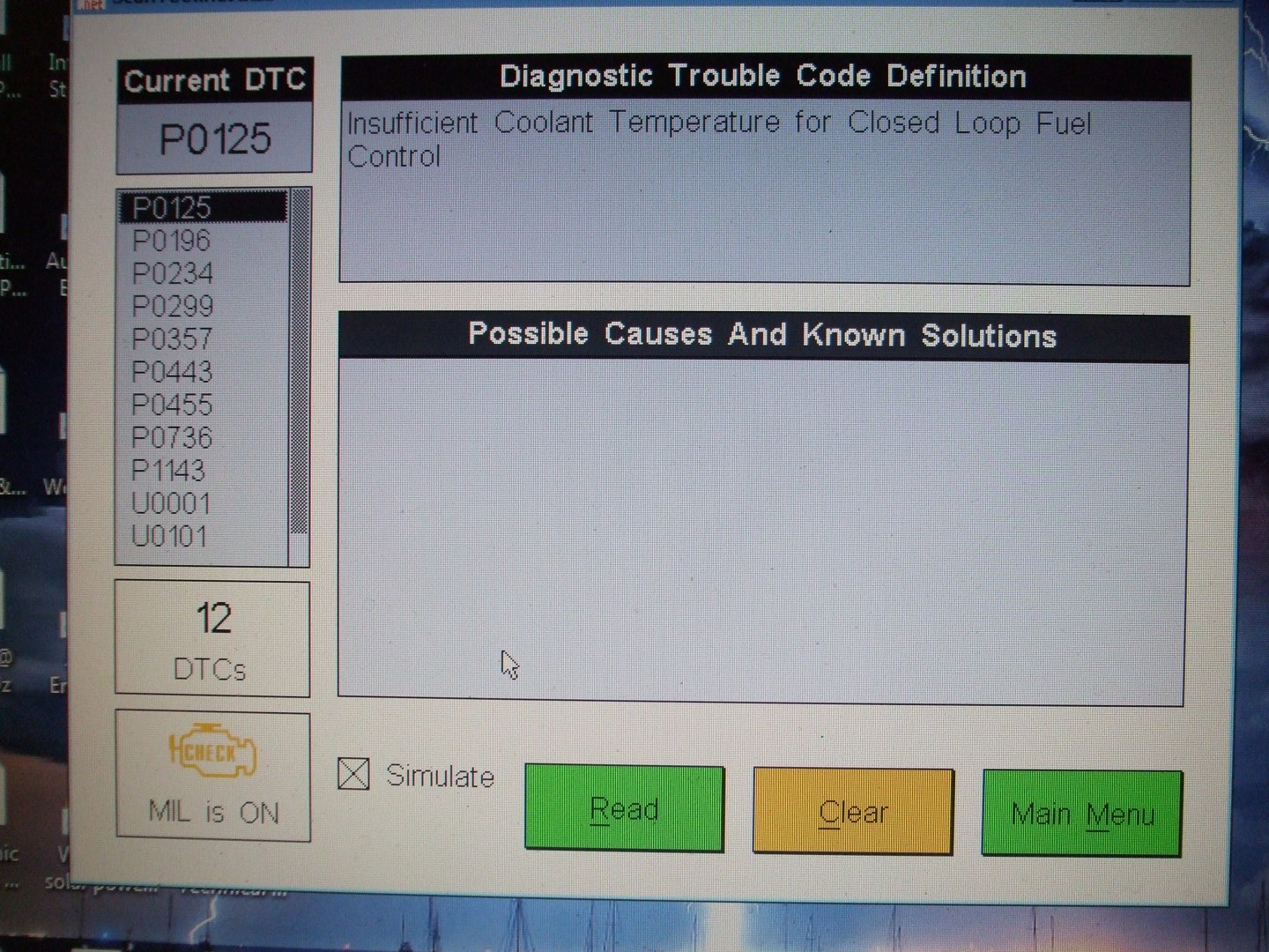

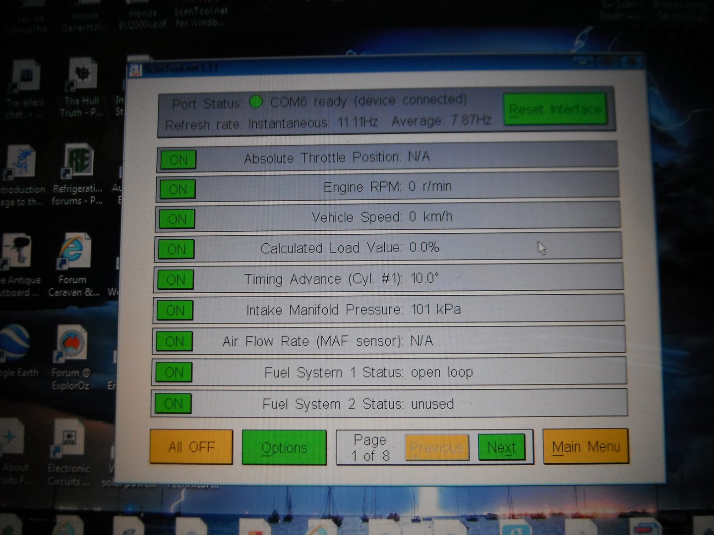

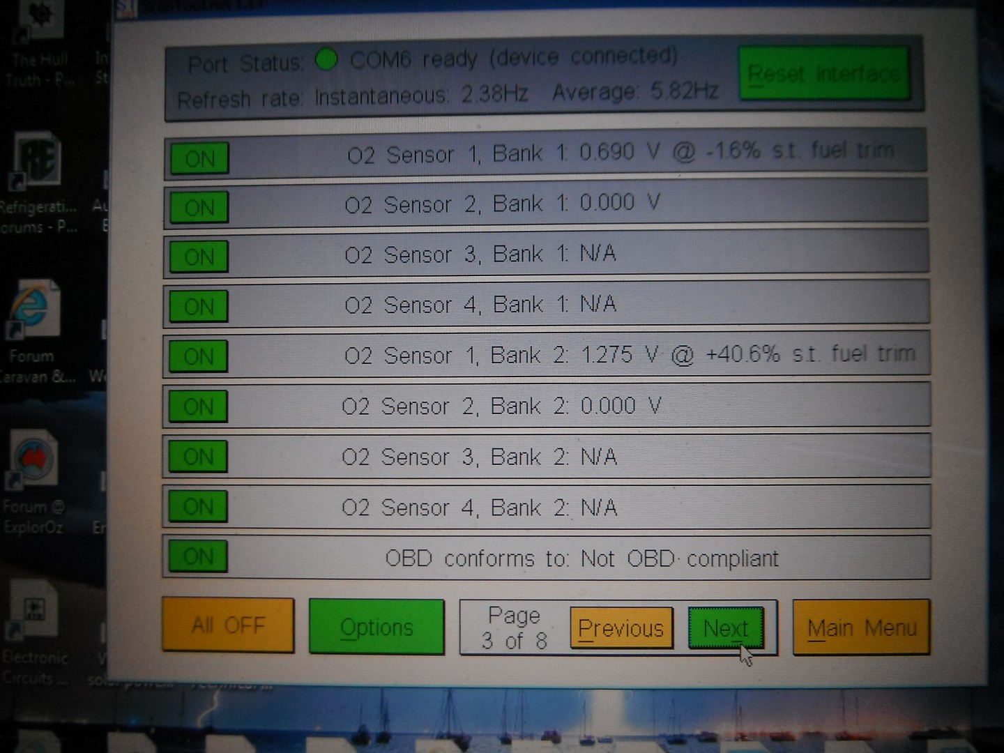

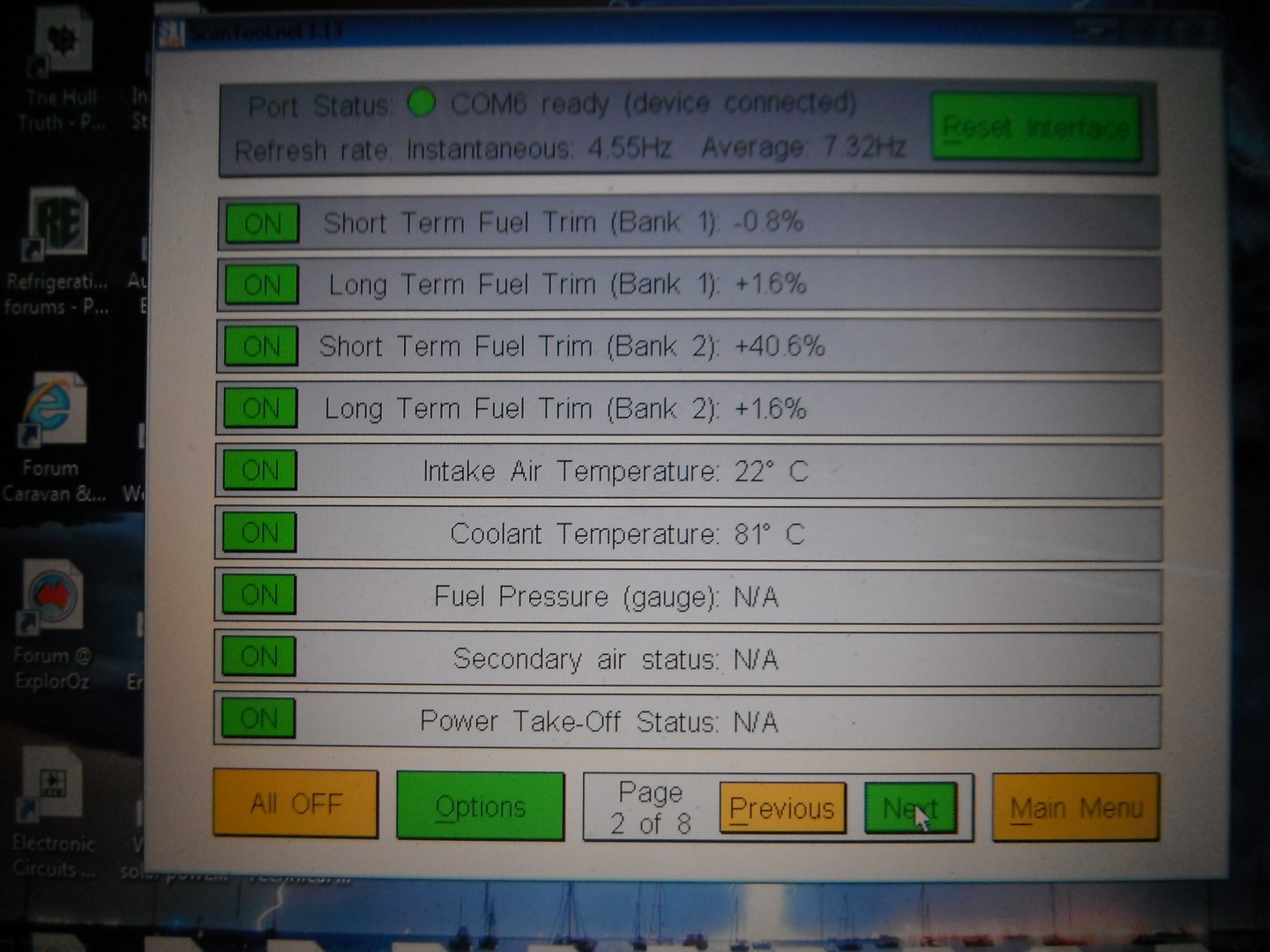

Screen pictures of a BA Falcon. First is the inst panel, 2nd is screen shot of KOEO (key on engine off), next 3 are KOER (key on engine run).

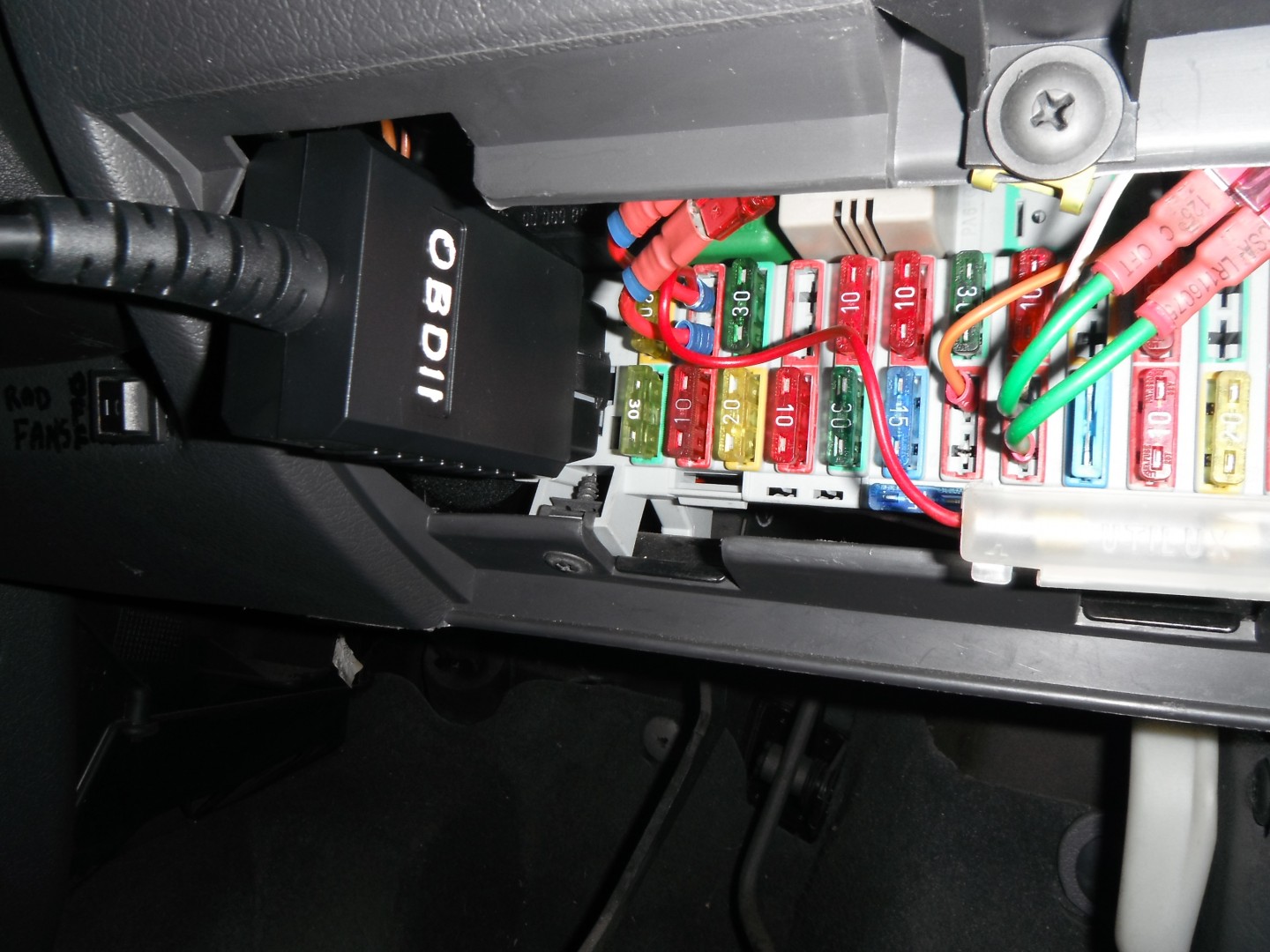

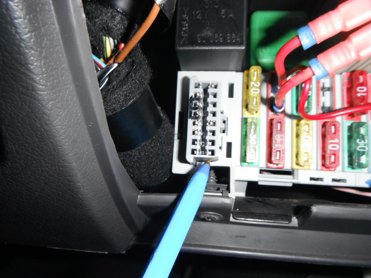

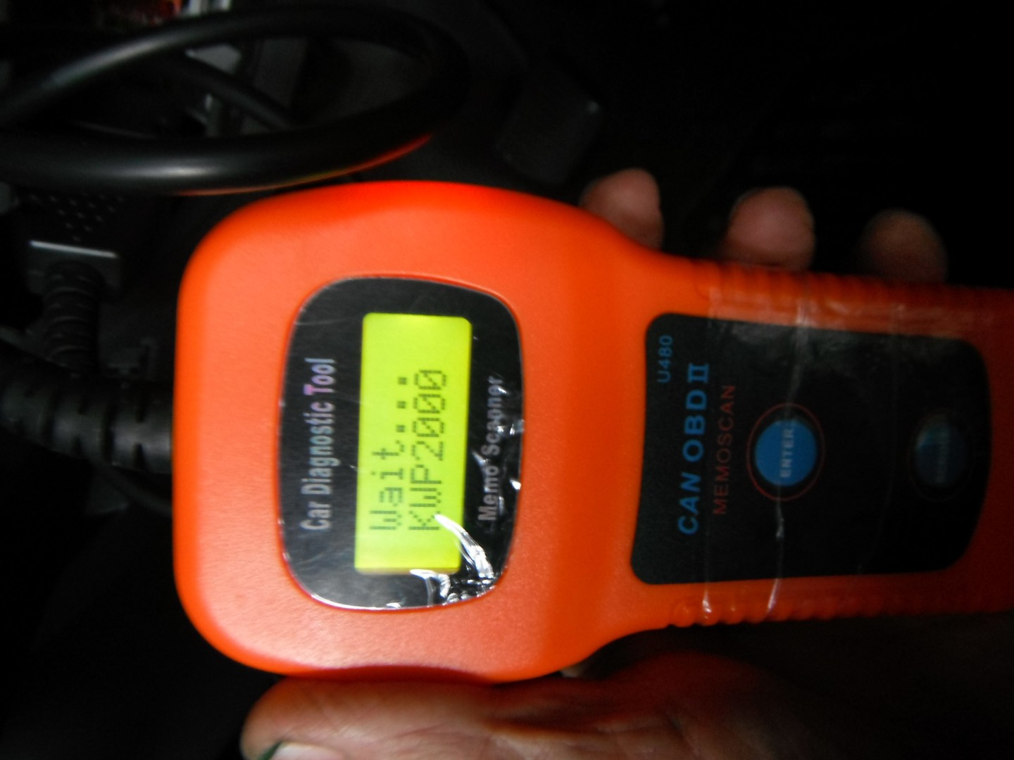

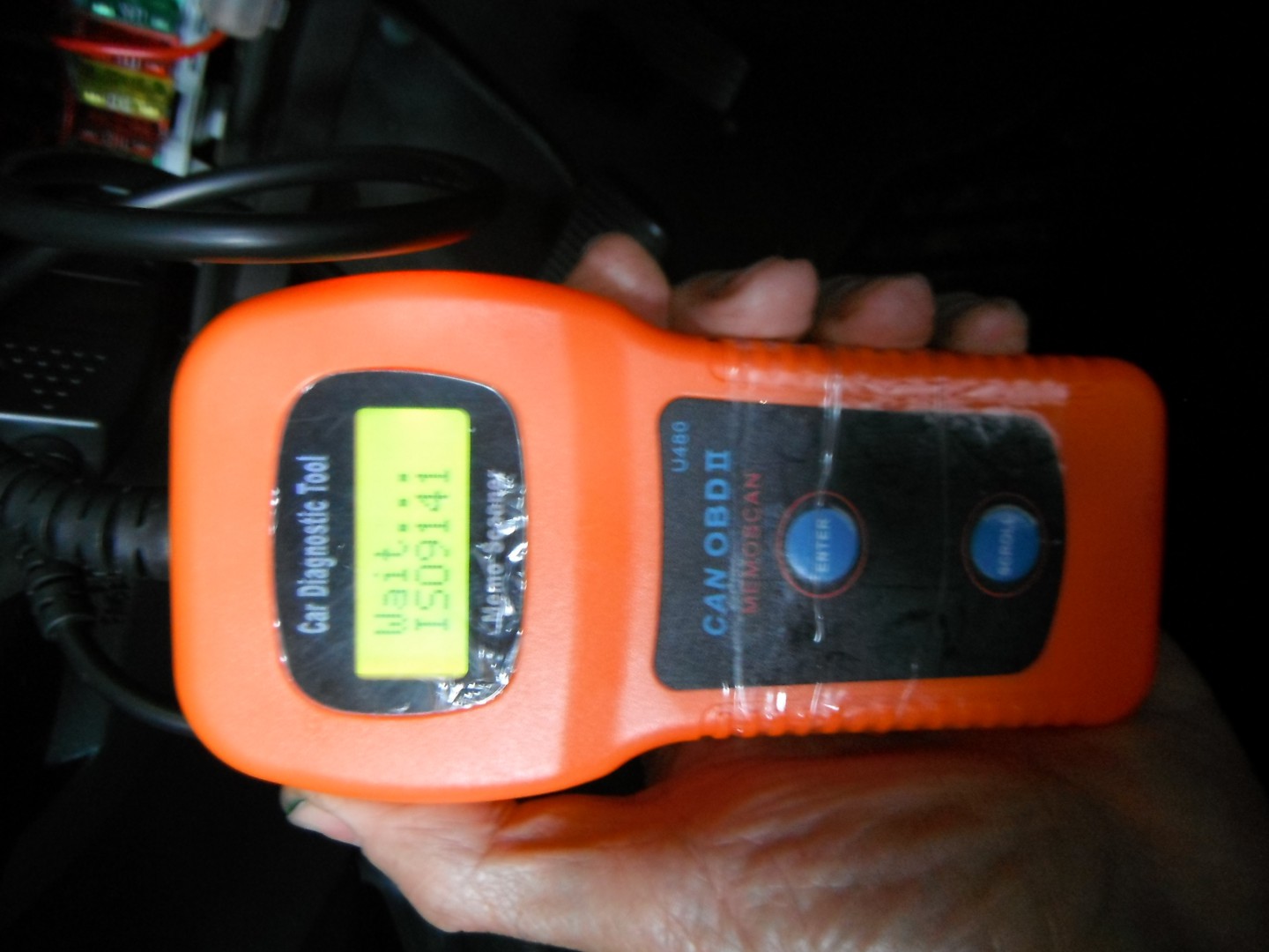

Pretty mutch every vehicle after 2000 has an OBD11 conector, but not all are compliant untill after 2005 when they all should be. The conector must be positioned with in reach of the drivers position, usualy by the fuse conectors or close by on the drivers side. The shape of the conector is in the picture. To read fault codes & erase you plug the device in & switch ign on KOEO (key on eng off). Read the codes & write them down, then work out what requires fixing, then get it fixed, then same procedure & erase codes. This particular reader also does Live data. You plug the device in & start the engine (KOER) & scroll through the pages & the sensor parameters are shown in real time. See previous pictures of a BA Falcon.
If you only want a hand held OBD11 code reader & eraser this one is a U480 from Ebay around $15 free postage. I use this more than the other one just for code reading.
