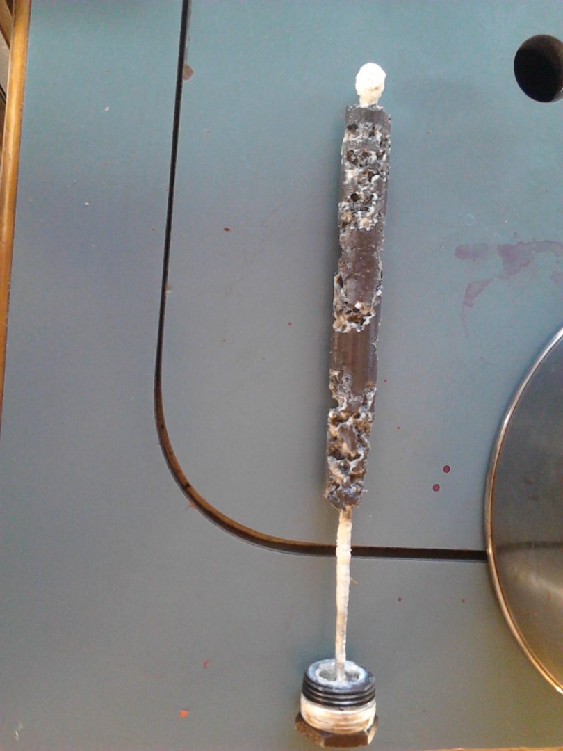

Hi everyone,
My name is Aleks and I am new to this forum. My Partner (Steven) and I are travelling around Australia in our American RV. We have a Suburban Hot Water Service and what my question is, how often should we change the anode rod whilst we are staying in Western Australia, I have heard that the water is very bad here and our hws has rusted out already and it's (4 years old). We have managed to source another from the US and was interested to know if anyone had any idea in regards to this. This would be much appreciated because when we changed (six months) it was pretty much eaten away.
And how much is too much eaten away and how much is being wasted... If you can give me an example as in picture, that would help.
Thanks for your kind help

if your anode only lasted six months the water must be terrible.
From memory the instructions say to change the anode whenever 80% by weight is gone. If you are using suspect water then you will need to check it every six months and also carry a spare. they are available at most caravan and RV dealers.

There are two types of Anodes available for Suburbans- one is a magnesium alloy for reasonable good water areas and the other is a Aluminium only which is purported to last longer in Bad/Hard Water areas. Probably not as protective against electrolysis for the tank, so definitely I would be inspecting more regularly in Bore/Hard water areas. I have replaced some in vans where only the End Plug/Nut was left even the wire gone. I have seen others where the End/Plug Nut was that seized that when they tried to remove same, have torn partial threads out and heard of another that cracked the Tank fitting off. So be Careful when unscrewing Anode, plenty of DWF/WD40 type of lubricant or similar.

Check at least every 12 months. You'll also need a 1-1/16th or 27mm socket and carry some teflon tape. Cheers, Ozjohn.

My Surburban HWS lasted 12 years before I replaced it in error .. but that's another sad story. Over that time I always used whatever water was available including in WA for several months (not Coral Bay though).
I check my sacrifical anode after every trip & certainly no less often than every 3 months.
I clean off any corrosion on the anode & use the water pressure to blow out any corrosion that may have fallen to the bottom of the tank. Then I leave the tank empty till the next trip. I screw the anode back in before leaving.
The rods are replaced when there is any significant wear .. usually it's only corroded at the end near the thread.

Here is a picture taken last week.
Dont use the HW much but it is always full of water. Last check in August 2012 when it was about 1/2 as much material on the rod. Water has varied from council to beautiful artesian bore and rain water.
I also flush out the tank after checking and repressurise and test as once forgot and was unable to get the water pressure up when on the road. I have a spare one.
