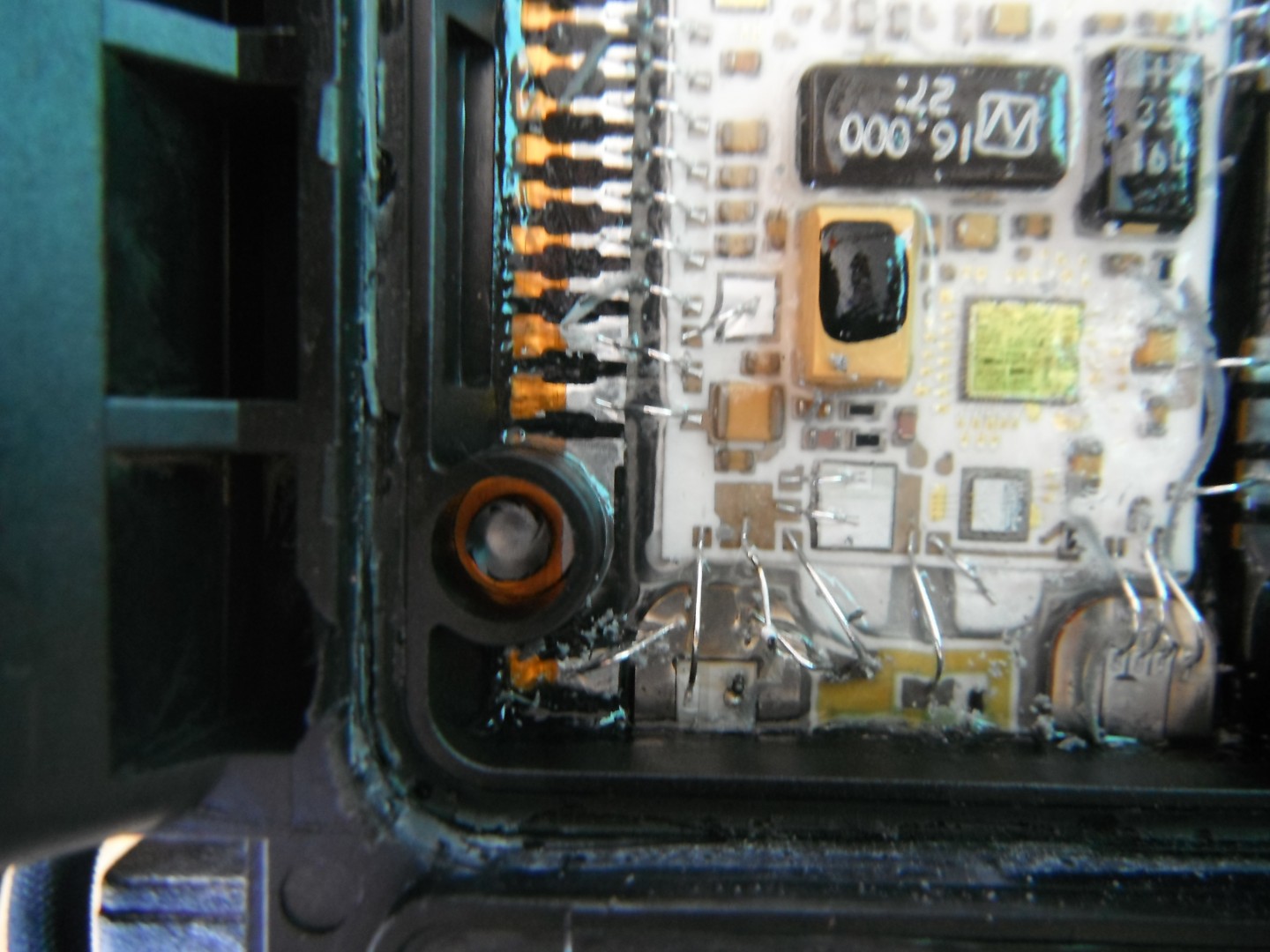

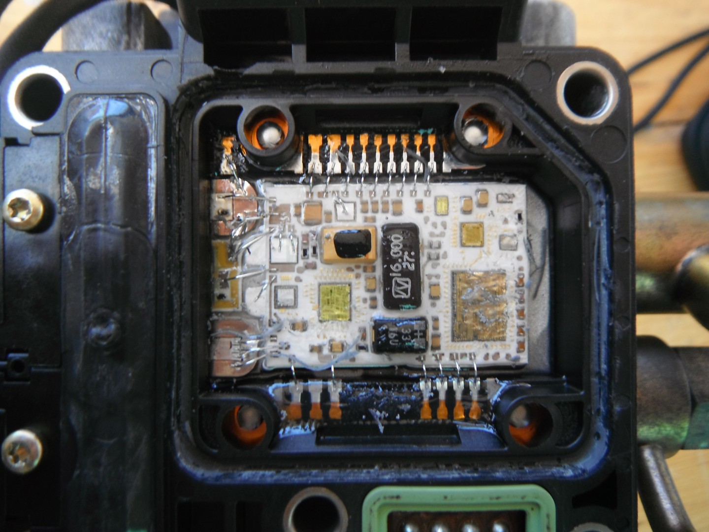

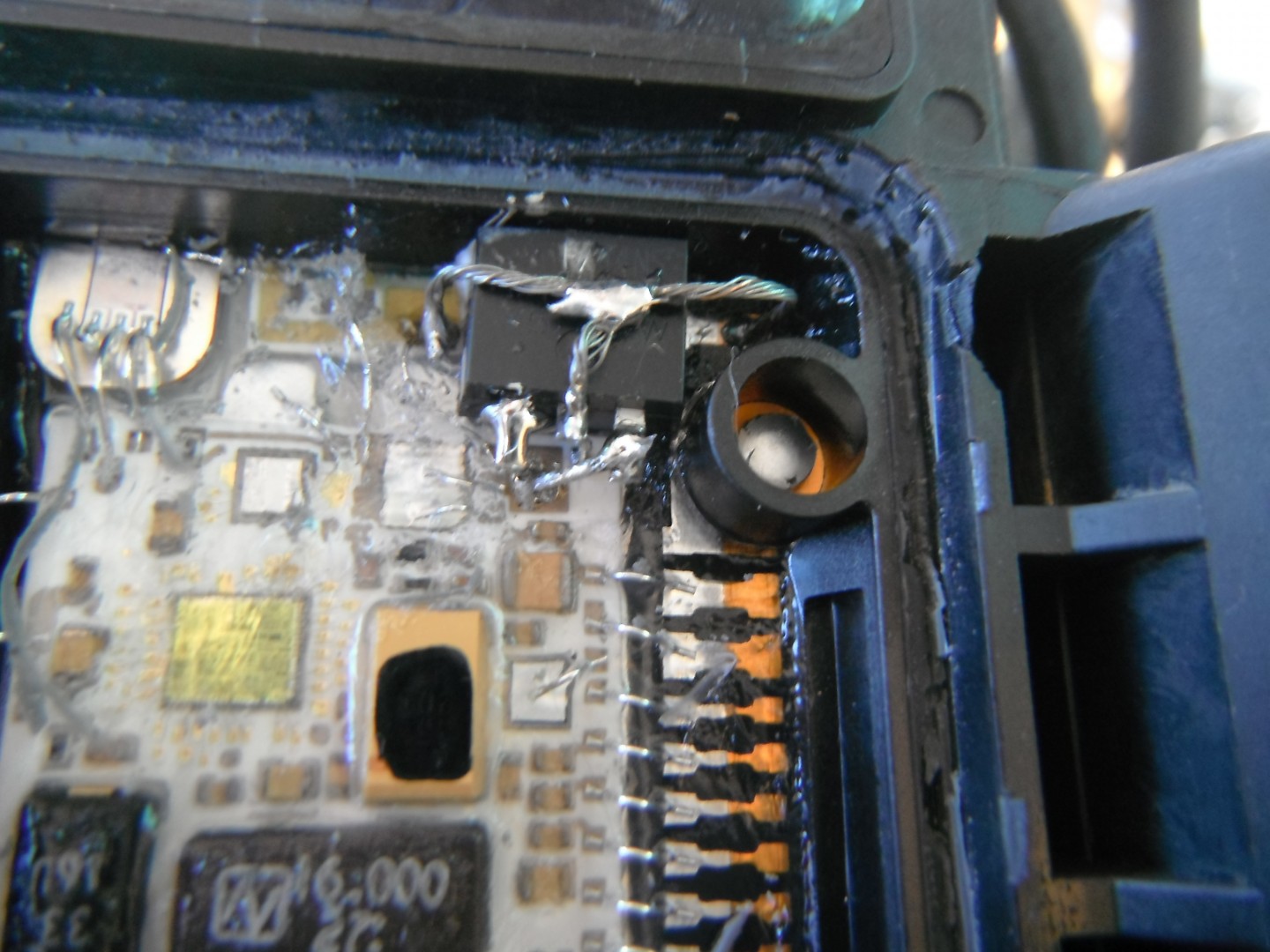

For Petengail, regarding Zextel (Bosch VP44) Injector pump & failur of spooling solenoid driver in the computer (engine wont run). Pictures of the pump i recently repaired, using IRFZ44H MOSFET & Arctic Silver (90% silver) 5min araldite to glue the MOSFET in place. 3rd pic down in the lower LH you can clearly see the aluminumn wire to the MOSFET is blown with 2 molten ends. The 4 pic top RH is the replacement MOSFET glued in place & wired up. Note these pictures were taken using Macro on the camera as every thing is quite small on the computer.

For Petengail, regarding Zextel (Bosch VP44) Injector pump & failur of spooling solenoid driver in the computer (engine wont run). Pictures of the pump i recently repaired, using IRFZ44H MOSFET & Arctic Silver (90% silver) 5min araldite to glue the MOSFET in place. 3rd pic down in the lower LH you can clearly see the aluminumn wire to the MOSFET is blown with 2 molten ends. The 4 pic top RH is the replacement MOSFET glued in place & wirede up. Note these pictures wer

How long did your repair last please?
Thinking of doing the same thing myself.
Regards Richard
Its still being used as an every day driver, so far 4yrs. After the repair it took abit to bleed the system.
