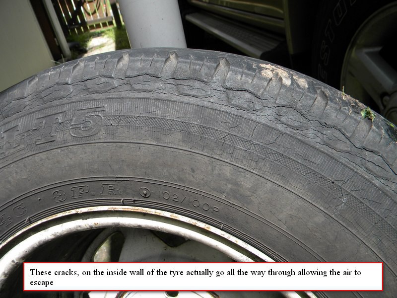

Checking over my poptop just prior to commencing a trip down south a few months ago I was happy with the condition of the wheel bearings, springs, and tyres, well the inspection of the tyres involved taking each one off and checking the tread depth and the wall condition, on both sides, somewhat surprised I was therefore to find one suddenly go flat and I couldnt find a puncture...close examination revealed that the inside sidewall had cracked completly through, fortuantly I discovered the flat when the van was safely onsite in a carvan park.....dissappointed that I didnt see the cracking before leaving home I checked the others and found them all to be faulty.

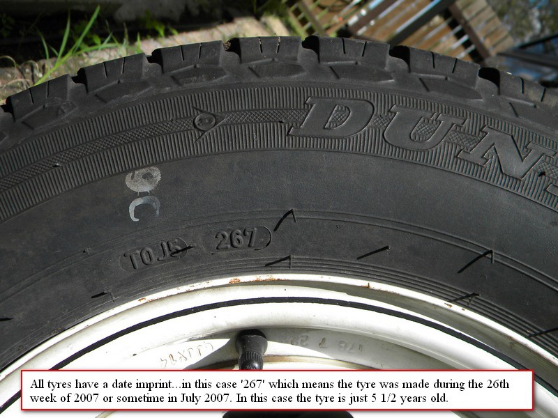

Checking the date stamp on each tyre (see photos) I note that they are not yet 6 years old!! Depending on who you talk to, tyres have a life expectancy of anywhere between 6 to eight years so I have no idea why these ones went like this....they are Australian made and the pressures have always been monitored and they have been rotated regulary. They have mostly been on bitumen too.
The moral of my story is to not be fooled by the tread depth on a tyre, look really closely at the walls, any sign of tiny cracking and the tyre is suspect, if you are unsure get a professional to have a look....a good trip can be wrecked with a blow out.

Yes!!...also Chris, I am told that exposure to sunlight can hasten the demise of rubber tyres, my tyres, including the one in my photos had sat on the spare holder without a cover so this is probably why it they had a relativly short life. One other thing, some people have writted to me telling me they unable to find a date stamp....by law, all tyres manufactured since 2000 are required to be date stamped in the method I have pointed out in my posting, prior to that different manufactures used diferent codes or none at all... So if your tyres are unstamped its probably time to spend some of the pension. Additionally most US made tyres (or 'tires' 'cos they cant spell he he) are gauranteed for just five years. More info to anyone interested here; http://www.tirerack.com/tires/tiretech/techpage.jsp?techid=11

A word of caution - tyres marked with a THREE DIGIT date of manufacture were manufactured BEFORE 2000.
Tyres manufactured AFTER 2000 have a FOUR DIGIT number -
Therefore the tyre referred by Paul and Pam on tour, shown in the photos, was actually manufactured in 1997

Thanks John....that actually makes sense...the van is a 1997 model!!....I guess I did get good use out of the tyres after all..lol.
