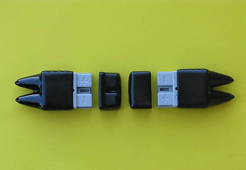

Hi Alan, I purchase some of these from a guy on eBay. They are fitted prior to installing the cable & pins into the Anderson Plug.
They look better than the ones I saw at a caravan/camping show stall.

There are no holes where the wire goes through. Just need to trim the ends to suit your wire size. ( note that these are for the 50amp Anderson) When I have fitted these I trim them so the wire is a tight fit and use talcum powder on the wire, and cover to allow the cover to slide over the wire easier. Regards Daryl
