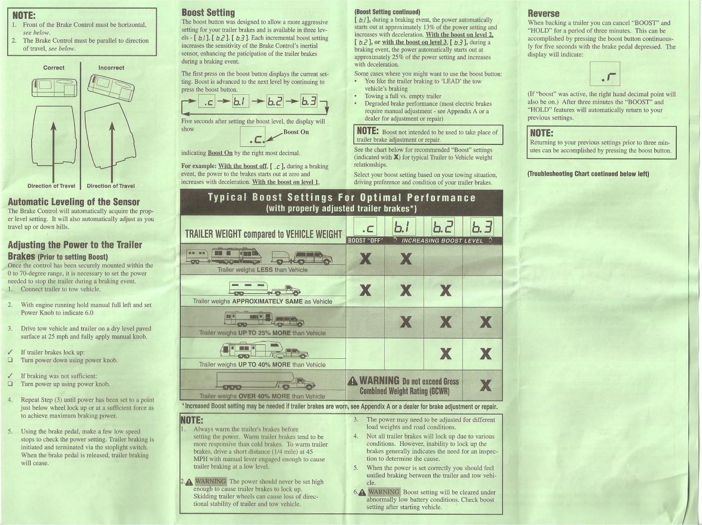

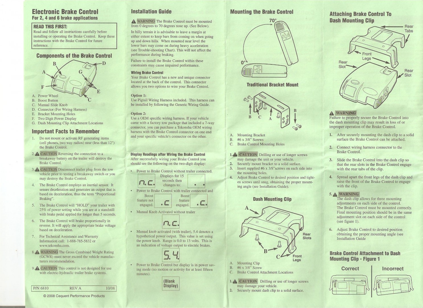

FYI: Hayman Reese Guardian IQ brake controller details.
ozi2 said
08:17 PM Feb 7, 2013
G'day guys, I have recently had a Hayman Reese electric brake installed and thought it might be of interest to post the instructions for anyone experiencing problems with their unit whilst on the road.
The model fitted and posted here is: Hayman Reese Guardian IQ electric brake controller unit, model number 5900.
If you have a different model/brand instructions could you please post in technical forum to add to the knowledge base for members.

The Hayman Reece Guardian IQ is a rebranded Tekonsha Primus IQ.
