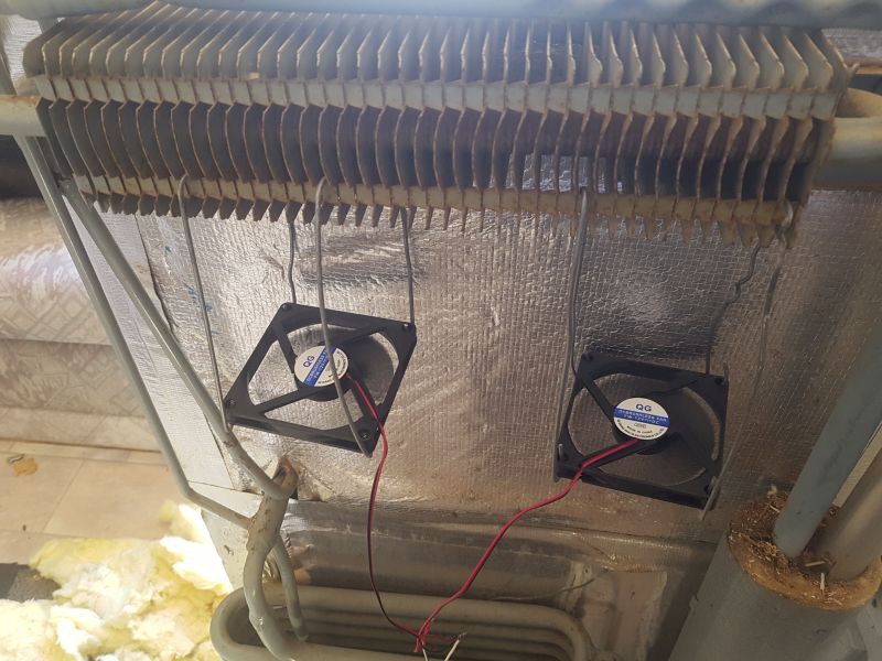

11:34 PM Mar 7, 2021
Hi. I am new to this forum. I have a 22' Jayco Deluxe Tourer caravan. Bought it in June 2020 during winter and fridge worked well. The fridge is a three way Electrolux RM2510. Experienced my first issue last September 2020 when fridge not cooling efficiently as freezer only got cold but didn't reach freezing point. On a warm summer's day (39C) it was just barely cool in the freezer compartment. So I reverted to seeing what others did to try and remedy this. February 2020: I pulled the fridge out and stood it on its head, gave it a shake and left it like that overnight. Next day I turned it upright, let it settle for an hour and left it from its compartment. Then turned it on using 240v. It got very cold but not freezing. Stuffed around with this routine the next day. Same result. Finally moved it almost all the way back into its compartment bar about 4" to allow the breeze to rush through the condenser. Bingo! 2 hours later she was freezing up. So I finally deduced it needed a decent air flow coming through the condenser.
This air flow was not going to happen in its usual fixed position. So I purchased two 12 volt computer fans on ebay. Cost about $4 each. I suspended them from hanging wires so that they lay about 4" under the condenser(see attached pic) and then connected them to my 12 volt system via switch and fuse. Pushed the fridge back into its compartment and turned it on..but not the fans. Outside temperature was about 34C. The fridge got cold but didn't freeze after 5 hours operation on 240 volt. Then I switched on the fans. Checked the fridge 3 hours later and found freezer compartment had made ice blocks and fridge was down to 6c. 2 hours later it was down to 4.5C. Hope this helps.
