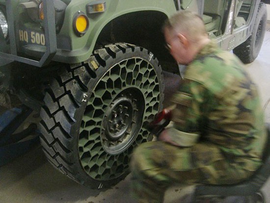

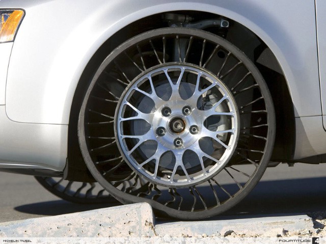

Maybe a set of these will save all the problems.
