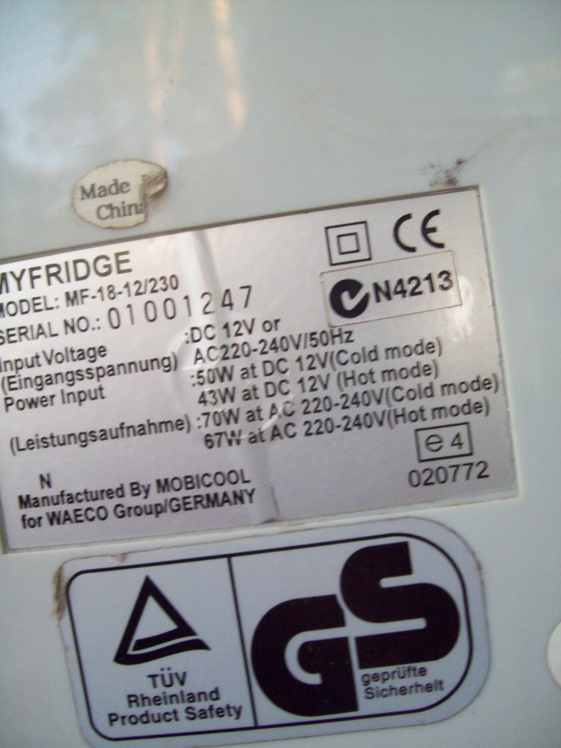

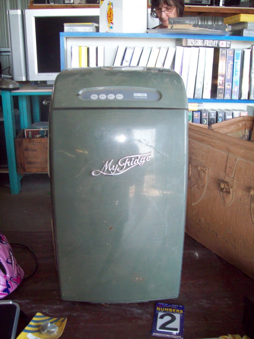

Has any-one ever used one of these ? Waeco MyFridge. 240/12 V.

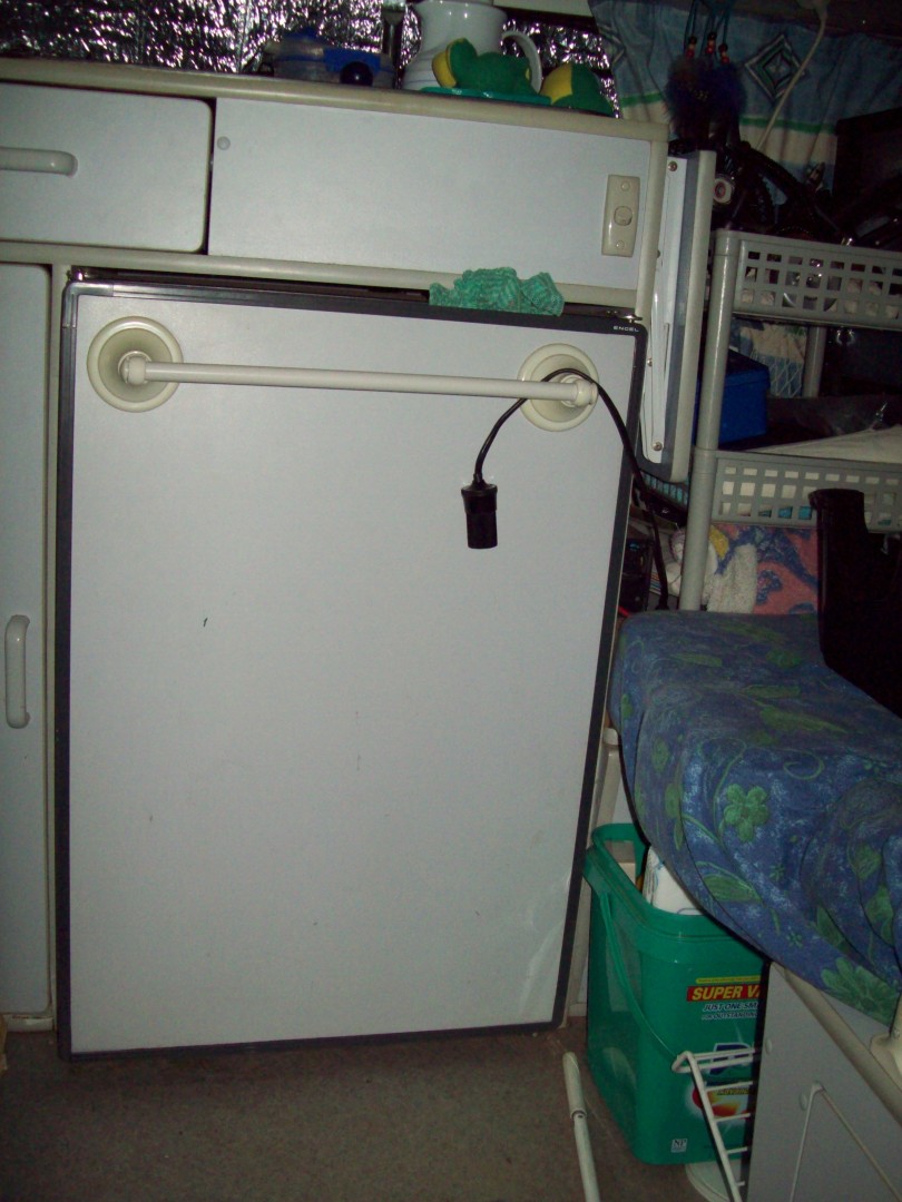

Are you telling me that that will use more power than the Engel fridge shown here ?

Have to find a 12V lead for it yet. If it wasn't suitable for running off a Battery, then why 12 V ? Doesn't make sense to me.
Don't want to use it on 240 V.
Just wondered if any-one here had one, or knew about them. The only info. I can find on the Net, is in either German, or Russian etc.
It is suitable for running off 12v in the car while the engine is running eg when plugged into a cigarette lighter socket. PeterD however is quite right in that it is not suitable for more general use on 12v in the same sense that a compressor type fridge is.
Before I bought the Goldstream I used a tent-trailer for camping and used a "Bushman" in the back of the wagon for my general refrigeration. I found a Waeco cooler (Peltier type) useful for storing fruit and vegs that are not temperature critical. Sometimes I used it "in reverse" to keep food hot.
So can I plug it into [if and when I get the lead] the house battery ?
Yes you can plug it into any 12 V supply. However just remember that it will be very demanding on power from your battery. It will draw a little over 4 A continuously, that will be equivalent to connecting 2 compressor fridges to your battery.
You have a valuable piece of equipment there but it is not usable like a compressor fridge. Use it more like an Esky. Cool it down for an hour or so before you travel and keep it on an ignition switched supply in your tug whilst travelling. It is very handy as a cool box for picnics or shopping where you have an hour or two return from the shops. If you want to use it that way then it will be worth chasing up a lead for it. It is also useful as a hot box if you want to transport cooked meals and keep them hot. You just reverse the plug into the unit and the Peltier junctions heat the box.
