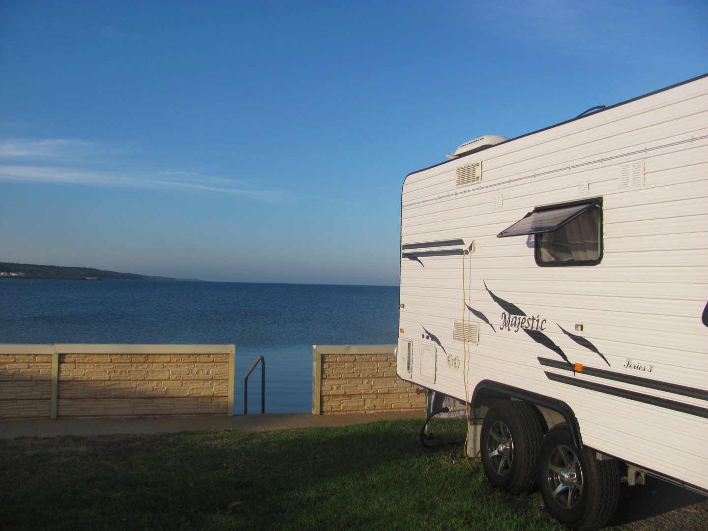

Nomad246,
We had a "mushroom" vent fitted on roof above our RM4601.
Have not had a problem with inside temp, setting on 2.5 permanently.
42 degrees yesterday and didn't have to alter thermostat setting.

Why is that top side vent there for? Yours is the first installation I have seen like that. None of the Winebago installations with the roof vent have that top side one. My bet is that it would impede the draft that would normally be drawn by the top vent on its own rather than assist it. Have a look in your fridge handbook and see what the minimum height the top vent has to be above the fridge. If any of that side vent is lower then it certainly would be messing up the draft the warm cavity would be producing. Check with Dometic to verify my observations.
Winebago has been using those top vents for a few years now. The only time they don't seem to use them is when there is a window above the fridge. It's about time the van manufacturers started fitting them. They are much more effective than the side venting. When the flue cavity above the fridge heats up they draw like a mustard poultice.
-- Edited by PeterD on Saturday 8th of December 2012 11:45:07 PM
Thanks for that Leevin,
I believe I've seen those on other units, but never taken the time to understand what they were for.
Our van doesn't allow for the roof vent to be added like you have, and our top side vent is lower on the wall. Haven't had a problem yet with the fridge but it will happen when you least want it to.

PeterD,
Fitted in agreement/consultation with Dometic, caravan manufacturer and refrigeration engineers.
The "mushroom vent" speeds the flow of air, apparently much more efficiently than an extra fan!
External upper vent, no problem, the more the merrier.
No need for running 12/240v fans. The less moving parts, the better I say.
I have not moved the thermostat setting from 2.5 since leaving Brisneyland.
We are now in Streaky Bay, and it is warm.
I still have two trays of ice cubes in a full freezer.
I recommend the fitting of a mushroom vent above the fridge.
My personal thoughts.
