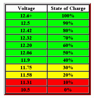

Using say a multi-meter or plug in cigarette type 12V starter/crank battery reader, is the link shown below a good indication of the state of the battery;
Hopefully a chart will be attached to this post (I'm new here so hope it works). It's a chart for standard voltage at 20 deg C and battery left standing for 5 hours at least.
Close to yours in most respects: ie within about 0.3 volts except lower range and 0 volts.
Do readings vary with deep cycle 12V batteries or are the readings the same?

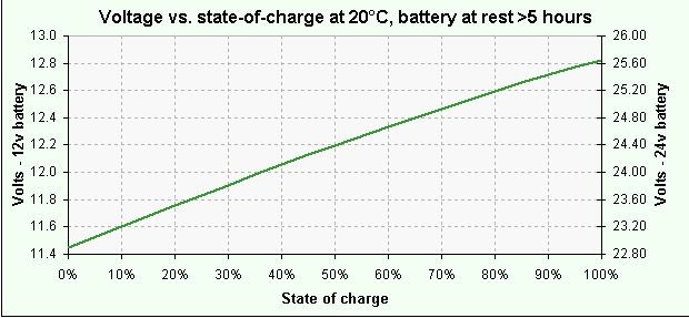

The tables give a GUIDE to % of battery capacity
But that battery capacity decreases with age
An OLD 100Ahrs deep cycle or a 100A cca battery could only have 20% of it's ORIGINAL capacity available
But that can still be fully charged & give the volt readings as indicated in the tables for SOC
That will be reasonably correct % of the REDUCED capacity
20% of 20Ahrs or 20% of 20CCA
In addition the readings at all times are best taken when the battery has been at rest [no charge oe discharge for at least several hours
Note even a 0.2v error in the volt reading is significant when using voltage as a SOC indicator

I think they are close, but not really 100% sure, maybe someone else can with more technical expertise can help.
From my experience a 12 V wet cell is technically "flat" at about 12.3 - 12.2 V ( shouldn't go down to 12 V or battery life is reduced), whilst a deep cycle is technically flat at 50% of its capacity.
I take my caravan batteries (4X100AH deep cycle) to 12V regularly which shows about 40% capacity remaining. We were on the road full time for 3 years and now batteries are just over 5 1/2 years old. One failed at about 2 years but it must have ben a dud.
http://www.marxrv.com/12volt/voltchart1.gif
Cheers Baz
Thanks Baz,
Hi
-- Edited by oldtrack123 on Friday 9th of November 2012 10:32:04 AM
Hi Duh
What application is your battery used for, as modern chargers help to keep batteries fully charged BUT a car alternator for example generally only charges a battery to about 70% of its capacity. So you can see that modern multi stage chargers/solar chargers and regulators are far better than a simple charge from a car alternator.
Hope this helps.
Cheers Baz
