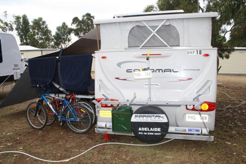

I made my own bike rack after trying 3 different bought types They sit above the spare whee; on a coromal 511 I did however weld extra 50mm supports for the rear bumper The rack i eventully made is similar to one that looks like a motor bike rack where the bikes sit on it rather than suspended They are attached via both wheels supported on carriers then attached at the crossbars to keep them vertical The rack is removable and is simply attached via an upright tube from the spare wheel carrier
So far so good

snapper49 said
06:42 AM Oct 10, 2012
here it is will email you the pic so you can zoom in and have a good look at it
I can't see how the weight of a couple of pushbikes on the rear bumper would be a problem. I've seen rear bumpers carrying generators, motor scooters, outboard motors, fold-up boat trailers, full jerry cans, etc, all much heavier than a couple of treadlies.
