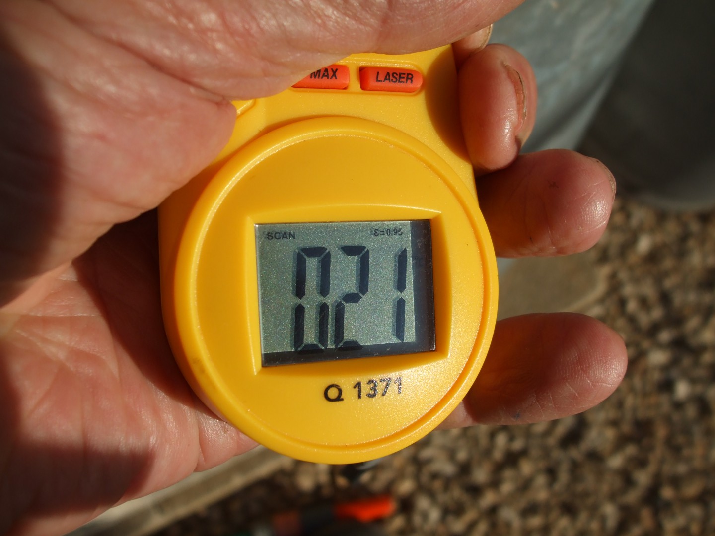

Hi Jules, Its an Infrared surface temperature sensor, I purchased from Dicksmith Electronics, there are cheeper ones on Ebay. I use it alot on refrigeration jobs & Mechanicing jobs. To check the gas liquid level just hold the read button down, & slowly go down the side of the cylinder until you see a temp change. That is where the liquid level is. Also use it to check for hot wheel bearings on the Van.

Hot water works - but DeBe how does this thing work?
